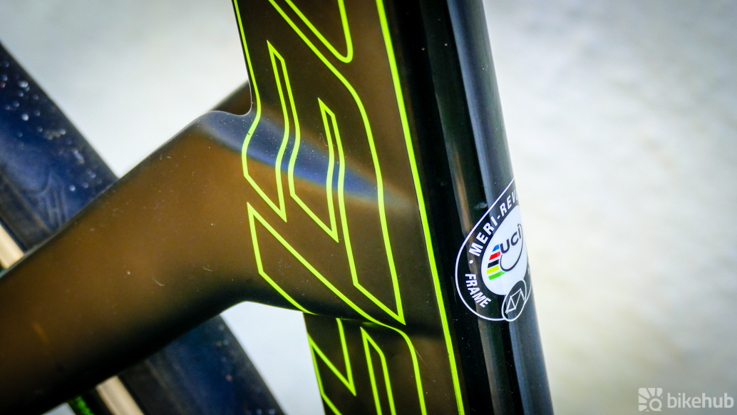

Merida have clearly poured development time and some good thinking into the design of the Reacto frame. All the tubes have been shaped to maximise airflow efficiency. The tear dropped profiles follow NACA (National Advisory Committee for Aeronautics) Fastback design principles to ensure the aero effect is real. The rear or “tail” of the tube profile is D-Shaped in an effort to keep the airflow stable without causing turbulence and to keep the tube dimensions UCI compliant.

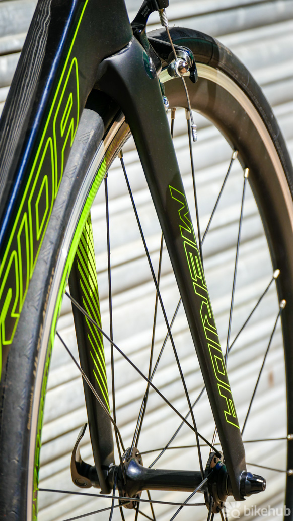

Further aerodynamic gains are achieved by joining the seatstays lower down on the seat tube. This reduces the size of the frontal area and with the stays positioned wide, they stay clear of the rear wheel to help manage the airflow and turbulence in that area. The carbon fork’s legs are widely spaced for the same reason, with the crown integrated into the frame. The head tube has a bit of an odd shape from some angles, but by looking at all the other design touches, I have no doubt that the size and profile plays it’s part in the bike’s low drag.

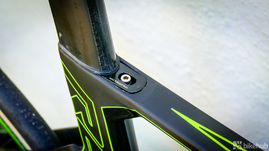

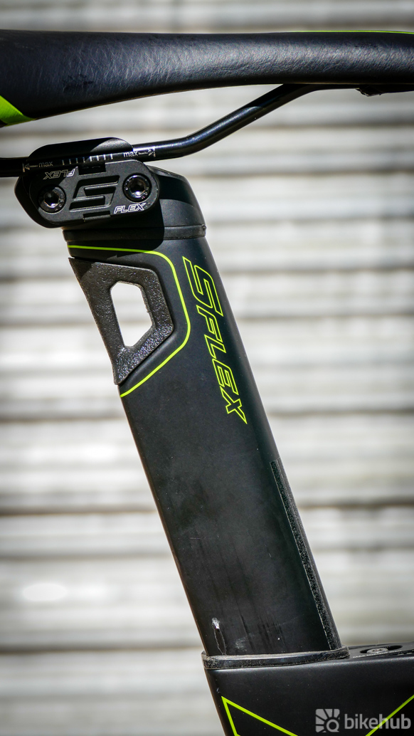

The Reacto comes with an internal seatpost clamp that is placed inside the top tube and works fastens with an expanding wedge. The carbon seatpost is also tear drop shaped with its own clever design touches. The S-Flex seatpost, as Merida calls it, features a cut out near the top with an elastomer fitted to allow some flex and add comfort to the ride. The S-Flex seatpost comes standard with a reversible head and integrated bracket for a Di2 battery. The reversible head will allow you to setup the bike in an aggressive position over the pedals, if you’d like to use the Reacto for time trials.

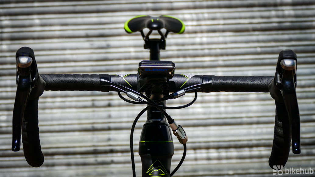

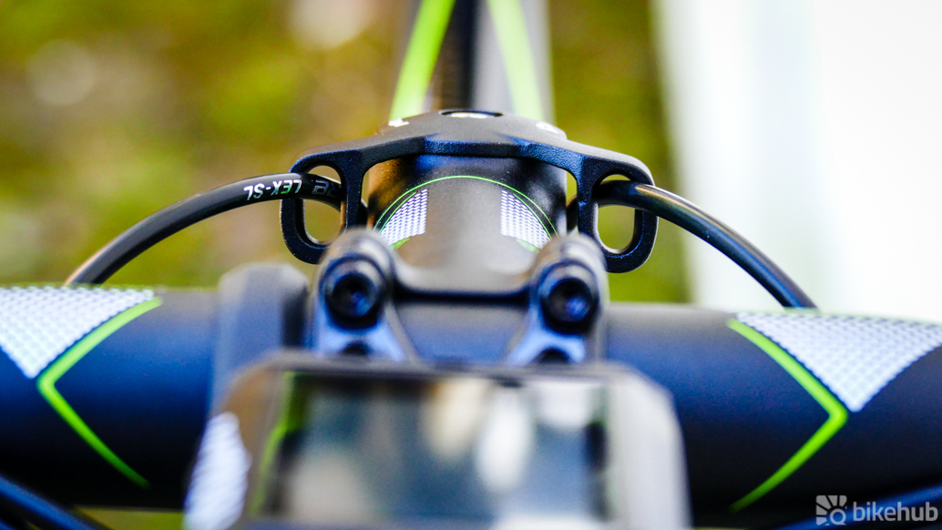

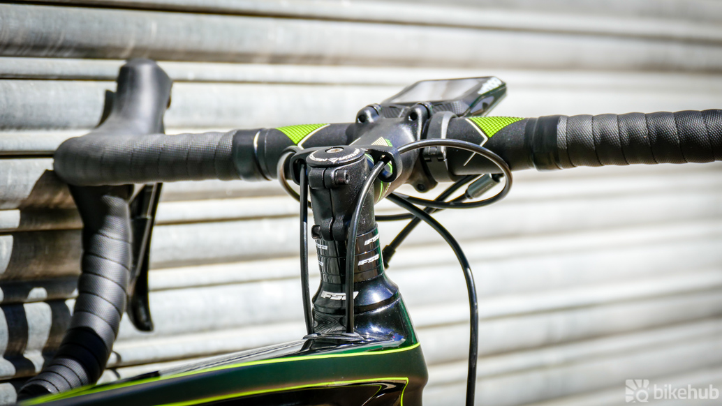

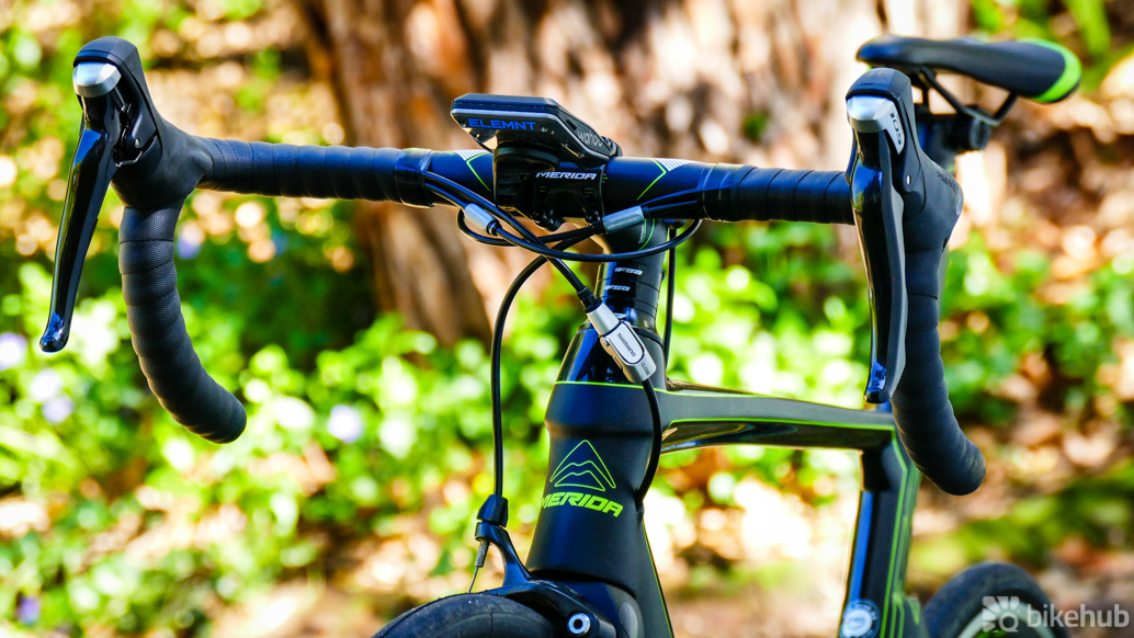

It is no use having tubes that slip through the air when other components and cables are undoing all the good work. With that in mind, the cables are routed internally, entering the frame at the top tube just behind the stem. As this is already “dirty air” the exposure of the cable up to this point will have little impact on drag. The front and rear brakes are direct mount with the front brake in a conventional position rather than tucked away behind the fork, as preferred by many other aero bikes. According to Merida, the difference in drag is minimal. The rear brake, however, is hidden behind the bottom bracket. Going this route has allowed Merida to do away with the seatstay bridge in an effort to keep the bike clean in that area, and in doing so further improving the Reacto’s aerodynamic efficiency.

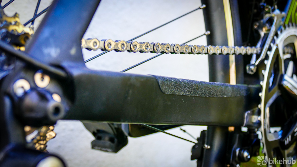

Furthermore, the Reacto includes an inline quick release for the direct-mount caliper, barrel adjusters for the the front and rear, a stem top cap with integrated cable guides, chainstay protection, and a chain catcher as standard.

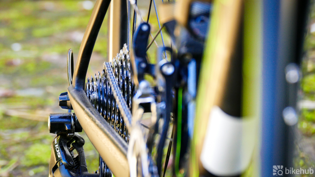

The Reacto 4000 comes with 52/36 tooth chainrings which helps on longer, steeper climbs. The Shimano 105 groupset performed flawlessly, with the only kink being the rear brake that could do with a bit more oomph. In wet conditions, initial braking felt a bit more gritty thanks to more dirt collecting on the pads and it would be interesting to see the effect this will have on running a carbon rim brake wheelset over a full season. The top end model and the official Merida team riders do ride carbon wheels so I’m sure it has been tested to its max and found to be a non-issue.

  • Integrated seat clamp can be fiddly to adjust
