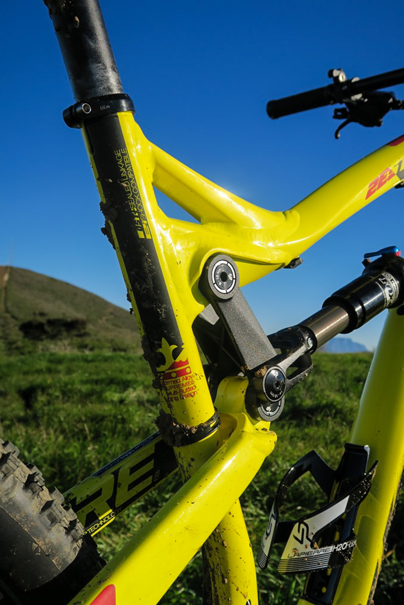

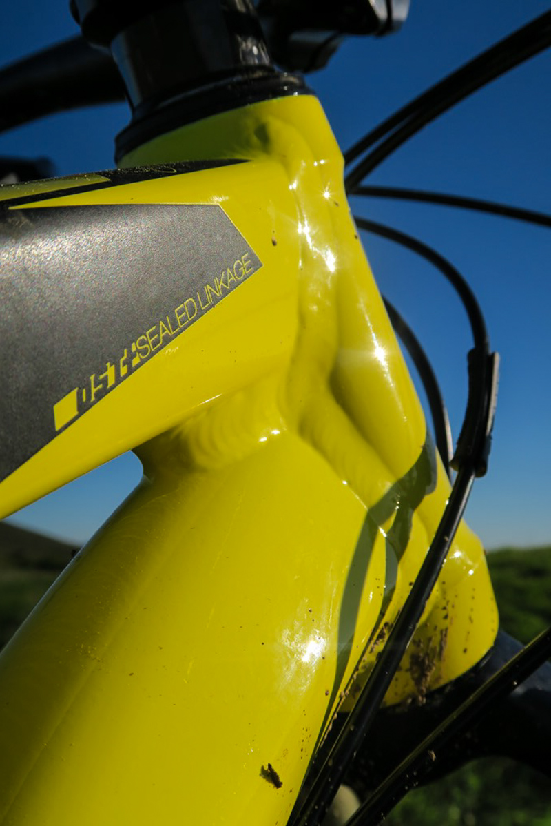

The Zesty AM we tested had Lapierre’s OST+ (Optimized Suspension Technology), Horst-link suspension design. First launched in 2008 with input from Nicolas Vouilloz, the design centres around a virtual pivot point system and is said to eliminate pedal bob while remaining fully active over bumps.

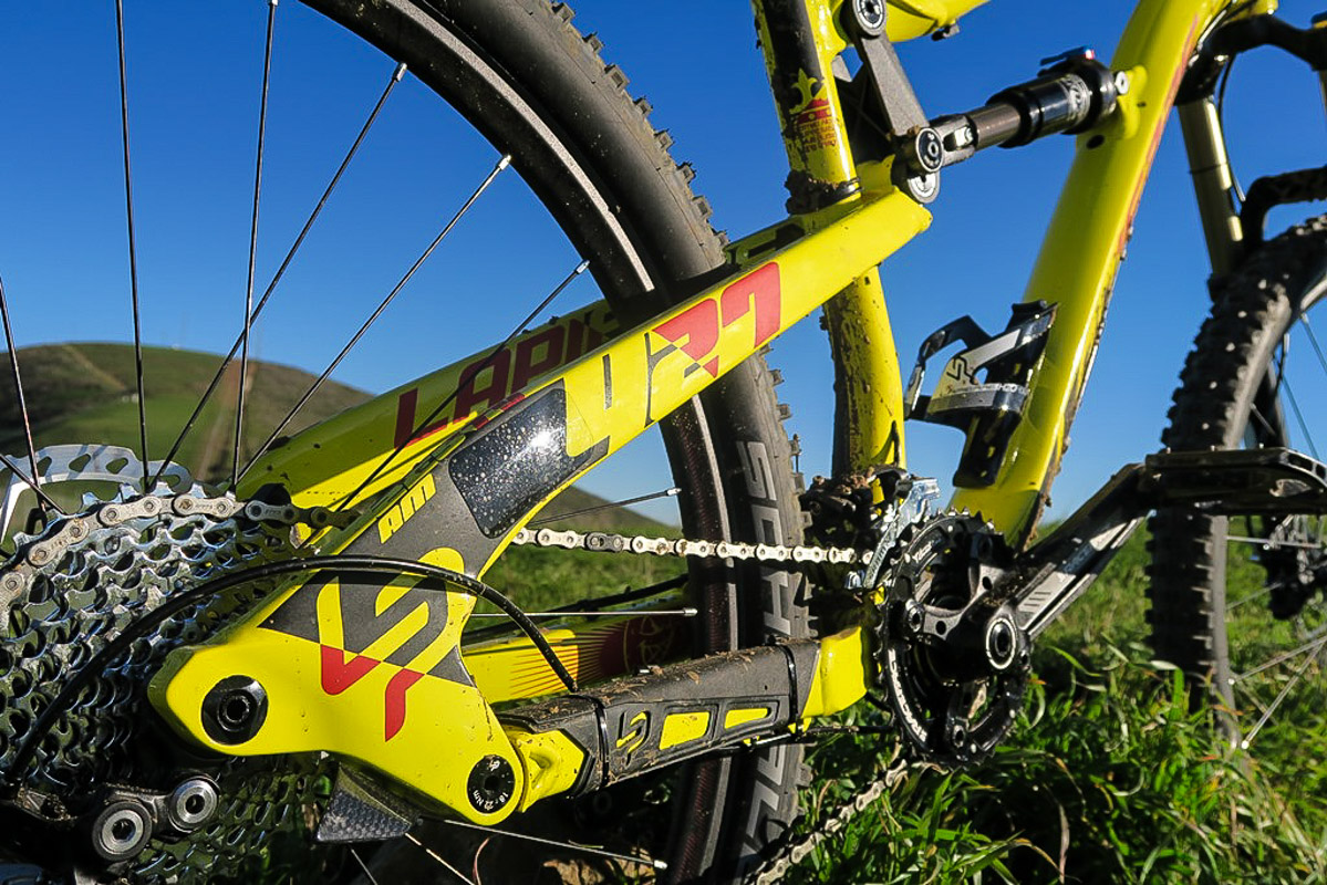

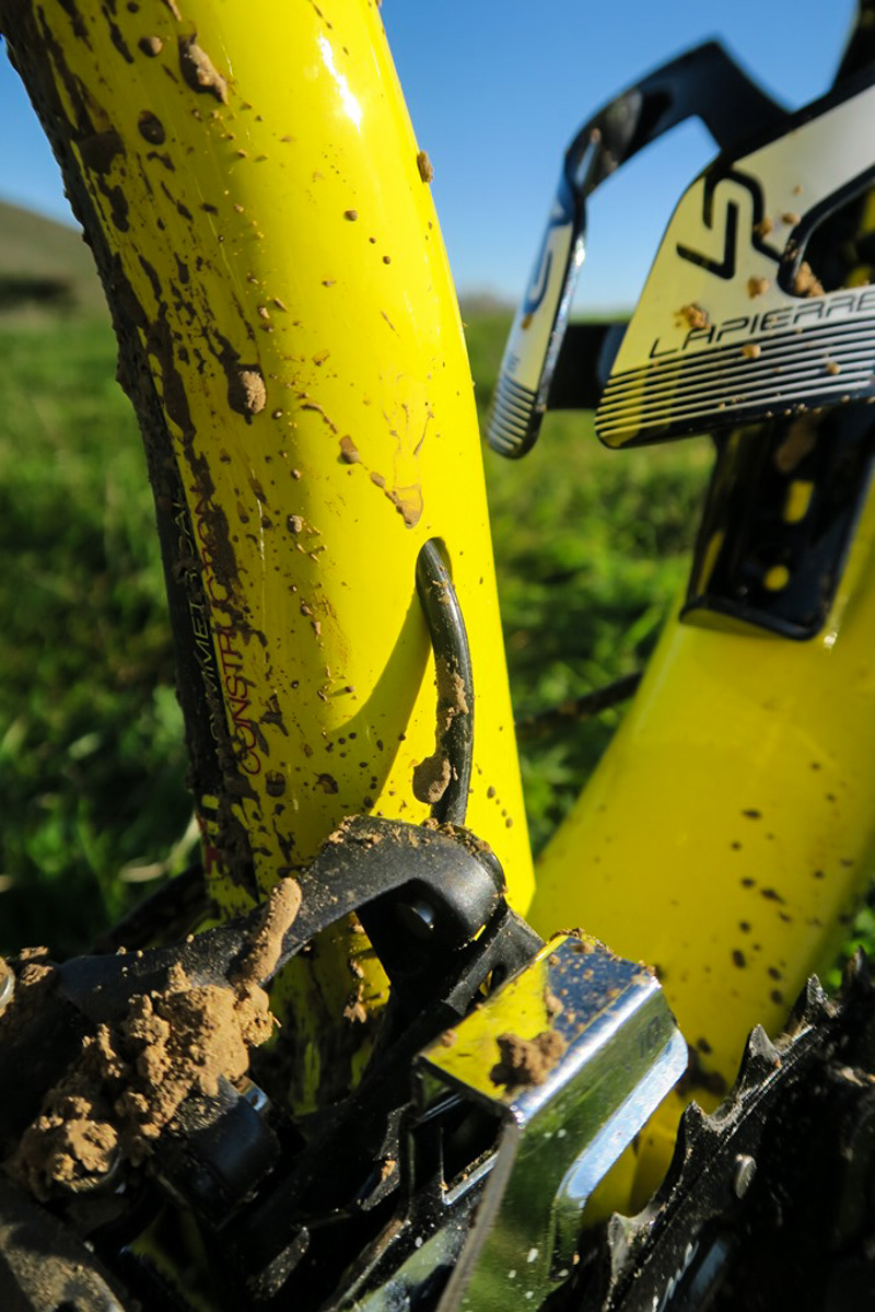

The rear triangle is quite massive around the rear axle. It looks mean, but can cause your heels to rub against them while pedaling. The extra bulk does give one the confidence that it will last for years and years.

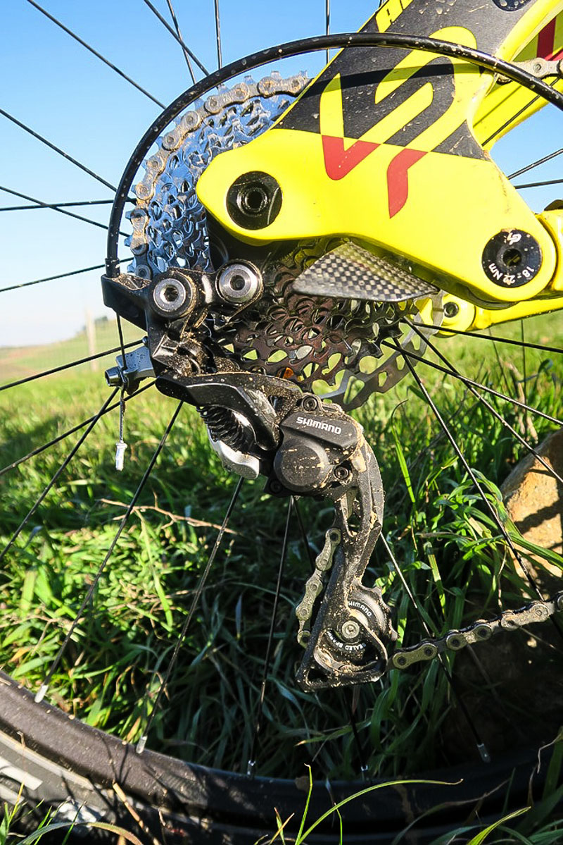

A couple of clever ideas on Lapierre’s part. First, there’s an integrated rear derailleur guard made from carbon fibre. This will keep your derailleur safe in a crash and out of the way of flying rocks.

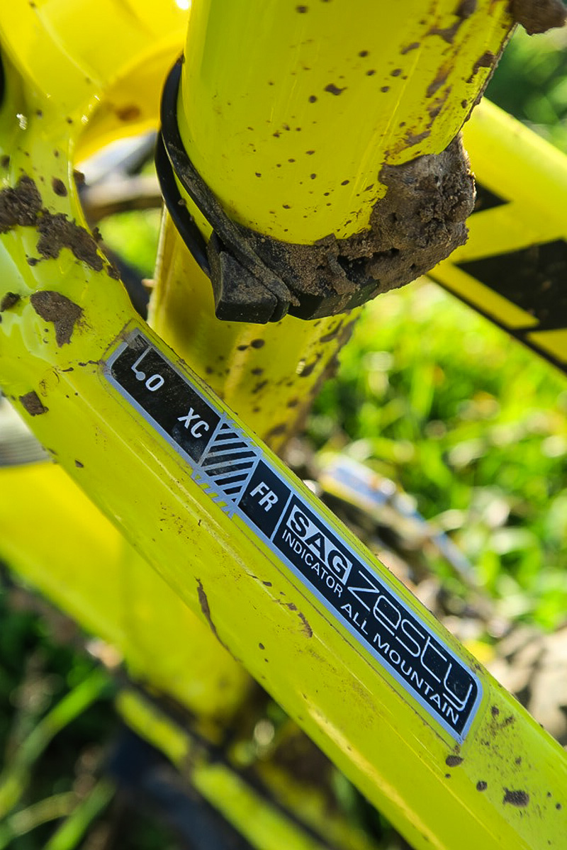

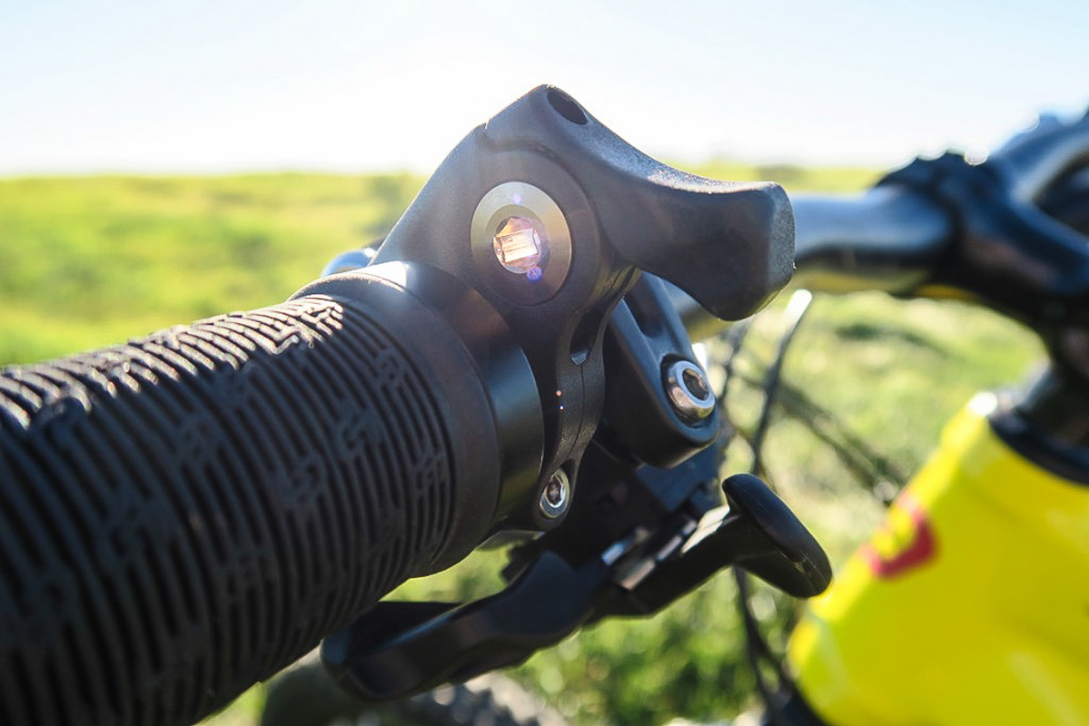

Secondly, the Zest features a sag guide printed on the left seat stay with a rubber band and indicator on the seat tube making set up a breeze. Lastly, the frame has internal routing for a dropper post as well as their E:i suspension.

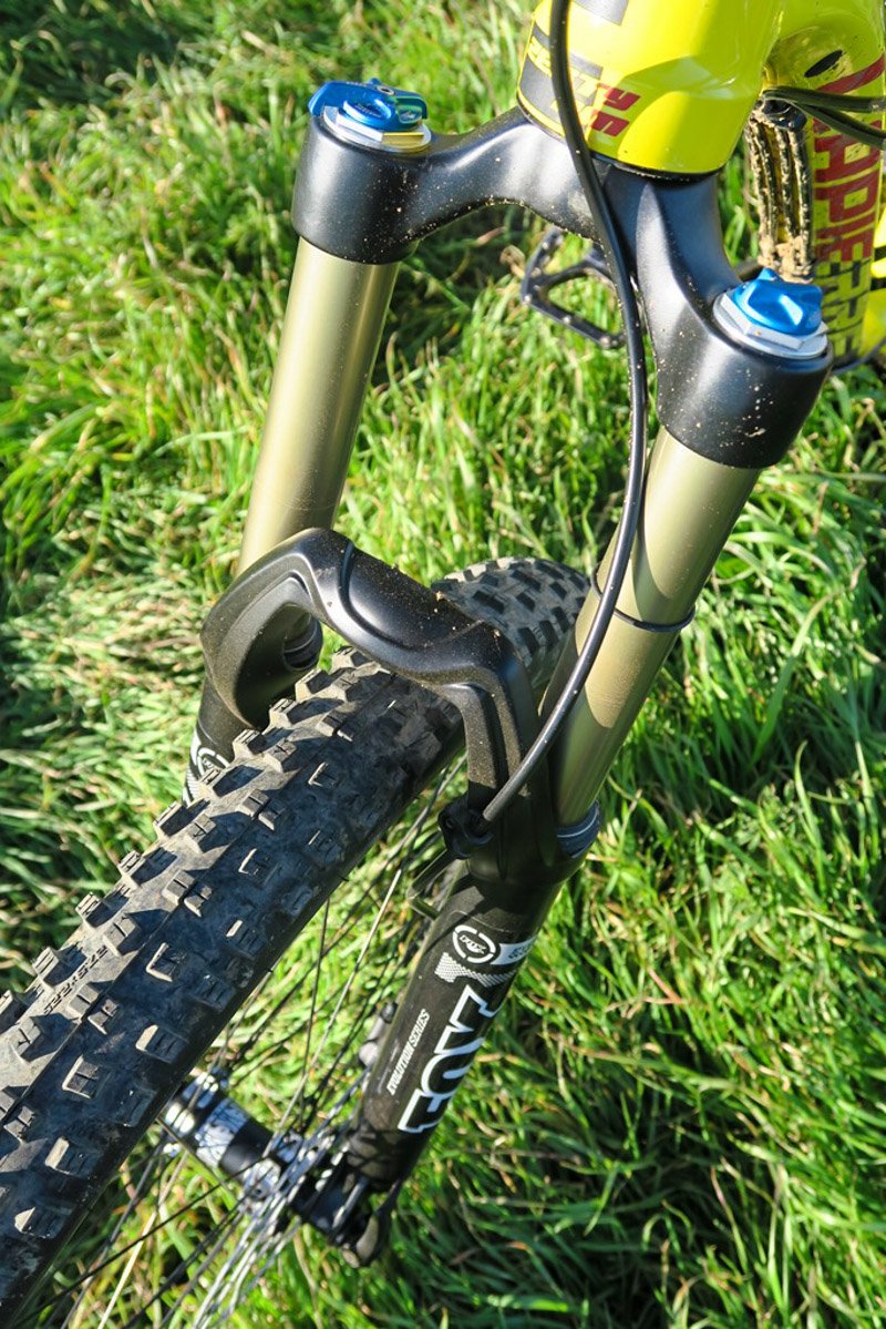

Fork: The Zesty confirms that a Fox 32 has no place on a bike with 140mm of travel or more. It simply can’t keep up when pushed hard and it’s small bump sensitivity is not nearly good enough to be able to balance big hit performance with smoothing out trail clutter. On top of that it shows signs of flex quite early.
Drivetrain: Gear from Shimano, SRAM and Race Face work together on the AM427. It’s quite a mixed bag, but it works 100% and once up to speed you won’t notice, or care, who what is from. Shifting was positive and the Turbine cranks from Race Face are stiff and spin smoothly.

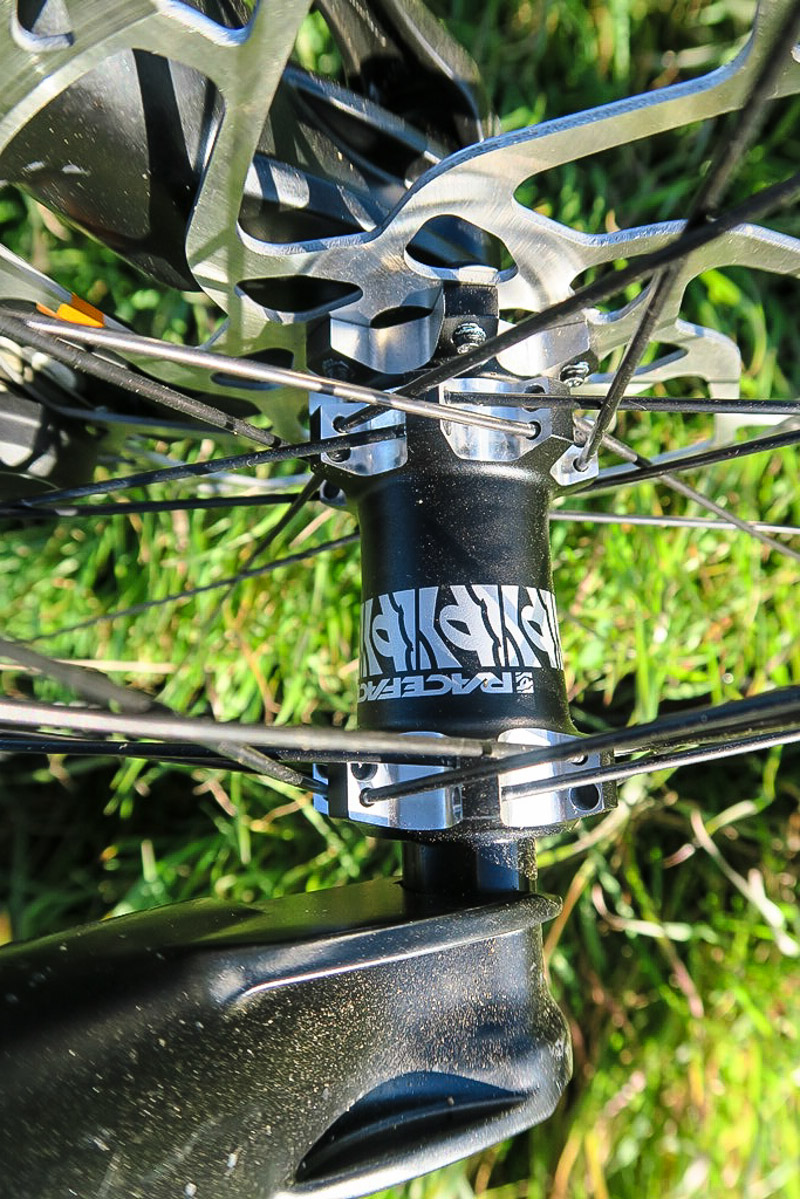

Wheels: This was my first time riding Race Face wheels. They get the job done and I quite liked the understated, but good looking graphics. For the heavy hitters 28 spokes per wheel may be a concern, but without a proper long-term test there’s no way of knowing. Hub engagement is average rather than snappy.

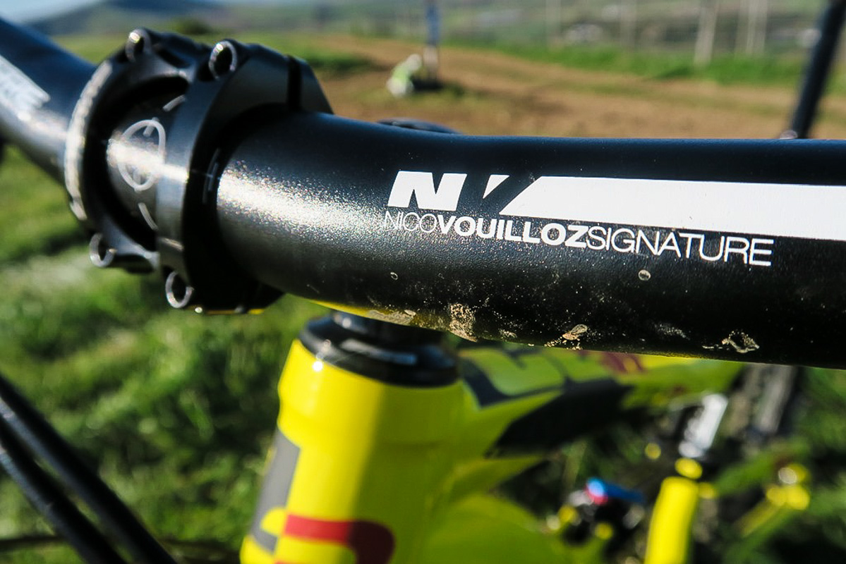

The handlebar and stem are both Lapierre Nico Vouilloz Signature made by FUNN. At 740mm wide the bars are of average width, but is a good fit for the bike’s overall geometry.

Unfortunately the fork and tires (especially on the front) run out of ability long before the frame does. Strangely enough this wasn’t as a big of an irritation as on some other bikes. I’d put this down to the well-balanced geometry and trail manners of the bike. The Spicy offers the same frame with a pick of Fox 34 or Rock Shox Pike, depending on the model, and could be worth a look. Otherwise ask your LBS to look into upgrading these for you before you hit the trails.
