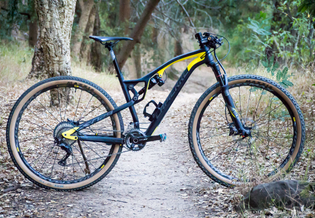

With the curved top tube, black and yellow colour scheme, and skin wall tyres, the XR 729 draws attention wherever it goes. A bike this distinct is bound to divide opinions and generate some strong reactions. I enjoy the highly engineered appearance, and after three weeks with the bike, I can say it is not just a pretty face.
The Frame

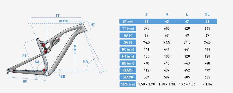

The frame has seen some tweaks from the 2016 model (which we reviewed here). The geometry has been updated significantly: the chainstay is 5 millimetres shorter, the reach is 20 millimetres longer, and it has been specced with a shorter 70 mm stem. These changes aim to provide more responsive steering and a more agile ride.
Other features include internal dropper post routing, and trap door technology which offers Di2 battery mounting inside the frame above the bottom bracket, or the option to store the e:i suspension battery out of sight.

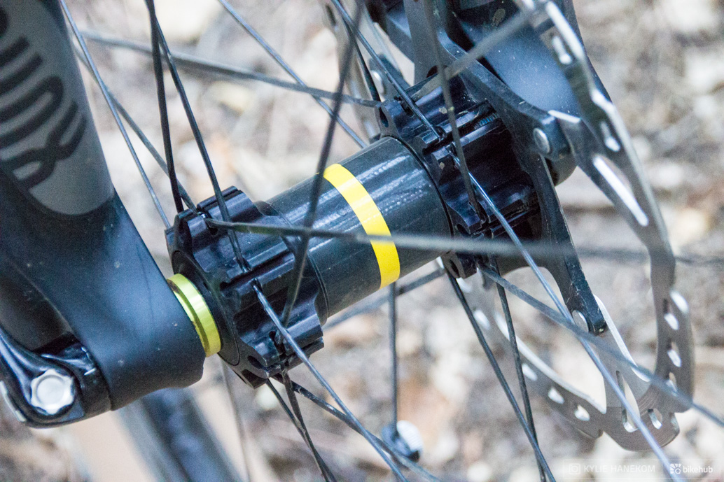

Wheels: The Mavic Crossmax Elite wheelset features boost front and rear hubs. The wheels felt reassuringly stiff and engagement time on the hubs was good.

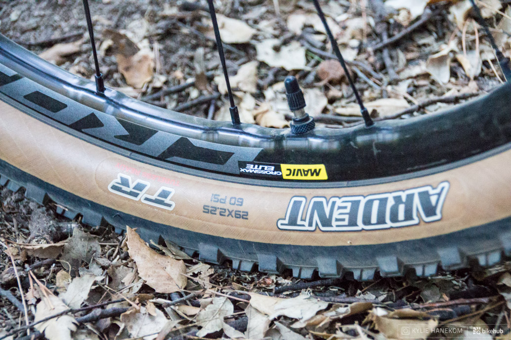

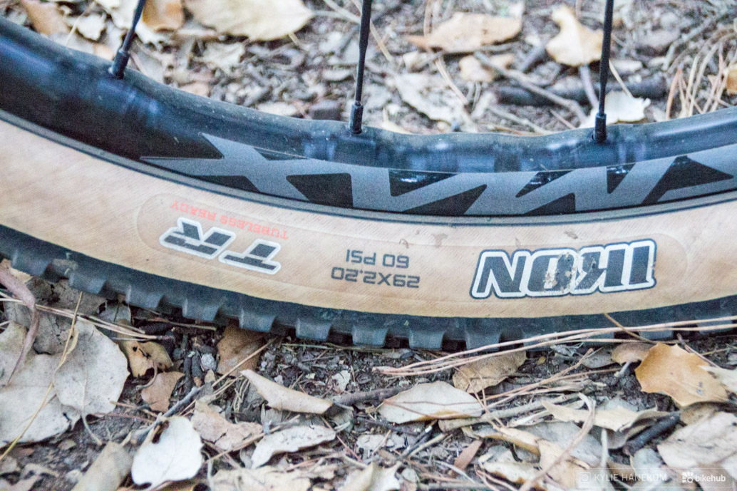

Tyres: The Maxxis Skinwall tyres are a nice peacocky touch and are one of the reasons the bike stands out so well from the crowd. The 2.25″ Ardent on the front offers acres of grip, and the 2.2″ Ikon on the rear serves its purpose well, as a fast rolling, lightweight cross country tyre.

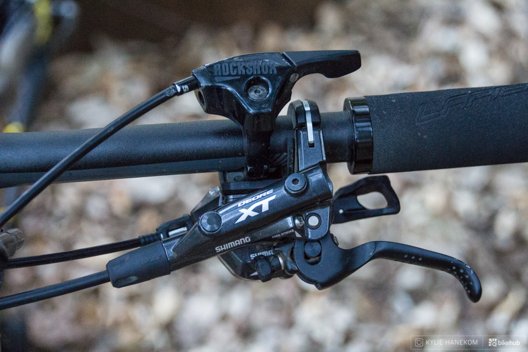

Brakes: The Shimano XT brakes, as always, offered firm reliable braking.

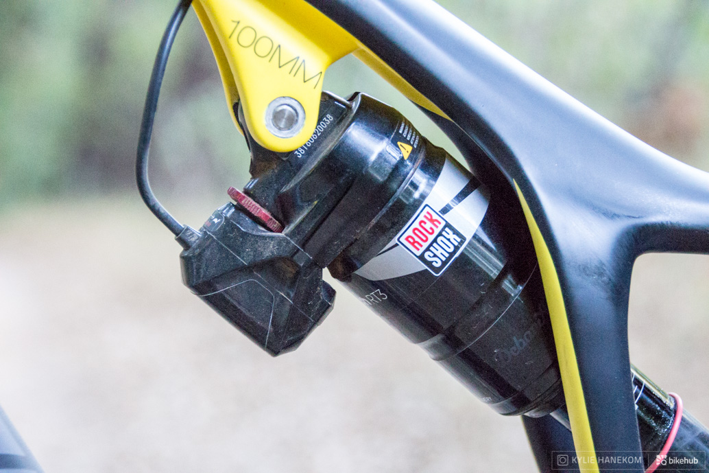

E:i Shock
The e:i Shock is the intelligent suspension system pioneered by Lapierre and is the reason for the somewhat space age appearance of the XR 729. The system is composed of a rechargeable battery, mounted to the down tube, a control & display unit on the headset including an accelerometer, a servo motor mounted to the shock, an accelerometer on the fork lowers and a cadence sensor on the crank axle. The entire system has a claimed weight of 350 grams.

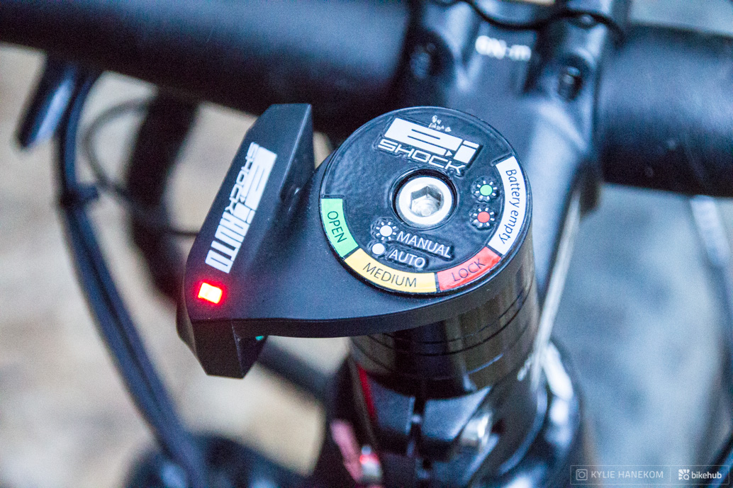

The motor shifts the compression damping of the shock between three modes: open, medium and closed based on input from the sensors which change depending on the terrain. The compression mode is indicated by the display LED which is solid in automatic mode. Green indicates open, yellow the medium setting and red is fully locked out. When freewheeling or not pedalling the suspension automatically moves to the open setting: this is useful for descending and jumps or drops where the fork may not register a hit before the shock needs to open.
It is possible to adjust the sensitivity of the system by pressing and holding the button on the control unit for 4 seconds. The green light indicates maximum sensitivity to bumps, the yellow light is the medium (and most commonly used setting) and the red light indicates minimum sensitivity ie. the firmest suspension setting.
The system can easily be switched to manual mode by simply pressing the control button once. When the display LED is solid it indicates automatic (electronic control) mode. A flashing LED indicates a manual setting, where green = open, yellow = medium, red = closed.
On the trail, the e:i Shock system is pretty handy. Much like the Specialized Brain, it lets you get on with the business of riding, without having to fiddle with suspension settings. It can feel rather weird as it switches between modes: the change is noticeable as it firms up on flat ground, or opens on rough terrain, along with the characteristic buzz of the servo motors. Once you get cracking on a fun piece of trail, it is easy to forget about it, but I found myself watching the light and trying to predict when the mode would change whenever I was slogging along jeep track.
To give you a rough idea: the e:i shock locks out on tar, flat jeep track and sand, while choppier jeep track with small stones and roots would cause it to switch to medium, and finally any bigger hits or baby head sized stones would open up the suspension completely.
The battery provides 24 hours of riding time. I was none too pleased at having yet another battery to think about and sure enough: after riding the bike for two weeks without charging the battery I was caught out by the flashing green and red- indicating low battery. The shock defaults to open when the battery dies, and thankfully I was able to continue riding.
Geometry & Sizing

Jumping on the XR 729 initially felt like piloting a space ship. The “bzzzz” of the servo motor as the shock changes modes can be disconcerting, and the nest of cables around the cockpit feels cluttered and excessive.
