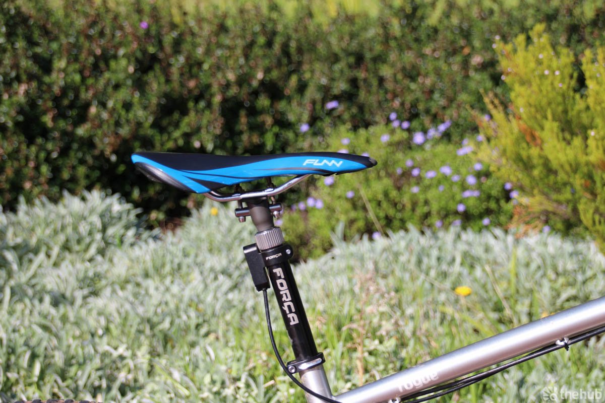

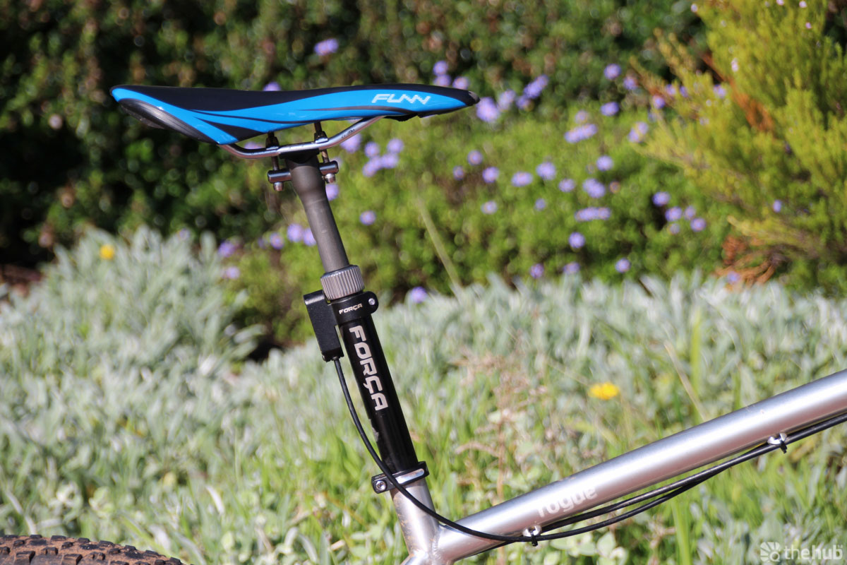

The Forca dropper seatpost is a low tech mechanical adjustable seatpost. While you may want to cringe at the thought of a spring and pin operated mechanism between the legs, the Forca is a solid offering and features benefits over hydraulic or air operated systems.

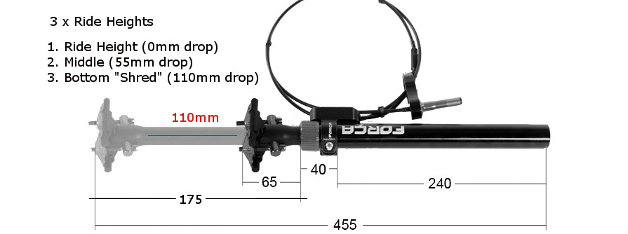

The Forca SPS-400 features 110mm of adjustment with 3 height positions. There are options for both 27.2 and 31.6mm seatposts. The SPS-400 comes in at a claimed weight of 520 grams.

How does this mechanical dropper post work?

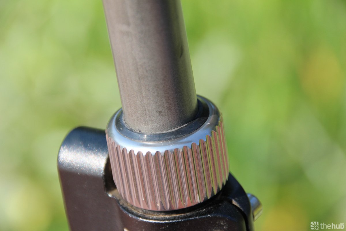

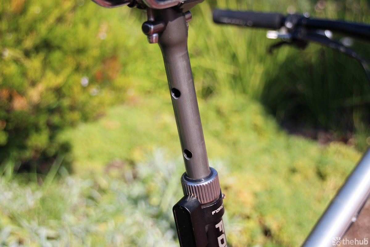

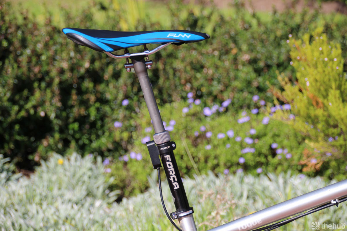

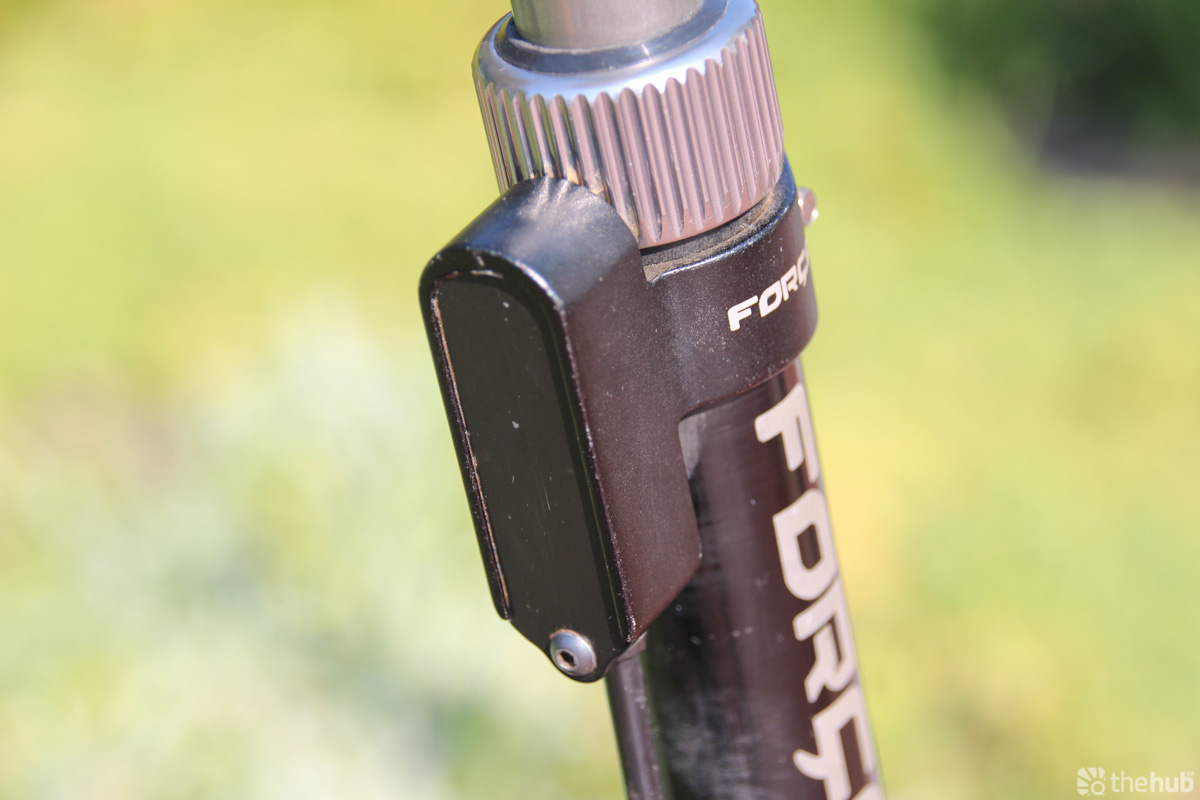

The Forca employs a simple spring and pin mechanism. A steel pin is actuated by a cable connected to a lever on the handle bar. There are three positions (holes) on the post which the pin can slot into and fix the post in position. Two bushings assist with the smooth raising and lowering of the seatpost. Should you want added protection, as the holes in the post are exposed, the Forca comes with a very 90’s rubber booty which fits around the seatpost and helps to prevent dirt from entering the system. Pressing the lever and applying some weight depresses the post. Lifting the post also requires some weight to safely unlock the spring that raises the post.

Forca claim that this simple mechanical design makes the SPS-400 extremely rugged and, should anything go wrong, easy and very affordable to repair compared to more complex hydraulic and air dropper posts. As the spring is rated for 10 million cycles, it is likely that the part mostly likely of ever wearing out are the two bushings (especially if you allow mud to gather in the post). Cycle Factory say that replacement parts will be readily available.
The Forca’s cable routing is external but unlike some dropper posts, the cabling doesn’t move with the seatpost. Making it slightly easier to secure to a bike. Although the lack of an internal routed option does mean that space will need to be found on the frame to run the cable, which may or may not be problem depending on your setup.

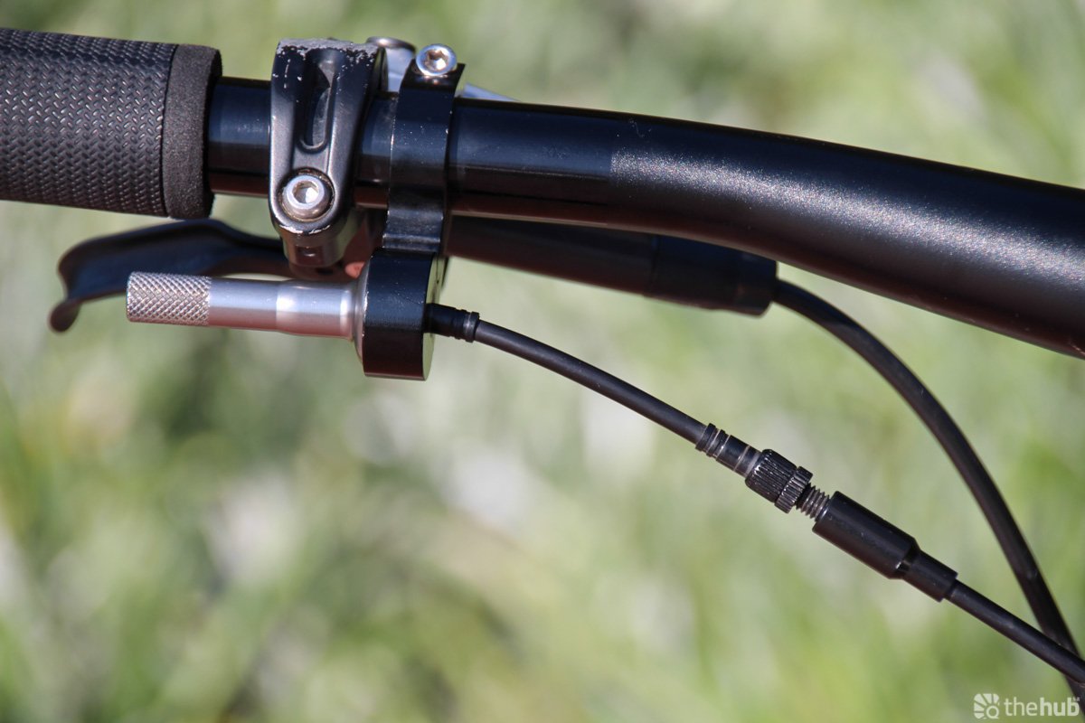

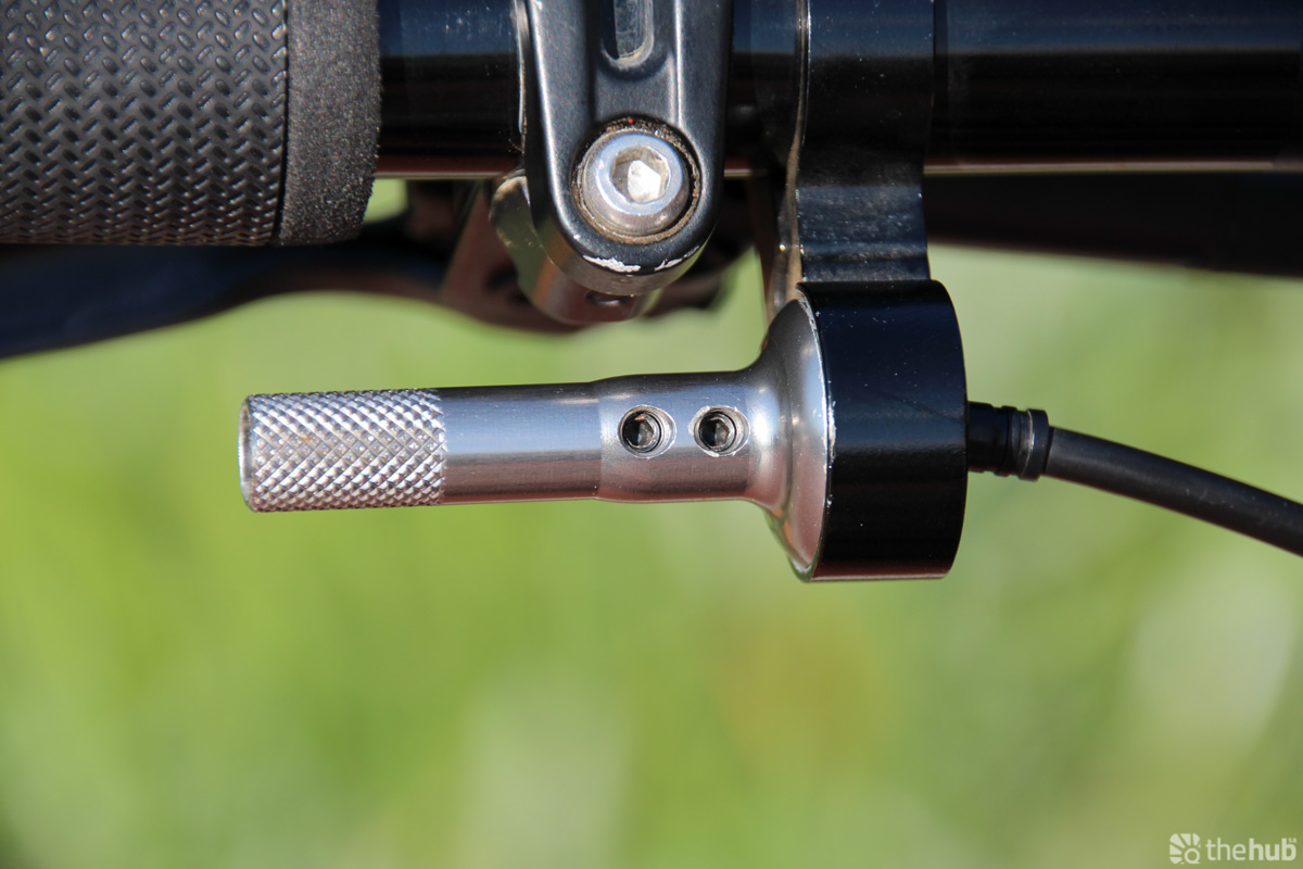

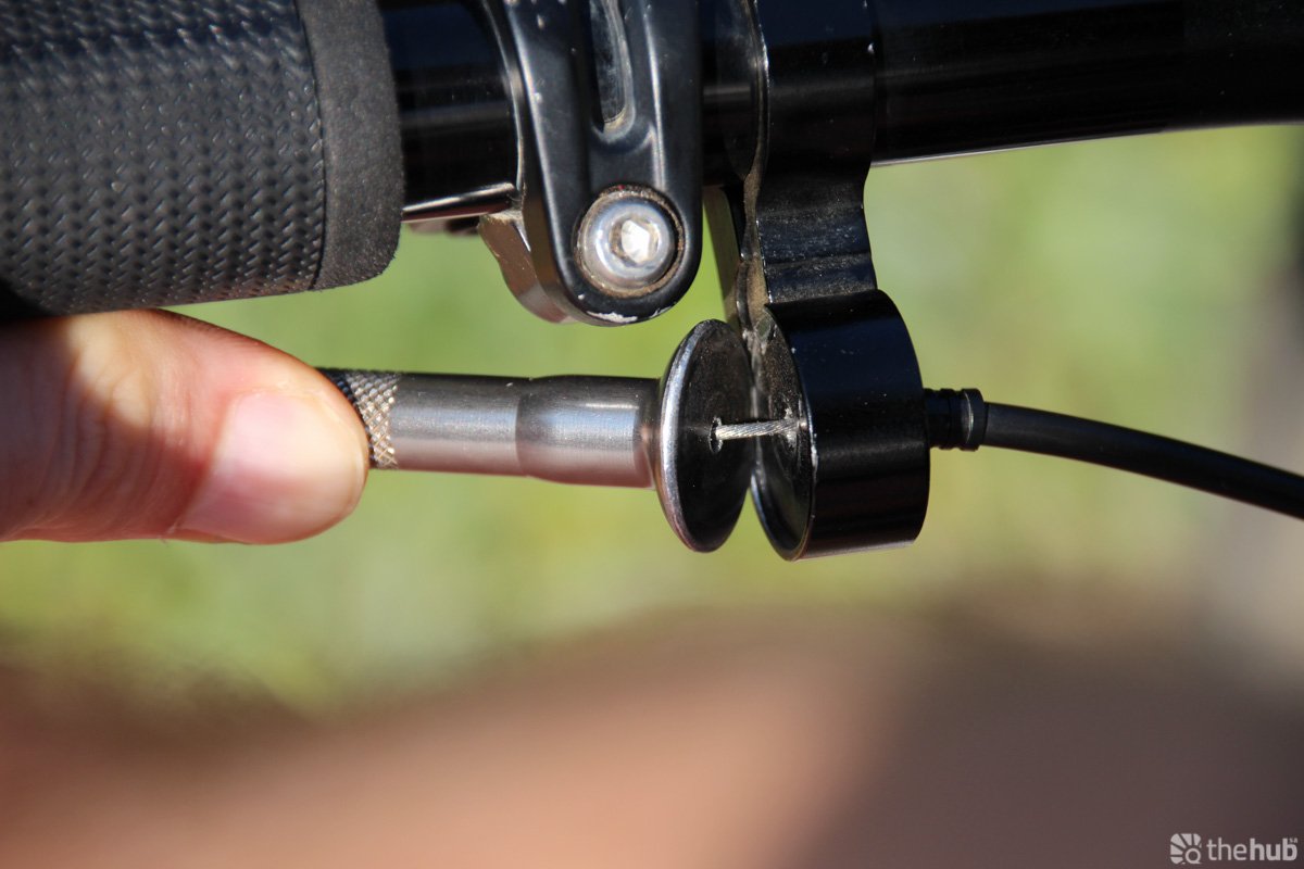

I chose to place the lever on the underneath the bars on the left hand side. This allowed me to operate the Forca with my thumb similar to a gear shifter. Despite looking like something you’d find in a christmas cracker, the lever worked well. The only time I had problems with activation of the post was when the cable tension was too slack (common to all cable actuated seatposts). Cutting the slack is a easy task using the cable adjuster built into the cable outer to achieve the desired cable tension. If you get to the stage where you’ve run out of adjustment on the cable outer, you can simply loosen the set screws in the lever and tension the cable.
Forca SPS-400 13.jpgThe lever and set screws holding the cable in place.
Forca SPS-400 12.jpgThe lever and cable tension adjustment.
Forca SPS-400 14.jpgThe lever activating the seatpost.
Three point engagement is sufficient in my books. Although I can appreciate the further levels of adjustment on other dropper posts, I never found myself lacking on the Forca. I did sometimes struggle when trying to select the middle position, as the pin needs to find the hole to lock in place.
