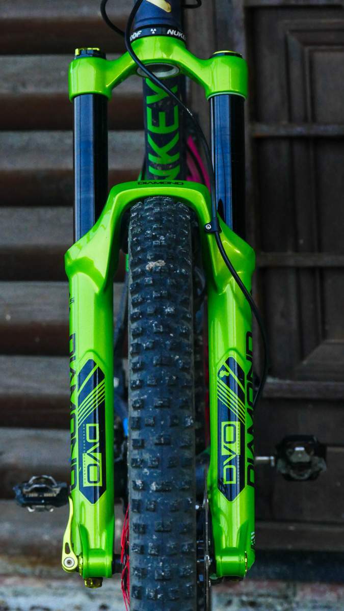

Aimed directly at All Mountain and Enduro riding, the DVO Diamond is an air sprung fork with 130-160mm of travel. The Diamond is available in 27.5″ and 29″ options. It features a plethora of external adjustments that includes DVO’s OTT (Off The Top) negative spring adjust borrowed from its bigger brother the inverted Emerald downhill fork. We’ve been testing a 27.5″ 160mm model for the past 10 months.
Chassis and Damper Design

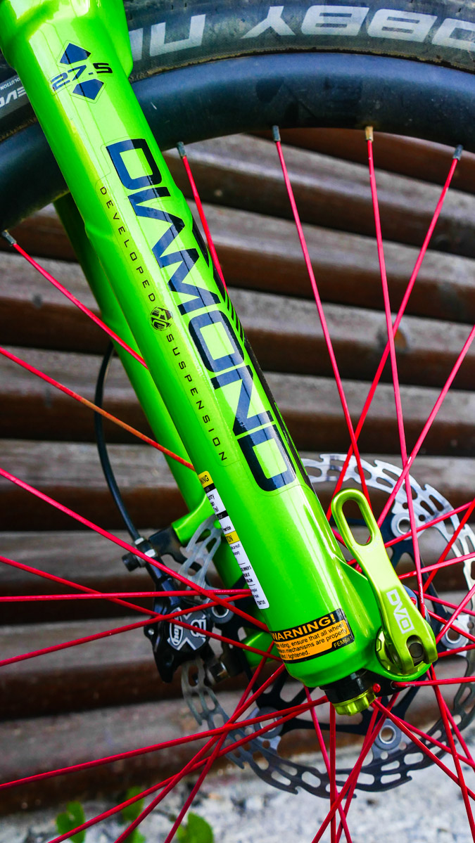

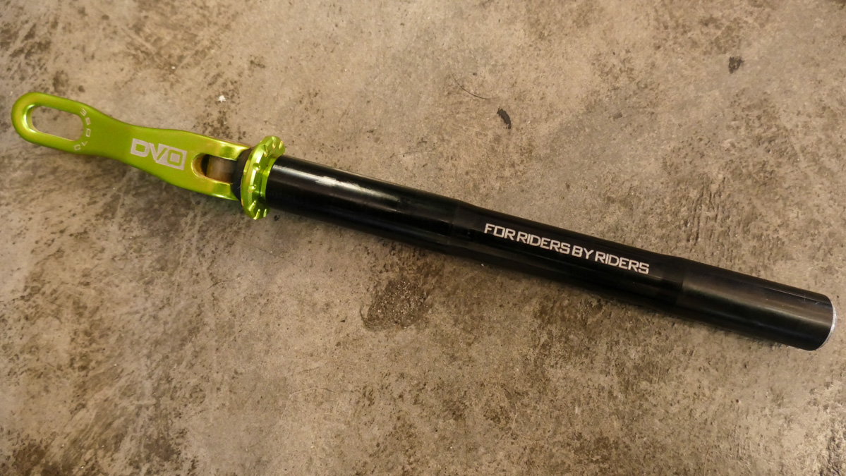

The crown is a forged and CNC machined hollow design, and features 44mm offset on our 27.5″ test model and 51mm on the 29″ fork. The uppers are made from 35mm tapered aluminium and the lowers are magnesium (casted by SR Suntour) with a visible external taper to help prevent excessive flex and binding. The QR15 axle is tapered in the centre to reduce weight and allows you to rotate the lock nut to get the perfect angle when the lever is closed.
Our 160mm 27.5″ model set at 160mm has an axle to crown height of 555mm compared to a Pike’s 552mm and Fox 36’s 549mm. Weighed wise it is on the heavier side thanks to its coil negative spring. Claimed weight for this model is 2100g. Compare that to the Pike which weighs in at 1861g, Fox 34 at 1780g, Fox 36 at 1923g – all of which use complete air spring systems. Only the MRP Stage at 2025g (actual weight with a cut steerer) comes close, but it too is air sprung.

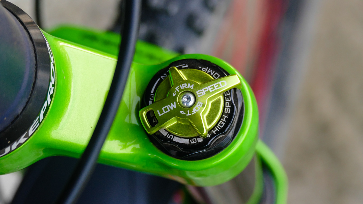

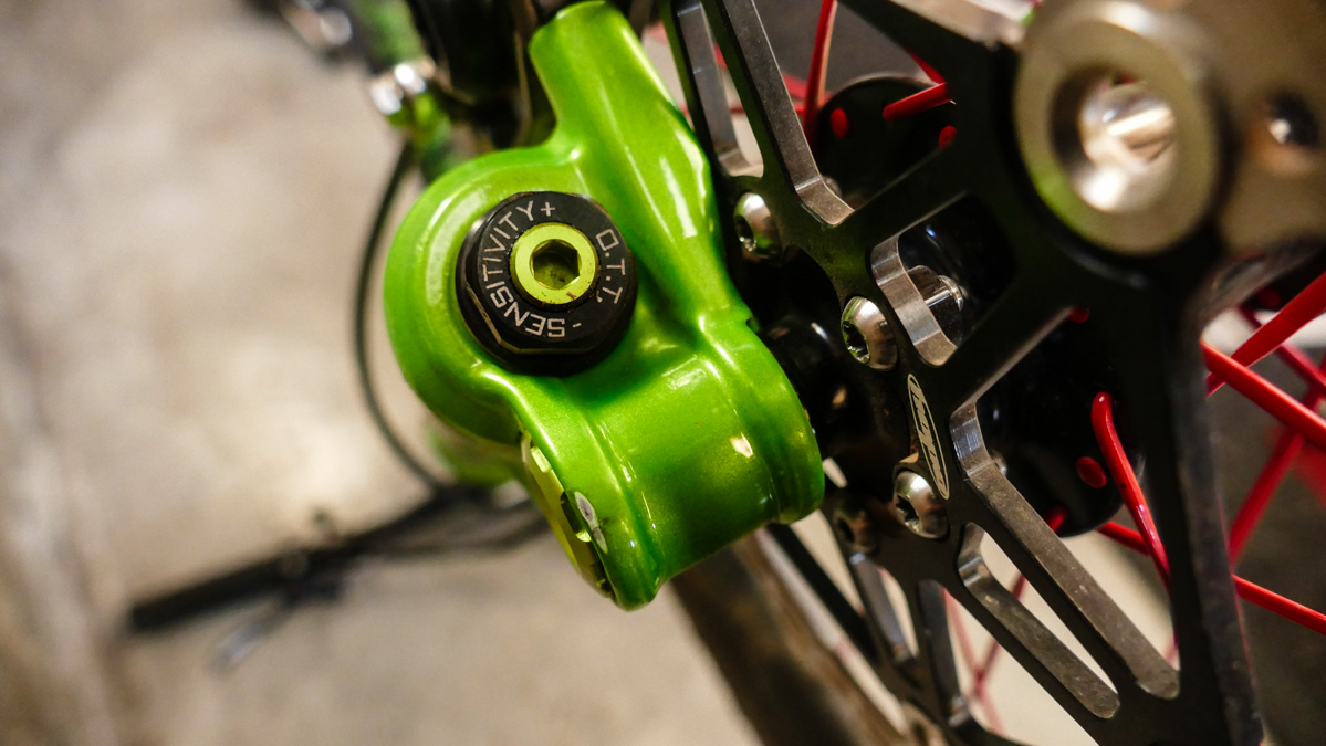

External adjustments include air pressure, independent high and low-speed compression damping, rebound, and Off The Top (OTT). OTT changes the initial feel of the fork by preloading the negative spring housed at the base of the air cartridge.

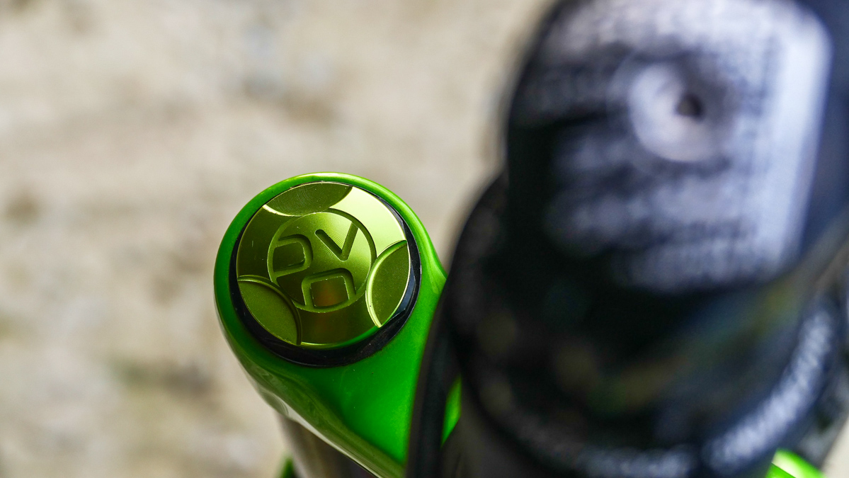

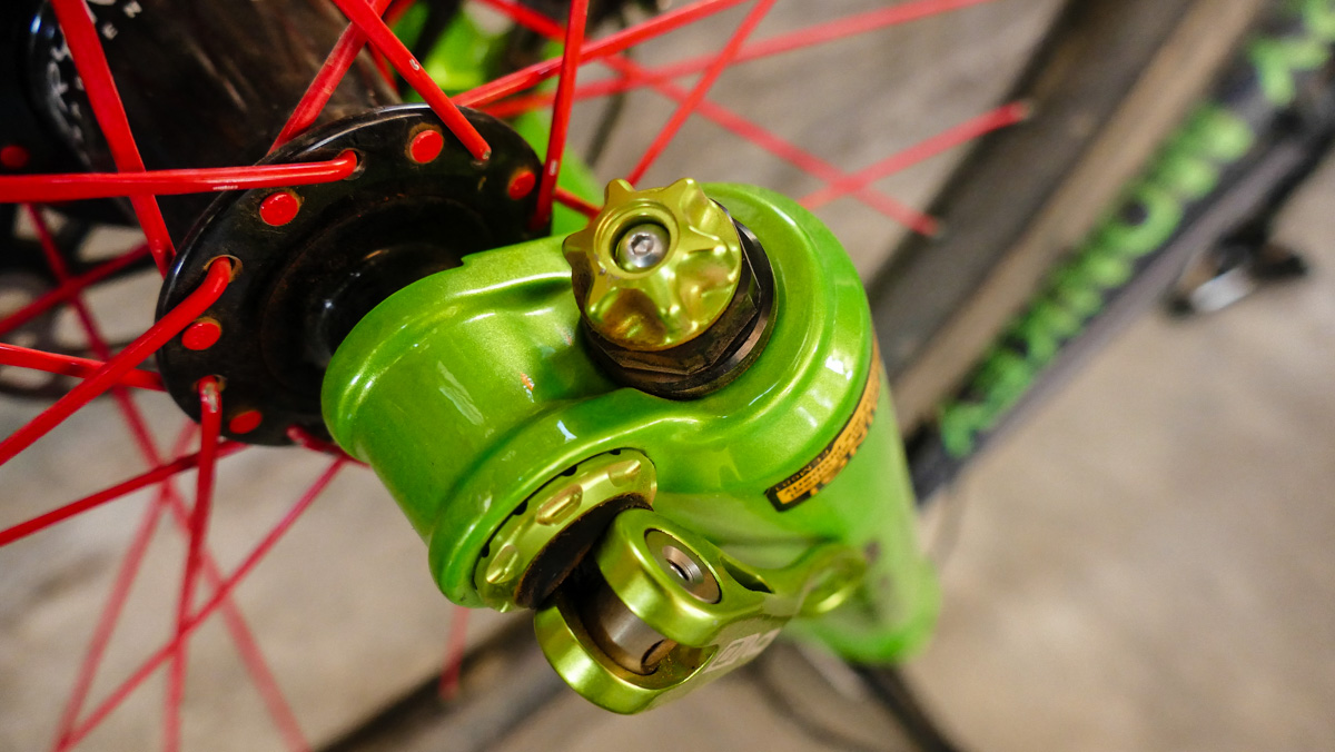

Air is adjusted on top of the left leg with the top of the right leg hosting the Low Speed Compression (LSC) and High Speed Compression (HSC) adjustment. At the bottom of the left lower is where you will find OTT adjustment with Rebound adjust on the right hand side.

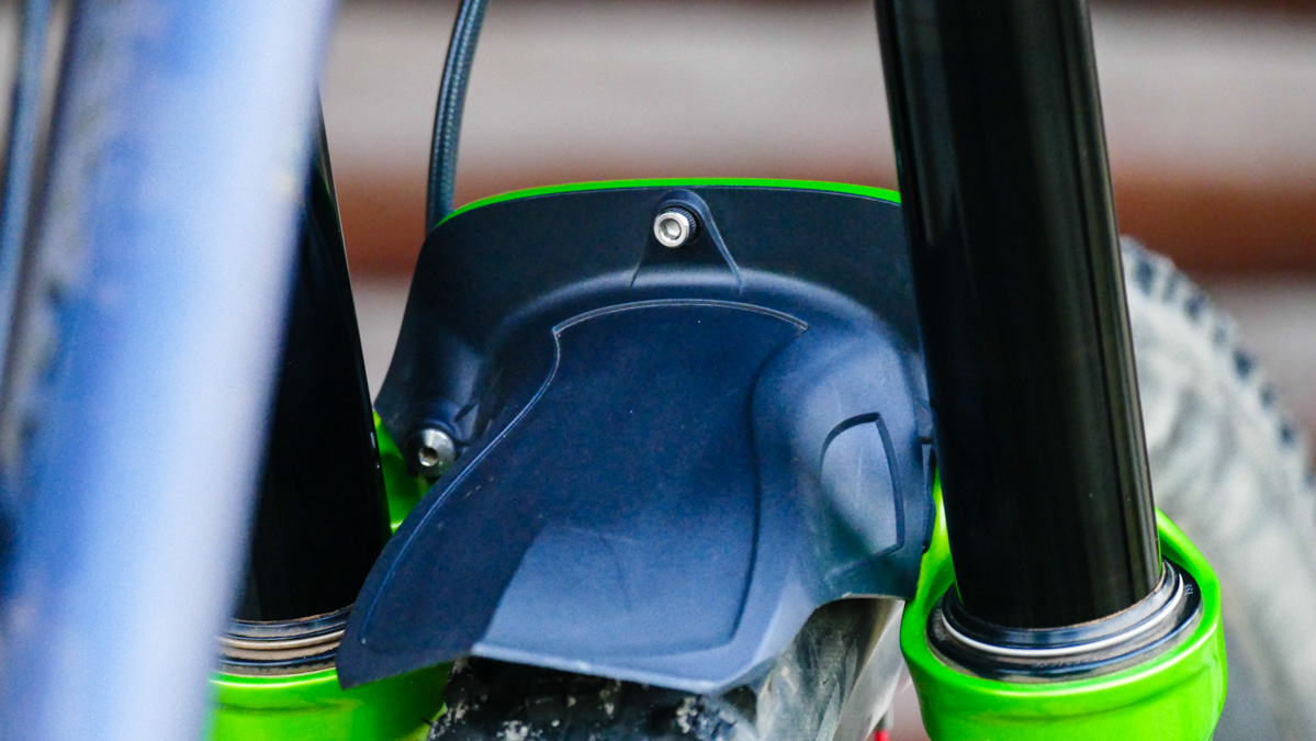

A smart touch is an integrated fender mount, which supports a short fender that covers the latticework at the back of the arch and extends a few inches rearward. Installation is quick and easy and it does a great job of keeping the worst muck off your face and chest.
The left leg houses the air cartridge unit which is a complete unit that can be removed and serviced. The right leg contains the damping unit which is a closed cartridge bladder system. Unlike other forks where the bladder is filled with oil and expands as the fork cycles, the Diamond has air inside the bladder and oil on the outside that compresses the bladder rather than expanding it. A design DVO first used on their Jade rear shock. They chose to go this route to combat a few negatives of cartridge bladder systems, including loss of elasticity of the bladder over time. DVO claim this improves initial sensitivity.

You will need a 5mm Allen Key to adjust the OTT. Increasing (rotate clockwise) the OTT will make the fork more sensitive (softer) at the beginning stroke. Decreasing (rotate counter-clockwise) the OTT will make the fork less sensitive (firmer). The OTT feature will not change the middle or ending stroke of your fork. OTT offers 14 full rotations total with 6 clicks per rotation.

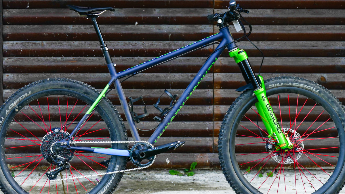

My first couple of rides I summed up as “promising”. Using the stock settings the correct feel was already there and I felt that with some tuning a beast will be unleashed. I was not wrong. After some riding the fork loosened up noticeably with a more supple and controlled feel, and with some further tinkering it really came alive.
In an effort to get a feel for each adjustment I went extreme and found that each setting has a useful range with a notable change in feel. From the recommended stock settings for my weight I dropped 5 psi, dialled in a couple of OTT clicks, kept LSC more or less what was prescribed and tuned the HSC until I was happy with the feel. For those who like to hammer on the climbs LSC can be used to stiffen the pedaling platform reducing fork dive under load.
On my Mercer Hungry Monkey the ability to tune the fork to a feel I like on the trail brought the bike and my riding to life. Compared to the dual position Pike I had fitted to the same bike, the DVO Diamond was not as smooth from the get-go but settled in and with the setup to my liking it was a step or two ahead without any signs of the additional weight.
Everything from repeated hits to trail chatter melts away under the Diamond and the harder you push the better it gets. On several rides I used full travel without ever noticing it out on the trail. There is no discernible flex even in the worst conditions helping steering input and traction through rough corners. Much is made of small bump compliance, and rightly so, but to keep a bike playful it needs good mid-stroke support and the Diamond delivers, making the bike easy to move around as it feels alive underneath you.
