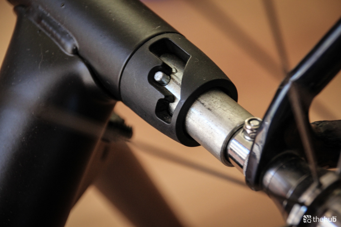

Adjustments can be made to suit the specific rear axle width

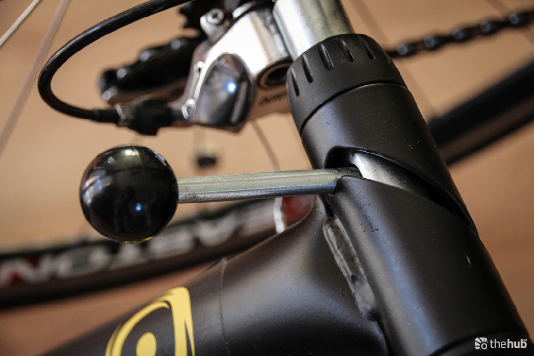

The solid bolt-action fixing lever secures the bike in place
The good news for mountain bikers is that there is a thru-axle adapter available, however it only supports 120, 130, and 135mm axle spacing and unfortunately no 29″ wheels. For that you’d need to look at it’s bigger brother, the PowerBeam Pro, although you’d still be limited to a maximum axle width of 135mm.
I tested the PowerSync with a standard 700c road bike and a 26″ mountain bike (with a semi-slick tire). Both were easy to mount and had ample space on the rolling surface. The roller should fit tyres up to 2.25″ depending on the profile and tread, although I’d opt for a smooth tire on the back from a noise reduction perspective.

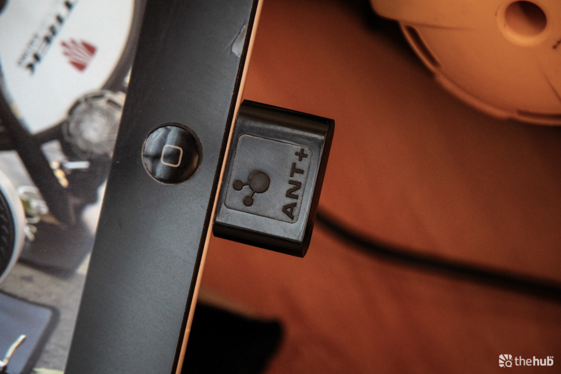

Our test unit is the ANT+ version and arrived with an ANT+ iPad dongle. This you’d have to purchase separately if the device you’ll be connecting to doesn’t natively support ANT+. There is also a Bluetooth model available, which although you would have an easier time connecting to, wouldn’t be as widely compatible with the majority of current sensors which are ANT+ based.

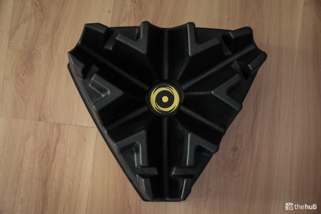

Accessory: Climbing Riser Block
Among the various accessories available from CycleOps is a Climbing Riser Block which our unit arrived with. This provides both stability and 3-levels of incline with the option to stack multiple blocks for greater inclines.

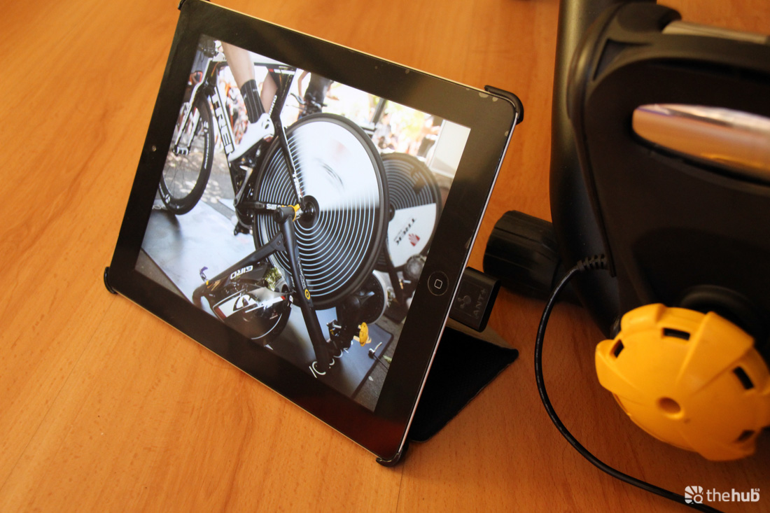

CycleOps Virtual Training
Installing and setting up the CycleOps Virtual Training app was quite simple and intuitive. The app is available for IOS, Android and PC. For testing we used the IOS version on an iPad with the ANT+ iPad dongle. Although the app is a free download there is a $6 monthly subscription fee to maintain full access to all features, but you can start off with a free trial.

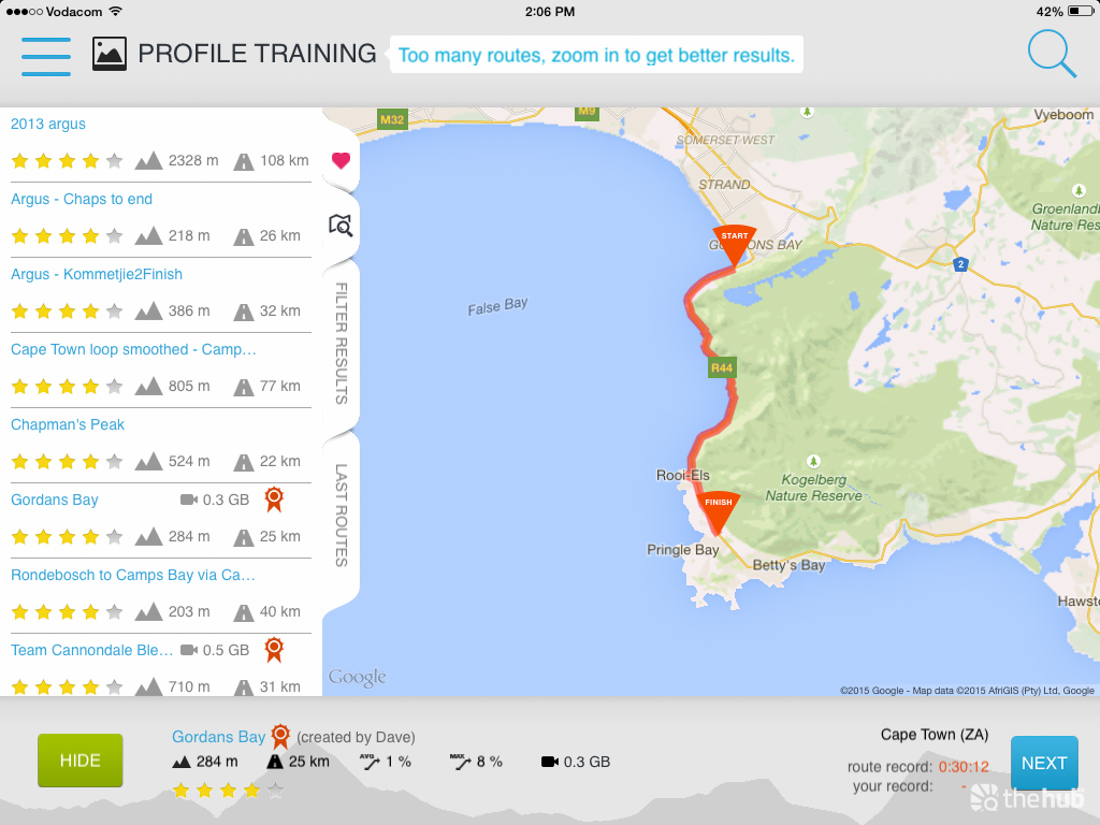

Profile Training

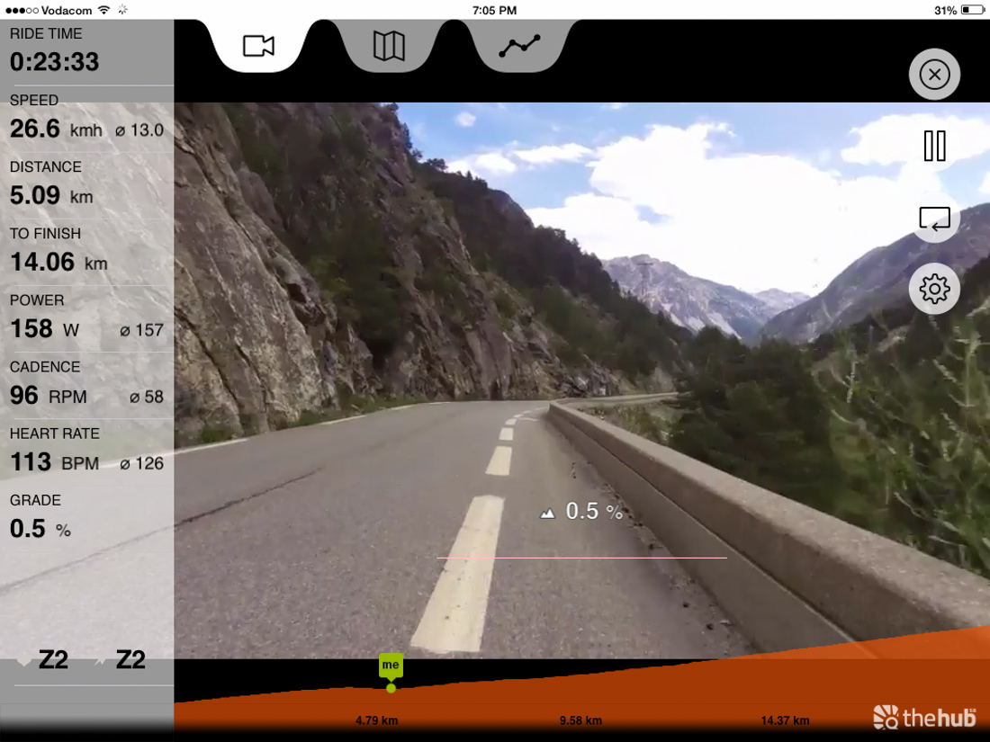

If you’re keen to test your legs on a specific routes or just get some simulated hill training this mode will let you follow a real-world route virtually. The app adjusts the resistance automatically to simulate the ups and downs of the actual route.

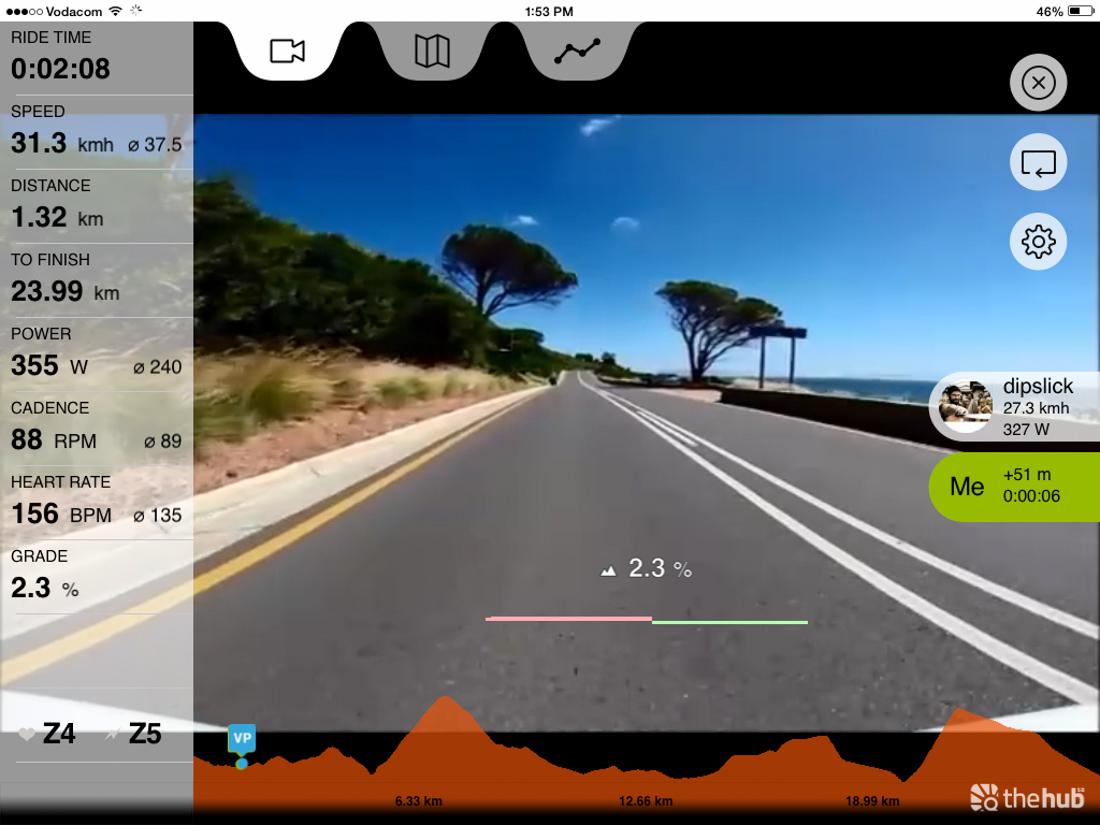

When I first jumped on the PowerSync I was sceptical about how this would feel. I chose my route, the Col d’Izoard, pressed go and hit the Pyrenees. This route is one of many that includes a video feed. When the video mode is enabled a video of the actual route will play based on your speed. You can either stream the video if you have a decently fast connection or download it beforehand.
Sure enough as the road kicked up the going got tough. There is a slight delay between the on screen gradient change and what you feel as the resistance gets applied progressively. I was impressed by the difference. The uphills really do make you work and quickly had me searching for more gears as if on a real-world climb.

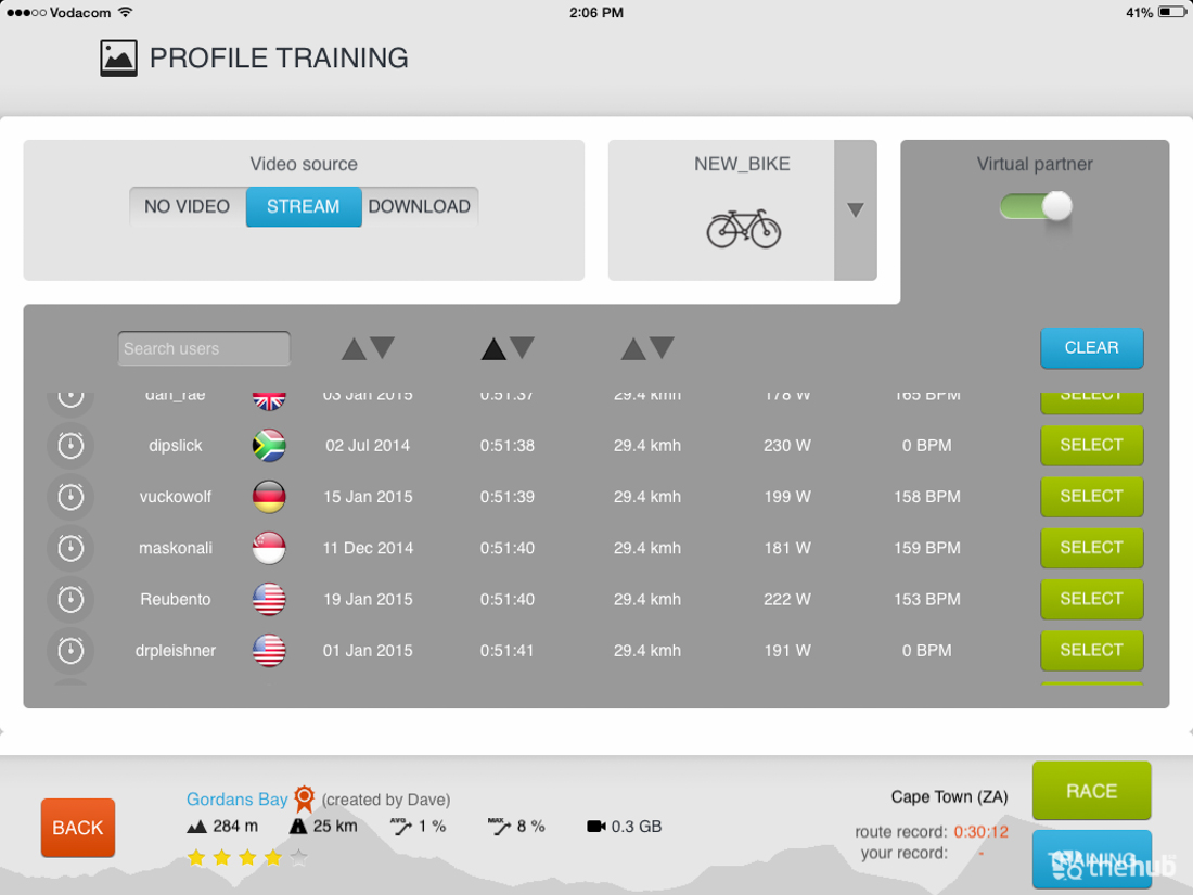

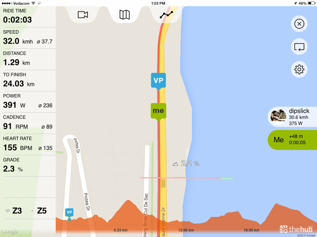

Virtual Partner
If you want a bit of company or some added incentive you can enable Virtual Partner. This feature allows you to select a previous ride from other users and compare your efforts.
I did a ride around Gordon’s Bay with Dipslick using a ride he’d recorded in 2014.

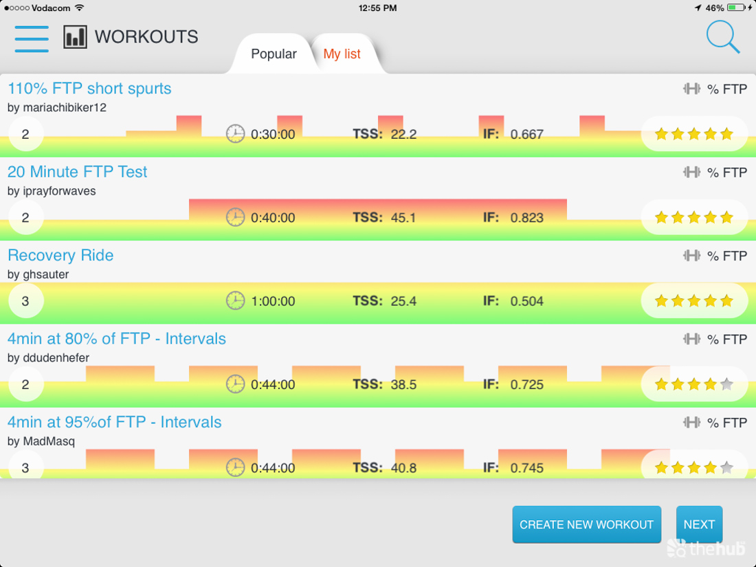

Workouts
Power based training is said to be the most efficient and effective and the CycleOps PowerSync makes this easy for you. The Virtual Trainer allows you to select from various existing workouts or create your own. Each workout is based on a specific metric, either: Power, Power / Weight, % FTP or Gradient %.
While you could do the same with a standard indoor trainer and power meter, the visual representation of the workout and on-screen cues thanks to the app take a lot of the thought out of it, allowing you to just ride.
For anyone serious about their training or just wanting to make the most out of typically limited training time this is a most valuable feature.
You can choose from various pre-existing workouts from other users

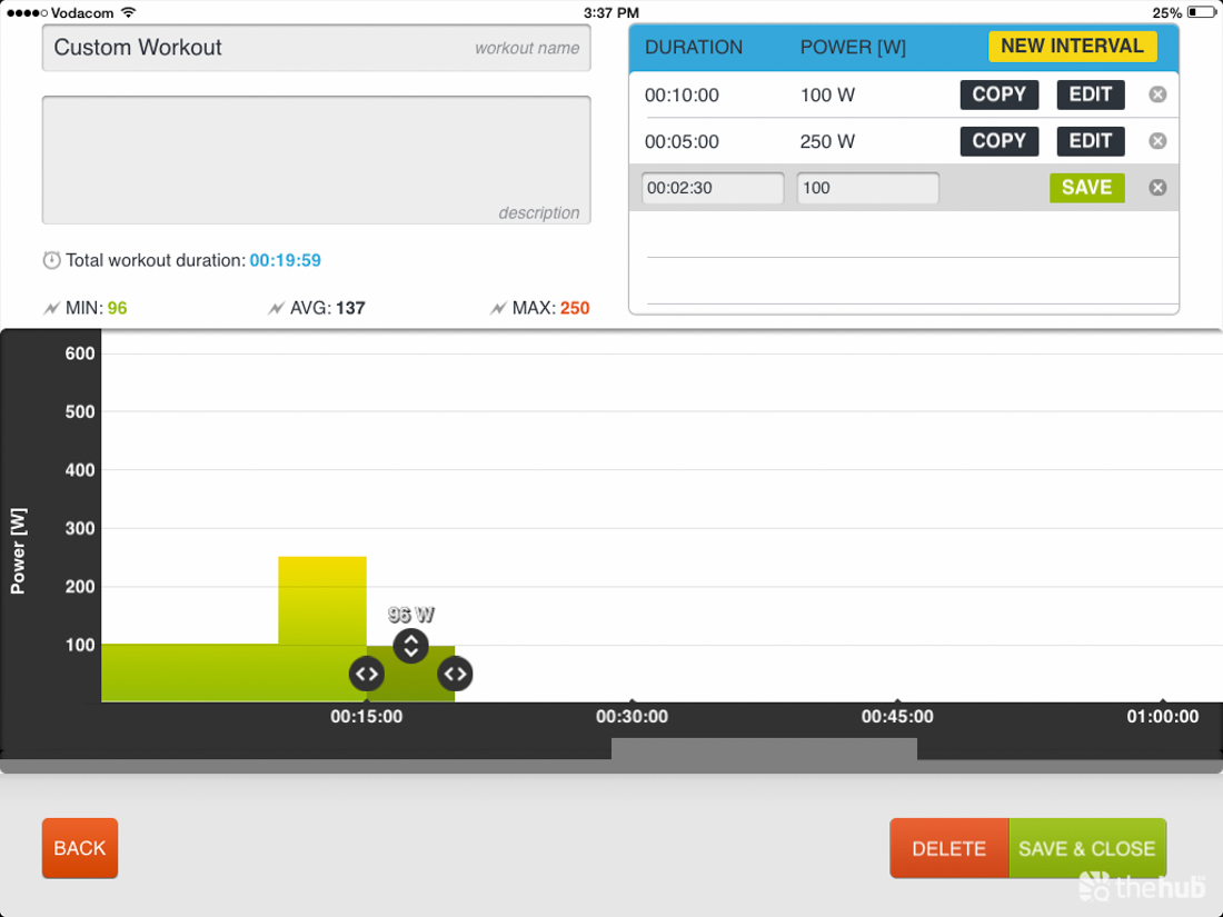

CycleOps Virtual Trainer-12.jpgOr you can quickly craft your own workouts.

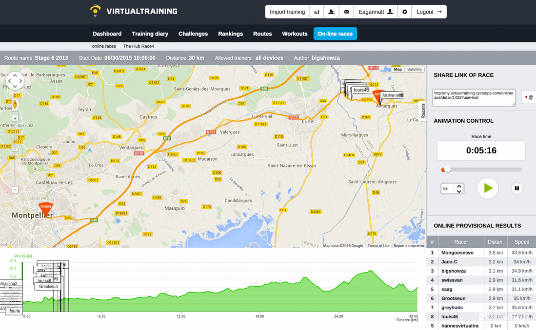

Online Race
Real time online races are one of the cool-factor features of the PowerSync and CVT app. Perhaps it’s a bit of nostalgia back to my misspent youth playing multiplayer computer games, but for me this is a great way to not only make indoor training more interesting, but create added incentive and commitment. Much like entering a real-world race it becomes all the more difficult to back out once you’ve put your name down.
The races take place in real time on a predetermined course and use the data from your trainer to pit you against the other participants. You can compete with real people on the same course, at the same time from anywhere in the world.
A group of Hubbers have been avidly running weekly races for some time now.

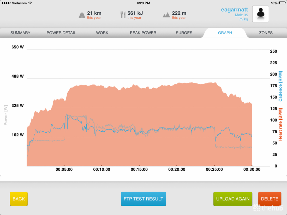

FTP Test
Thanks to the PowerSync’s built in power meter you’re also able to perform a Functional Threshold Power (FTP) test. This test will allow you to establish your capability and then tailor your workouts based on the results. It also lets you benchmark performances and track progress. Be warned though – an FTP test is not for the faint hearted!
CycleOps Virtual Trainer-16.jpgThe on-screen display mid-test
CycleOps Virtual Trainer-17.jpgResults from my somewhat feeble first attempt.

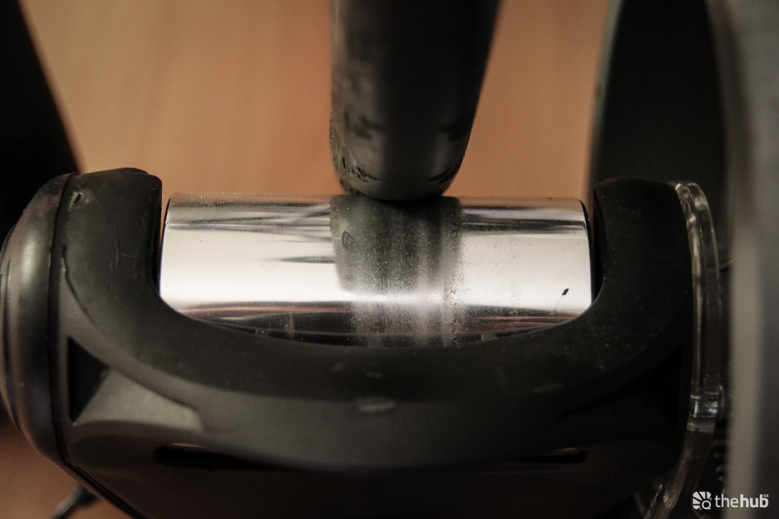

I saw this destroyed roller (silver metal part on one of the top photo's) and wondered what happened. Byt see a "Semi slick" tyre was tested...eish
Matt
Jul 29, 2015, 7:08 PM
I think that's just a bit of dirt and reflection, the roller is in perfect shape. The semi-slick contact surface is no different from a road tyre.

If you have a BLE trainer and accessories then you cannot use the Garmin for anything.
There is no difference between ANT+ and BLE in terms of connectivity and functionality, they are slightly different frequencies in the same band. Also ANT+ needs a code to connect (all done automatically) whereas BLE does not.
Have a look at their site for compatibility charts:
http://www.cycleops.com/virtualtraining/compatibility
Most apps that are used to control the trainers (CycleOps Virtual Training, Zwift etc.) will all transfer the data of your ride to Strava etc. anyway, so if you are uploading your Garmin data to Strava then don't fret... the app will do it for you.
