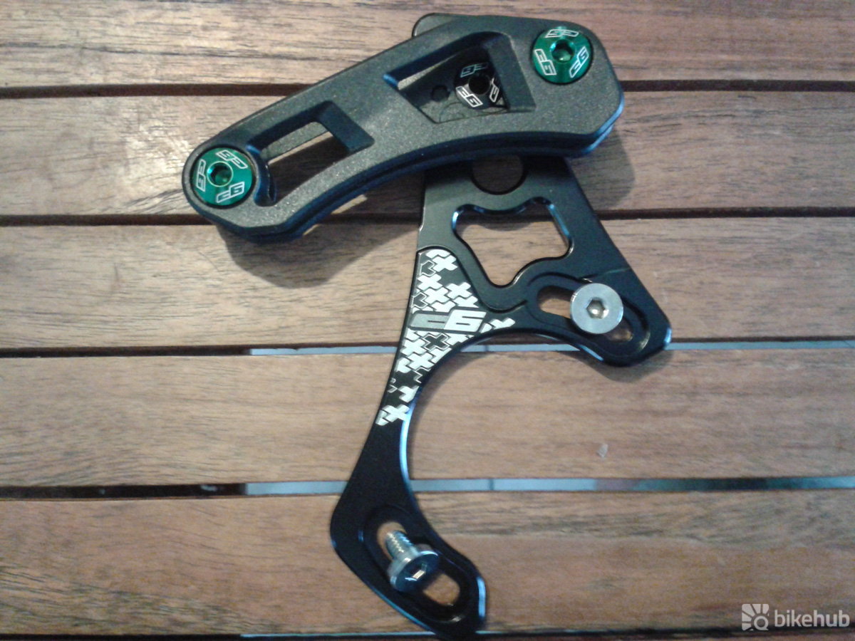

  • 3SERIES: Anodised 7075 Aluminium backplate and a Nylon Top guide (70.2 grams)

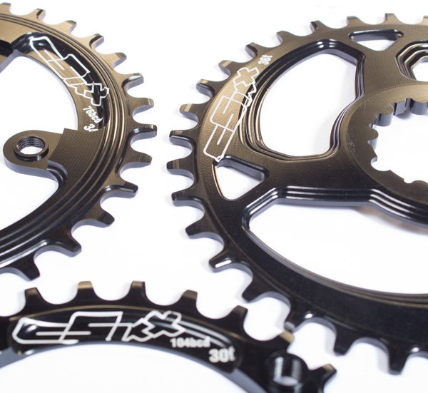

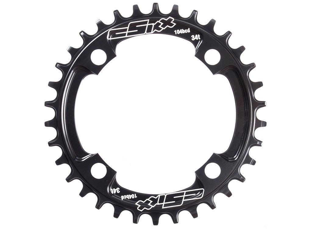

To go with the Super Single guide, cSixx offer a narrow wide (or Thick Thin as cSixx refer to it) chainring which caters for most of the ever-growing number of BCD and direct mount options.
Thick Thin Chainring specifications:
  • Material: 7075-T6 aluminium
  • Hard Anodized
  • Compatible for 10 and 11 speed.
  • Available in 30T, 32T, 34T and 36T

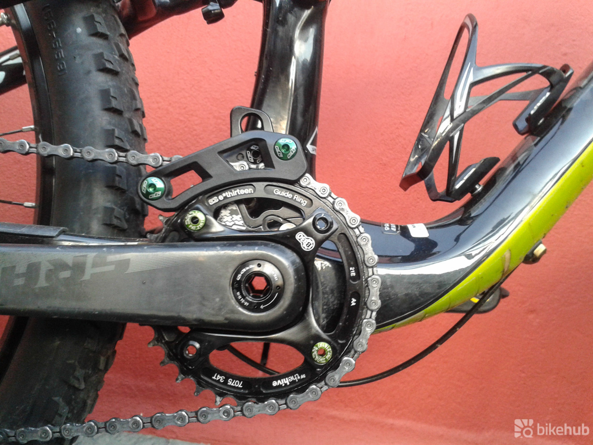

Setup 1: cSixx Super Single chain guide with a well used single ring (without any Narrow Wide features) and a non-clutch rear derailleur.
I ran this setup for sometime on my all mountain bike with great success, much to my surprise, as I was expecting the guide to lose the chain on a regular basis. The only time it did skip a beat was on longer, high speed descents with high frequency impacts where the chain would jump around out back like a sugar high kid at a birthday party.

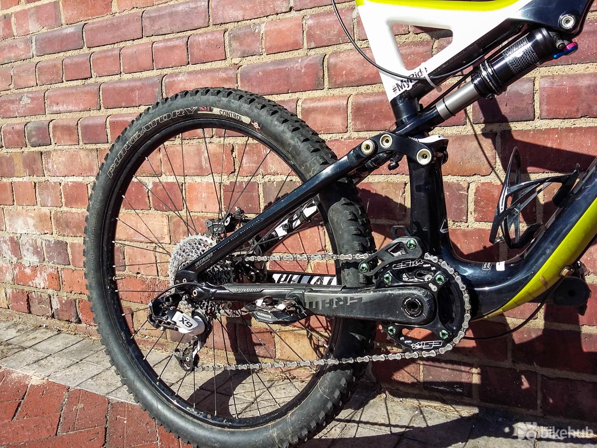

Setup 2: Later on, the single ring was replaced with a cSixx Thick Thin chainring, including lovely green anodized chainring bolts to match those on the guide. Who can say no to a little well placed bling on their bikes?
This setup has been a revelation for me. Previously, when the rear wheel slammed into the ground the chain would go wild, the cranks would back pedal and the chain would always come off. With the cSixx Thick Thin chainring fitted, the chain would still do its crazy chicken dance and the cranks would back pedal, but the chain would stay put on the narrow wide teeth. I am astonished at how effective this chainring is at keeping the chain secured.
On the trails the guide and Narrow Wide chainring setup (with a non-clutch derailleur) has not let me down once. I have ridden some rugged trails, at speeds where I have hit PRs and on fast bumpy sections where the chain would previously have come off. Being able to count on the chain retention, I’ve developed more trust in my drivetrain so that should I back pedal or want to accelerate out of a corner I can do so with gusto.

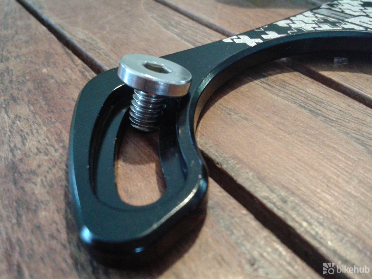

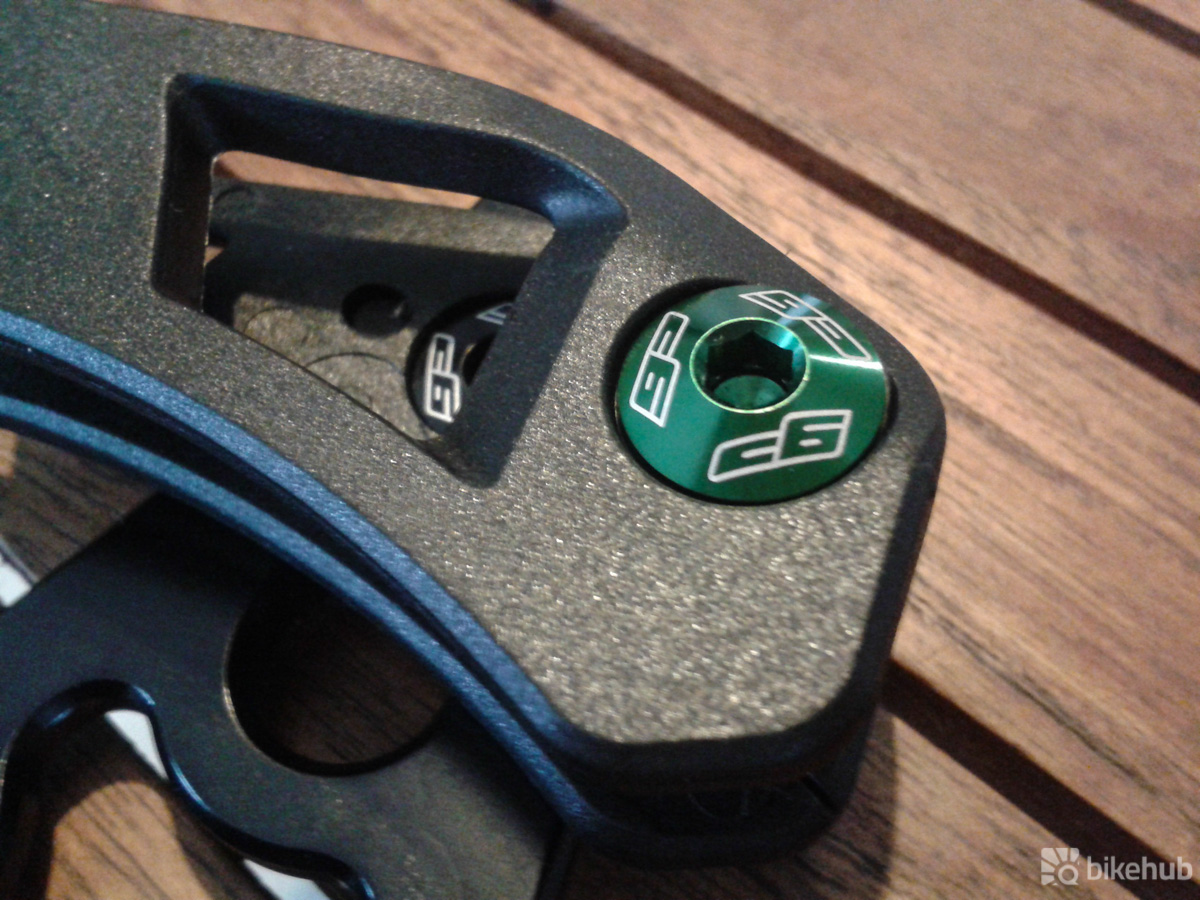

Both the cSixx Super Single guide and Thick Thin chainring are very well made and come with high quality stainless steel washers and anodized bolts. No cheap steel or soft aluminium cost cutting here.
The guide has been silent to use, incredibly easy to install and most important of all, the guide has been exceptionally reliable.

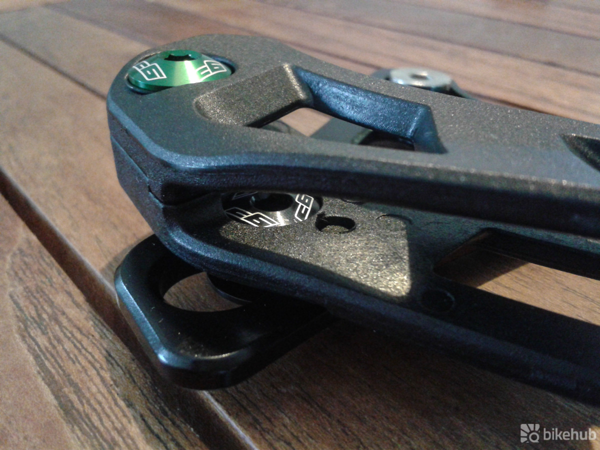

Fitting the guide is a simple procedure with the ISCG mount using a two bolt fixing system with the back plates having the lower section cut-out. Slide the guide over the crank, rotate to the correct angle and tighten the bolts. Adjust the guide up or down using the imprint of a chain on the inner face of the guide and you have perfect chain / guide alignment in no time.
Compared to other guides that I have previously used, I would say that the Super Single has been the easiest to fit and align.
Overall impressions: Thick Thin chainring
The Thick Thin chainring is very well finished, with a nice deep black anodizing that looks like it will wear well and graphics that are crisp and clean. The cSixx guys paid lots of attention to manufacturing quality during the development of this chainring, they went through a series of factories until they found a manufacturing plant that would be able to produce the quality of workmanship they are looking for. cSixx then took this one step further by sourcing a high grade aluminium from Europe to supply their manufacturers with in order to ensure that the final product meets their standards. This little snippet of information means a lot to me as a user.
