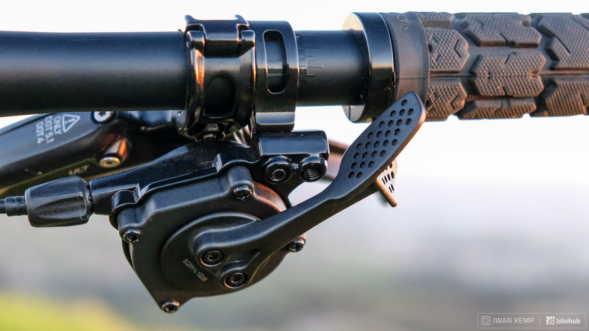

The most obvious change from the norm is the unique single-lever shifter which handles both upshifts and downshifts. Pressing forward on the lever shifts the drivetrain to an easier gear, and then pressing in on the lever with the tip of your thumb shifts into a more difficult gear. This will, however, change in their Generation 2 offering to a more standard two-lever shifter. Unconfirmed, but it seems there may be some intellectual property issues with the current shifter. Shifting to easier gears can be done four at a time, but only one per shift when dropping to harder gears.

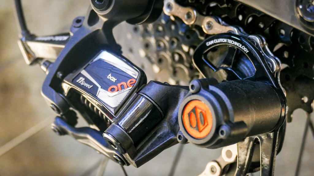

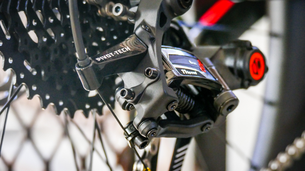

The rear derailleur comes with the now-common “clutch” tech. Box calls theirs “Cam Clutch technology,” and it’s always on and engaged. It lacks SRAM’s “locked” button that helps with rear wheel removal, though. It does have “Pivot Tech” which allows the derailleur to swing back when it suffers a hit, in an attempt to keep the derailleur or the hanger from breaking leaving you stranded mid-ride.

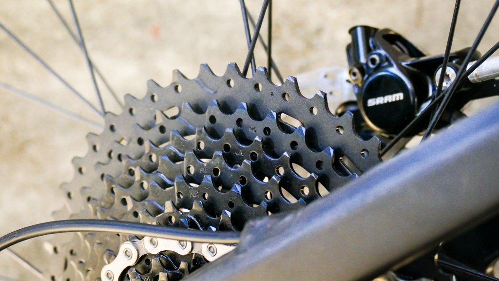

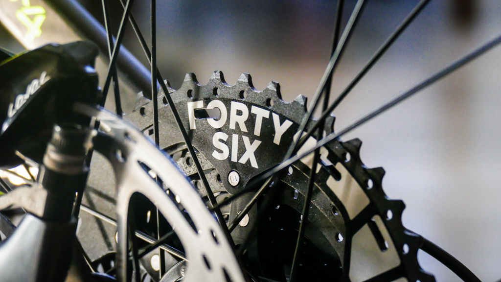

The Box Two cassette is made of hi-tensile steel and 7075-T6 aluminum, the 11-46T cassette features a 418% percent range. Two aluminum carriers hold the largest seven cogs while four individual cogs are separated with aluminum spacers and each cog features ramped teeth for improved shifting. The cassette is compatible with all major 11-speed chains and traditional MTB freehubs, but it is not compatible with SRAM’s XD driver. Claimed weight is 480g with the lockring.

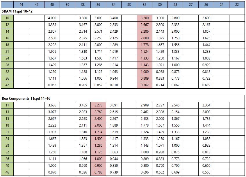

Ratio peeping shows a SRAM 11 speed 10-42T cassette with a 32T chainring can be quite evenly matched by Box’s 11-46T cassette using a 36T chainring.
