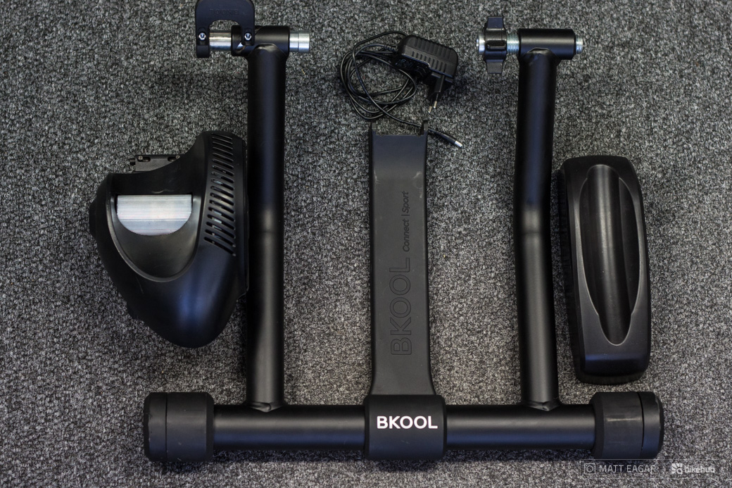

Set up
Getting started with the BKool Pro was incredibly simple. Out of the box, the resistance unit is detached from the foldable frame. Slider switches allow easy attachment of the two parts. Next it was a case of plugging in the power cable, installing the supplied quick release skewer and mounting the bike.

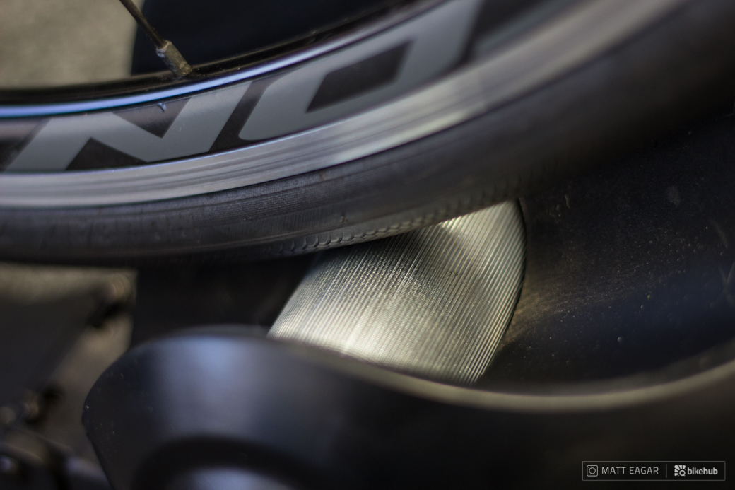

The wheel mounts to a typical clamp interface on the foldable arm. Unlike other trainers though, the Bkool doesn’t require any adjustment for the wheel or tyre size. Thanks to the swing arm design gravity does the rest to make sure your wheel is properly seated on the resistance unit.

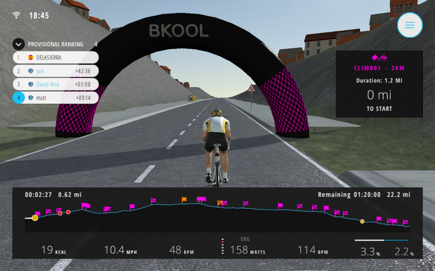

Connecting to the trainer was also easy enough via various devices. In the most basic mode, you can connect it to a power capable head unit or smartwatch (tested with a Garmin Fenix 3). The next step up would be the BKool app for smartphones which allows you to adjust the slope (resistance) while tracking power, speed, cadence and heart rate. The real attraction for a smart trainer though is virtual riding and ERG workouts, and here you really only have a few options; including BKool’s own simulator, TrainerRoad, SufferFest, or Zwift. I tested the trainer on BKool’s own software as well as Zwift. Both were intuitive and easy to set up using either ANT+ or BLE.

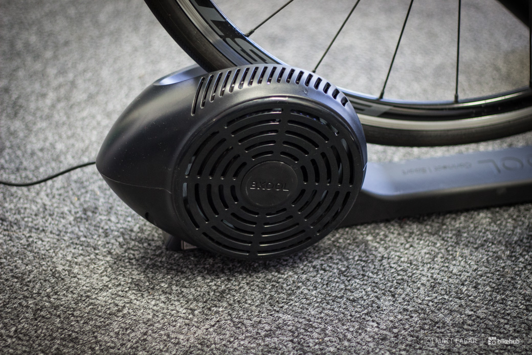

Once on the bike, the Bkool feels sturdy while in the saddle and is relatively quiet for a wheel-on trainer. The telescopic arms do a decent job of keeping the back end steady, while the front wheel block keeps the bike properly level. In simulation mode using both the Bkool simulator and Zwift the resistance response is good. While there is some lag between the on screen gradient change and the resistance response, it provides a natural feeling ramp up rather than any sudden changes.
Bkool advertise an interesting feature of the unit around its ability to simulate real world inertia. I was skeptical of this, especially given the relatively small flywheel, but testing it out on climbs in their virtual worlds there is a distinct difference in approaching a climb at higher versus lower speed, as you’d expect in the real world. The Bkool pro also does a good job of simulating inclines too. Throwing the bike up some twelve percent plus climbs felt painfully real.

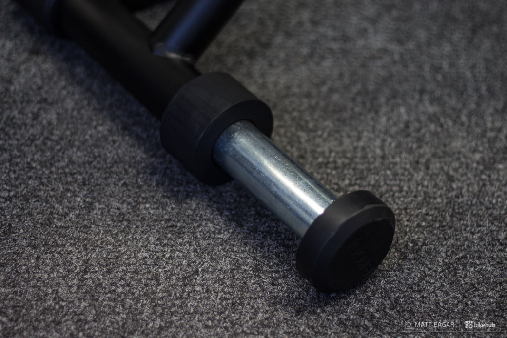

I did encounter some instability when getting out of the saddle on those really “steep” sections or during intense intervals. While the telescopic stabilisers do help to prevent a tip over, the unit appears to twist under the torque and with less weight on the back wheel it feels disturbingly unstable. Although I did find that putting the whole set up on a rug or carpet was a big improvement compared to a hard laminate surface, standing up was still precarious.

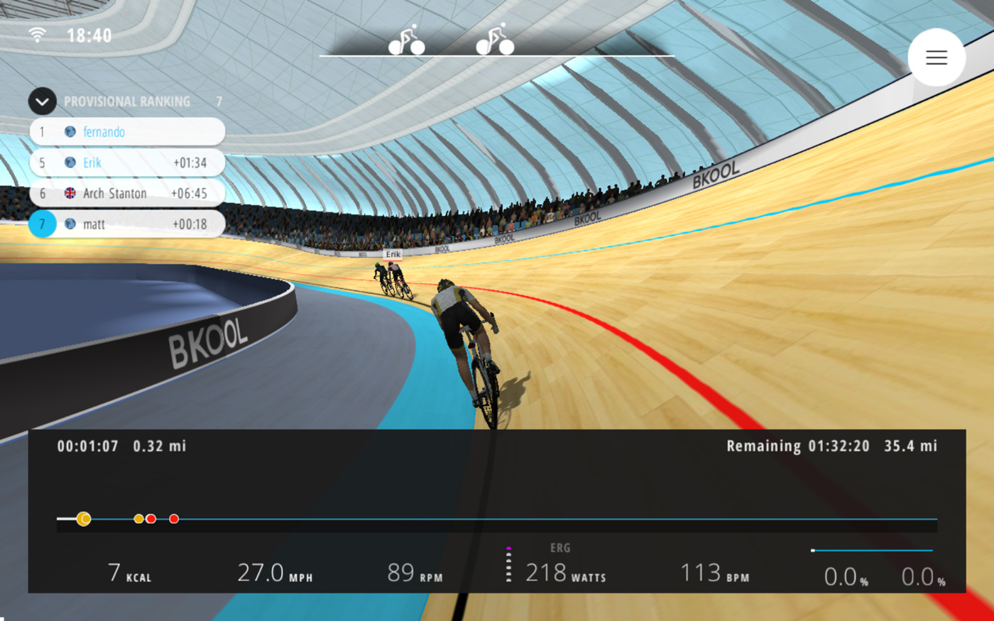

Cycling Simulator
While the emphasis of this review is more on the trainer than the software, it’s worth touching on my experience with the Bkool Cycling Simulator. With Zwift rapidly emerging as the darling of the virtual riding world, I did wonder why anyone would bother producing their own simulator. Although the Bkool virtual world doesn’t have quite the population that Zwift enjoys, they’ve built some impressive and thoroughly enjoyable elements.
The Velodrome mode is particularly fun and a refreshing change from the more common workout or virtual ride modes. In this mode you can take part in keirin, elimination and pursuit races against other riders in real time. It will be interesting to see how the simulator side of the Bkool business grows and evolves in time. It certainly shows promise with some innovative offerings.
For the full experience of their simulator you’ll need to subscribe to the premium version at a cost of 10 Euro per month, but in free mode you are able to test out the various modes with limited access to choose routes or workouts.
