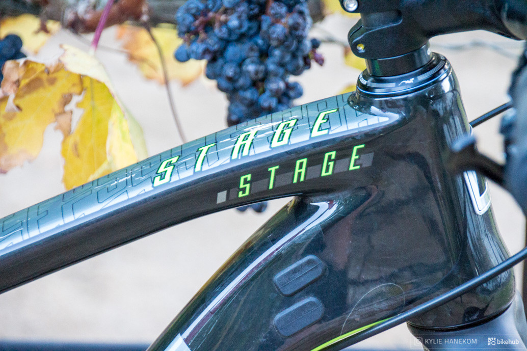

The Pyga Stage frame is an all carbon affair designed by South Africans with the specific needs of local racing firmly in mind.
At the time of its launch, the Stage was ahead of the curve in terms of geometry design. Cross-country bikes were one of the last class of mountain bikes to embrace the longer, slacker geometry trend. Since then, many large brands have found the courage to take the leap. Pyga’s vision was to create a stage racer with confidence inspiring angles so that the average rider (you and I) could be more confident and comfortable on a bike while still capable of racing endurance events.

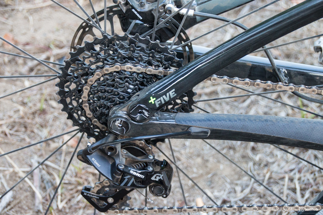

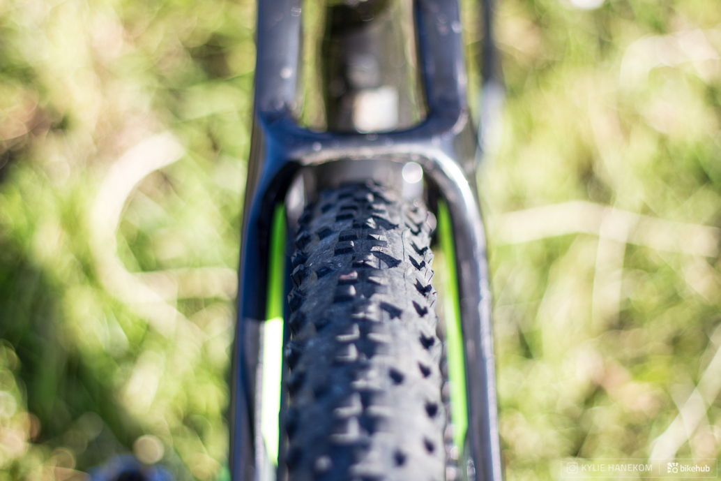

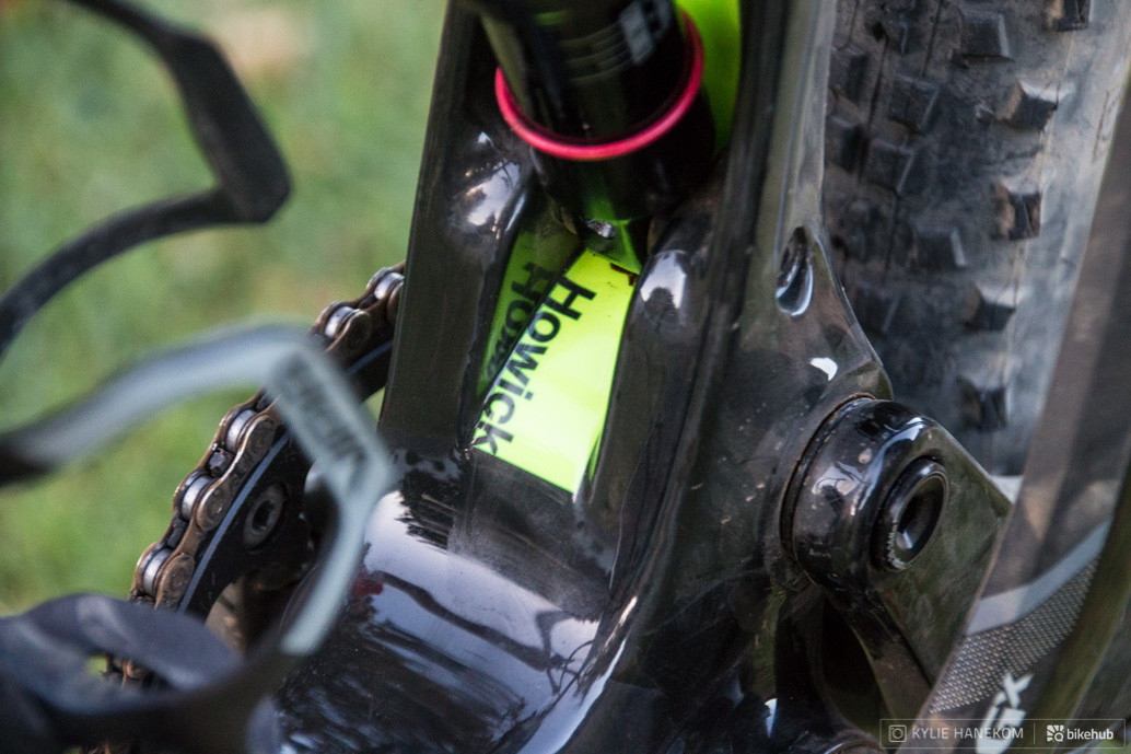

Looking back, the Stage launched at a tricky time for bike designers. The Boost hub axle spacing standard had yet to be widely adopted. Pyga made a decision to stick with the 142 rear axle spacing but with the implementation of Plus Five. Plus Five re-engineers the rear end to correct what Pyga sees as a flaw in bikes: the chainline offset. What they have done is offset the whole rear end of the Stage by 5mm on the drive side and in doing so reducing the chainline offset from 49mm to 44mm. The result (simply put) is better shifting thanks to a more centred chainline and a stronger rear wheel as the spokes can be more evenly dished.

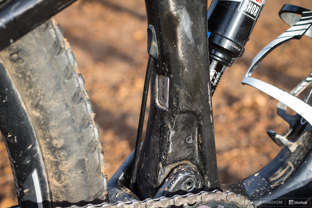

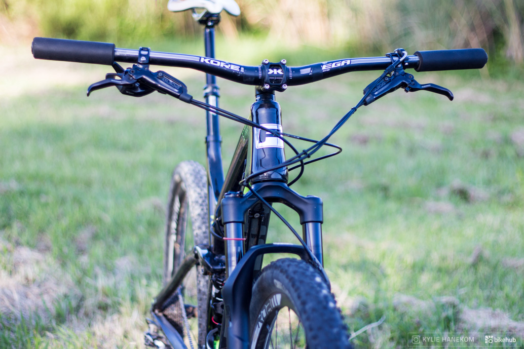

There is provision for a combination of internal and external cable routing. I have the brakes going externally with the rear derailleur running internally, popping out at the bottom bracket area briefly before entering again at the chainstay. My dropper post followed the brake hosing down the underside of the down tube around the bottom bracket and into the seat tube after the shock mount.

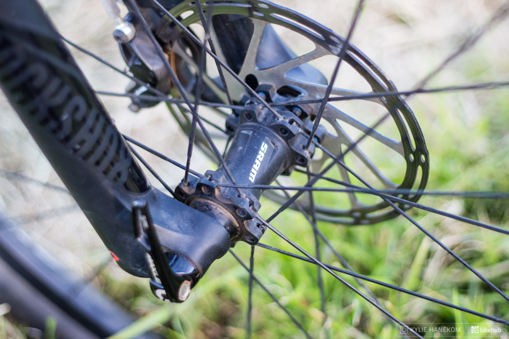

The new RockShox SID RLC, with the Charger damper technology used in the Pike, has been a revelation. The changes to this latest iteration have resulted in a fork that is set and forget, providing smooth and reliable travel.
The SRAM Guide RS brakes have been known to struggle in the South African heat, but the set on the Stage have proved to be reliable. On one occasion, they required some cleaning to get the piston to reset correctly.

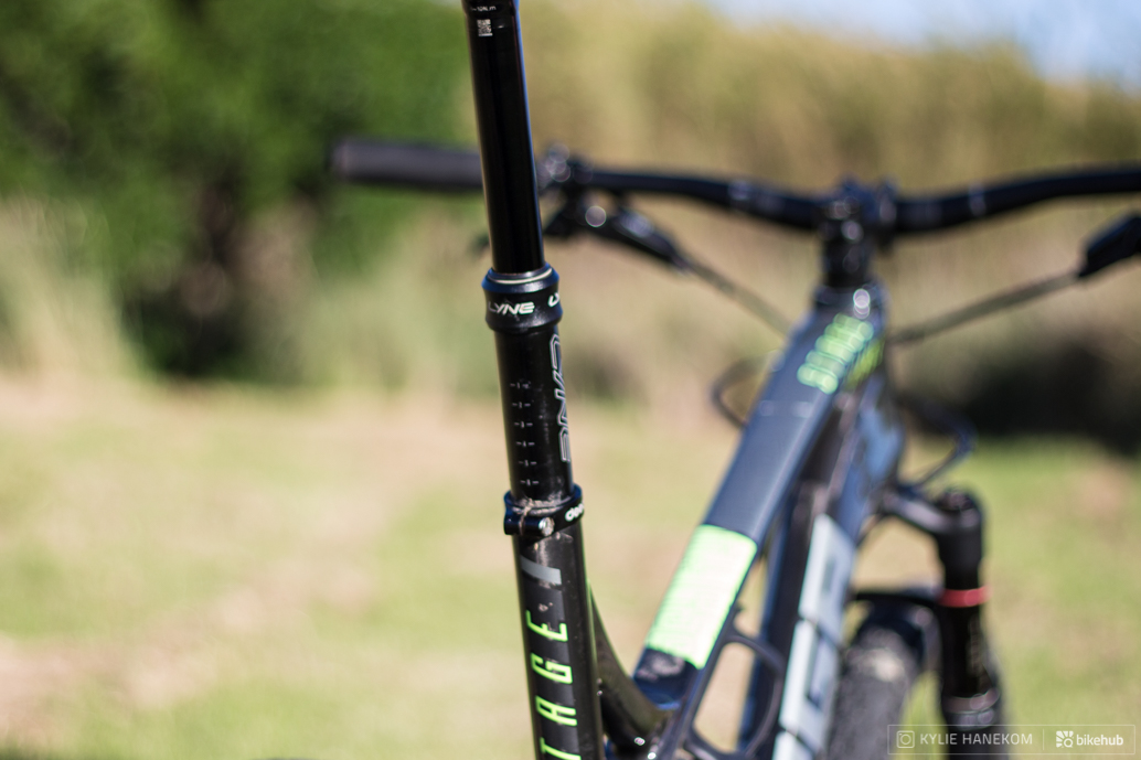

I’m dependant on a dropper seatpost to pilot a mountain bike over anything but the most manicured trails. I’ve tried re-adapting to a rigid seatpost but I simply cannot descend comfortably with a saddle in the way. As the GX-build Stage arrived with a fixed Kore seatpost, I swiftly ordered a Lyne Contour dropper seatpost to replace it. I easily routed it through the port in the seatpost and under the bottom bracket. The cable path does mean that there is rub on the bridge connecting the chainstays. I simply placed a protective pad to prevent any harm to the carbon frame.

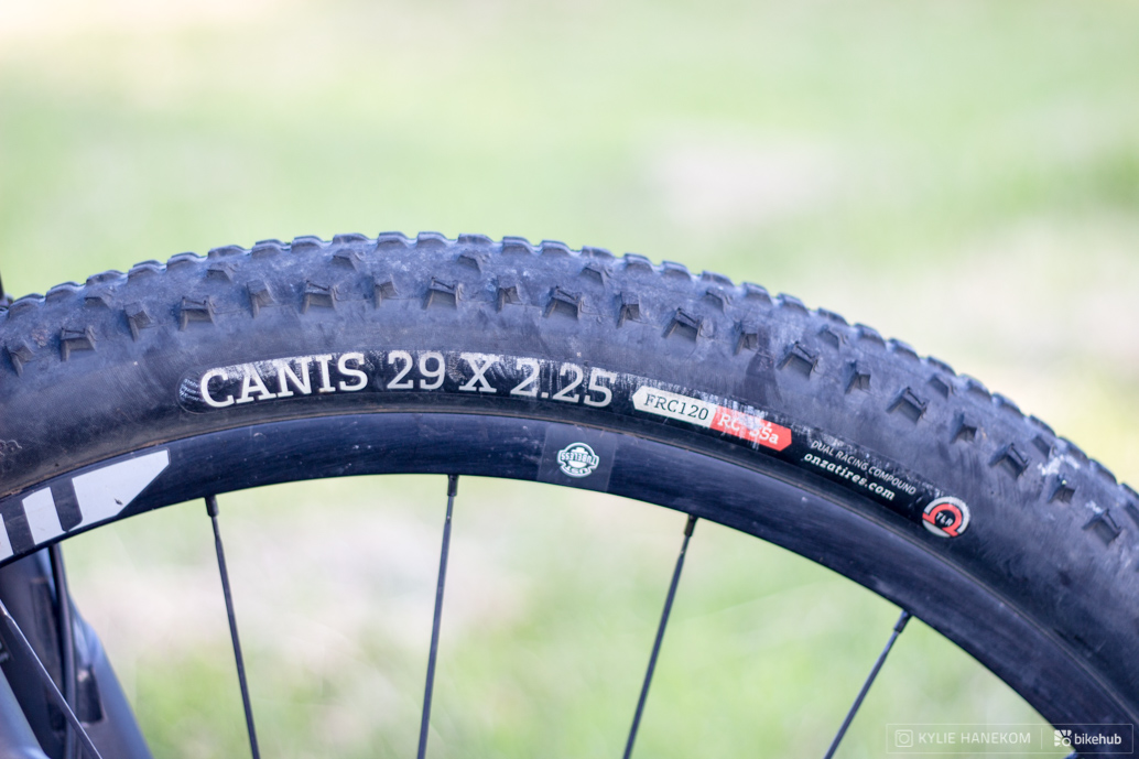

I made use of two sets of tyres, Specialized’s FastTrak and the Onza Canis tyres that the bike arrived with. The Onza Canis tyres deliver a bit more grip which better suited my riding style and the bike’s capabilities.
After a few hours in the saddle, my hands and the RaceFace Half Nelson grips generated friction. Although not a huge issue, the prospect of long days at Cape Pioneer Trek finally got me to change them for a pair of Supacaz Siliconez XL foam grips. While we’re talking comfort, I also tested the Spirgrips for a couple weeks on the Stage.
Finally, I tested SRAM’s GX Eagle drivetrain with the Stage. A straight swap with the 11-speed GX system already on the bike. The larger cassette range meant that I could upsize the chainring to a 34 tooth chainring. The 34 tooth chainring is apparently a sweet spot for the bike’s anti-squat (which is designed to accommodate a double chainring drivetrain), in theory, making it a more efficient climber.
