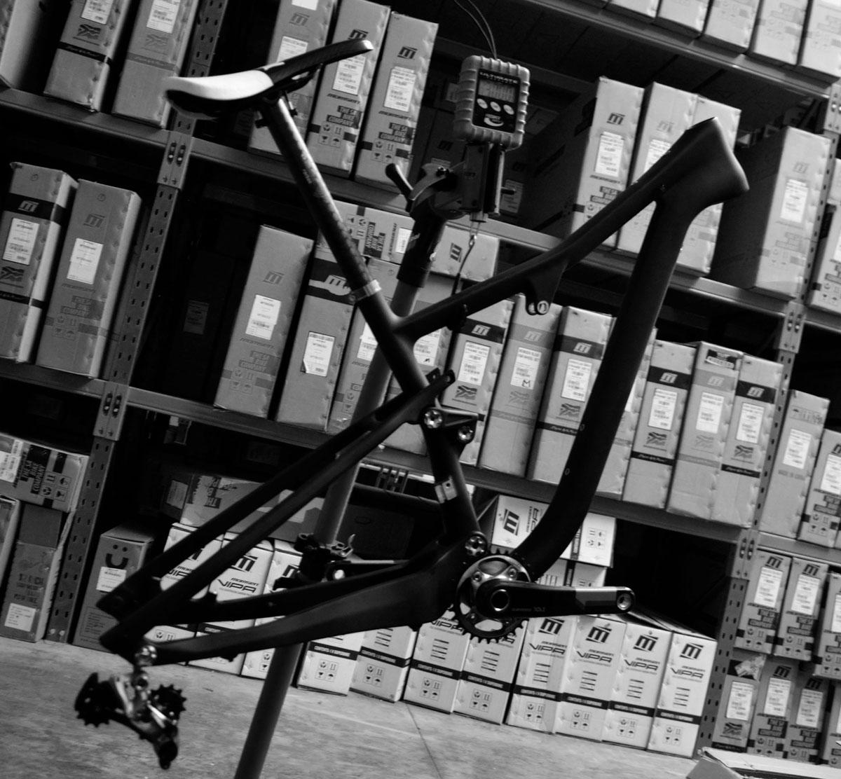

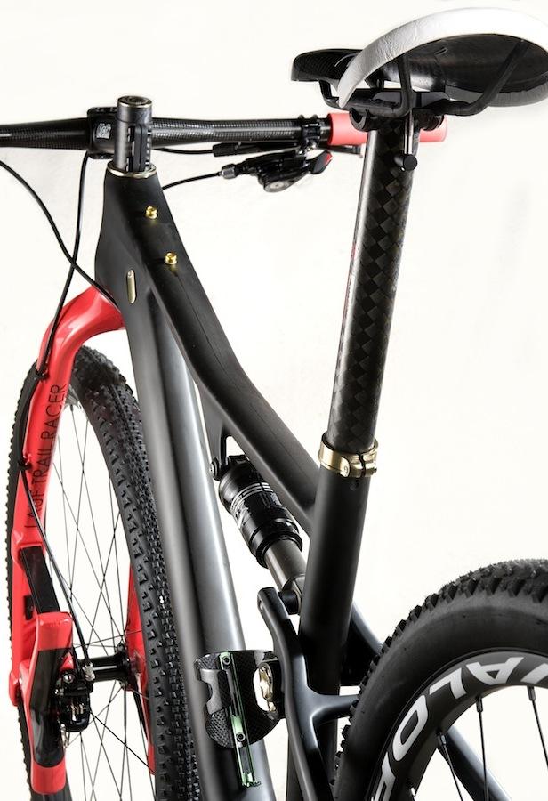

This three-part series by the bike boffins originated with a clean sheet and boxes of special toys from the world’s best component manufacturers. The clean sheet also extended to the clean, all-black Medium VIPA frame without decals and paint: murdered out, it saved 40 grams!

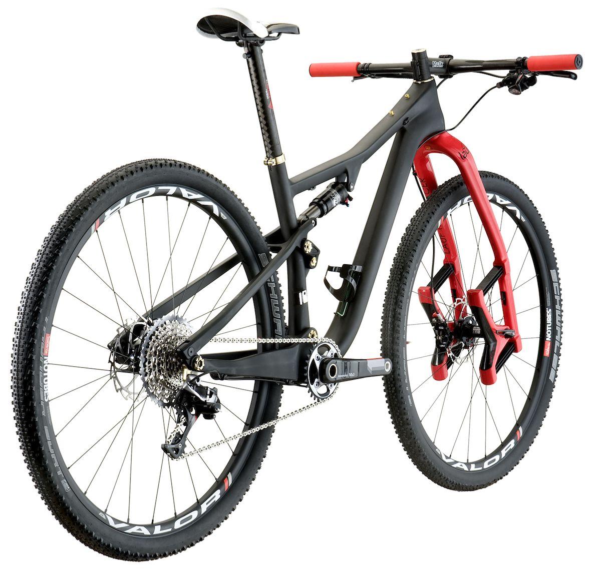

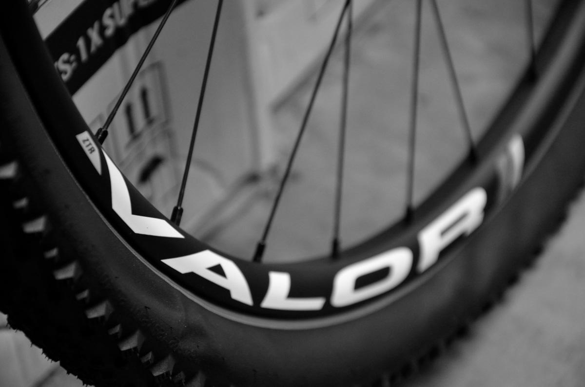

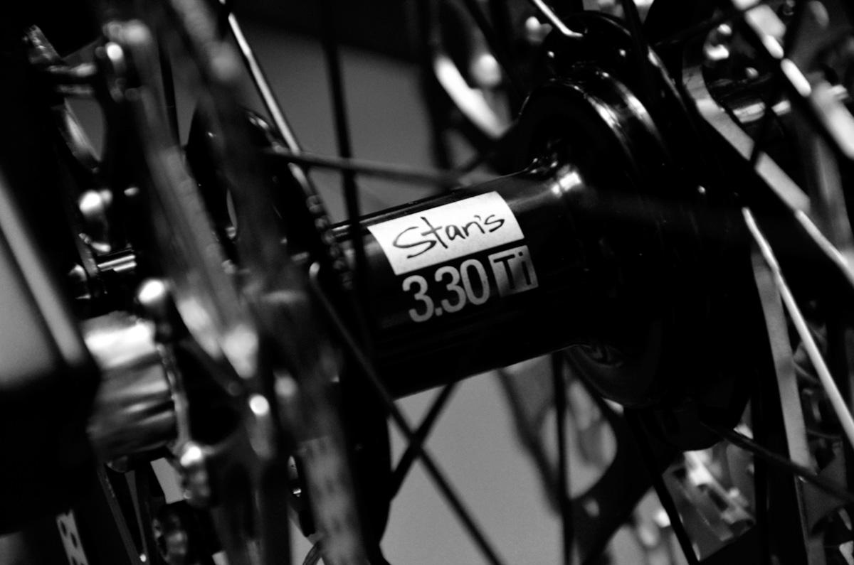

Their first build was one aimed at the weight weenies. It tipped the scales at just 8.35kg, without pedals but with a water bottle cage nogal, with trick carbon bits from Schmolke, Tune and MCFK, as well as the new Stan’s NoTubes Valor carbon wheels.

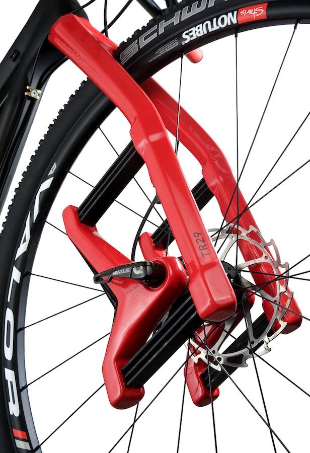

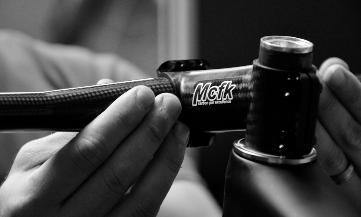

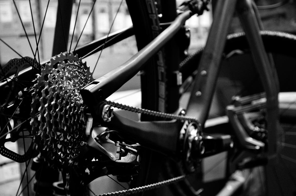

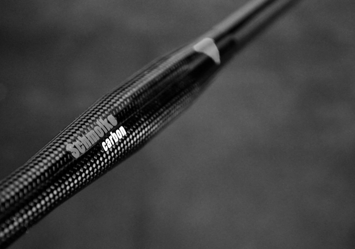

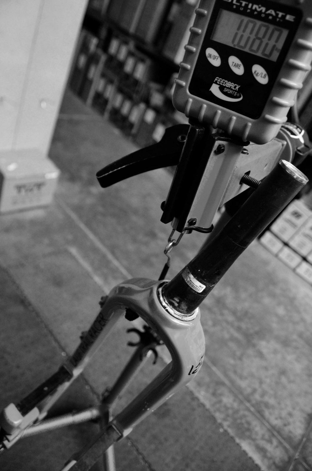

The unique and controversial Lauf Leaf 29er suspension fork does duty upfront, with the lightweight properties of this radical carbon fork used to good effect on the VIPA. An efficient short travel rear suspension design offers 80mm of travel with a low leverage ratio for the Fox rear shock. The guys dropped a complete SRAM XX1 drivetrain onto the bike with a trigger shifter instead of gripshift, and a KMC X11SL chain. On the Schmolke carbon seatpost was affixed a Tune carbon saddle – which is not as uncomfortable as its looks may suggest. An MCKF stem (all very beautiful in carbon) was mounted with a Schmolke flatbar that weighed just 80 grams. Rounding out the trick bits was a prototype water bottle cage and Momsen Design Silicone Race grips.
The result? A 8.350 kg full suspension bike!
The cost of this build can be worked out with the help of Google, but that’s not the point of this article. Radical? Actually, not. This Project BLACK build is rideable on some rough trails and makes light work of any climbs. Versatility is the Momsen Bikes’ VIPA’s trump card: this is just one of the three personalities of the VIPA. Ready to race; ready to shred; ready to hack it with your mates on your favourite trails or destroy your Strava KOMs. It is easier to define it than that: ready to ride!

Do you Know if we will be able to Purchase this bike or is it just a Prototype?

Why no Kashima Fox shock?
And whats up with those spacers ontop of the stem? Looks like a quick Friday night build...

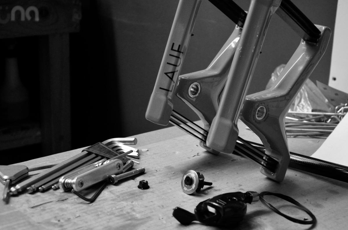

what is all that stuff on the front fork ?
Headshot
Aug 20, 2014, 12:07 PM
Rubber bands?

Service on that front suspension should be a little less than a specialized +R2000 fork service I hope

I wonder how that front fork feels and performs.

The bolts on top of the top tube? attach a co2 bomb holder?
concession made for internal routing but not used?
routing of the front brake hose on the fork may end in tears?
picture of a guys eye?
best bike for dirtroads ever?
maybe i should ride it first before i comment?

Please explain to me, in simple terms, how that fork works.
Louis for real
Aug 20, 2014, 2:18 PM
not like a "normal' one? :)
Helpmytrap
Aug 20, 2014, 2:30 PM
http://www.laufforks.com/
Helpmytrap
Aug 20, 2014, 2:34 PM
PS, the fork is ZERO maintenance.
Leaf Springs
http://www.laufforks.com/img/LTR/BumpStop-Still.gif
The heart of the Lauf Trail Racer is the leaf springs - we call it the Lauf Spring System (LSS). The LSS is made of high-performance composites, which are shockingly flexible and very impact resistant. There is no friction in the leaf springs as there are no moving parts. Therefore the LSS is energy effective and feels equally at home on rough trails or cobblestones, without the need for a lock-out function.
Travel
http://www.laufforks.com/img/LTR/Travel_Thumb.jpg
The Lauf Trail Racer has 60mm of travel with progressive spring rate. The initial part of the travel is the softest and most sensitive as it moves slightly backwards.
The mid part, and the longest, is almost linear for great handling and comfort while filtering out larger bumps. Towards the end the suspension stiffens up to prevent the Lauf Trail Racer from bottoming-out harshly and help keep all carbon parts safe.
Helpmytrap
Aug 20, 2014, 2:39 PM
http://www.laufforks.com/img/LTR/BumpStop.gif
Piston ZA
Aug 20, 2014, 2:46 PM
http://www.bikeradar.com/mtb/news/article/lauf-tr29-forks-video-review-42120/
Probably not, the bike is a once off concept build.
The rear shock used was apparently lighter than the Factory Kashima they had in the workshop. Being a weight weenie build, they went with the lightest option.
The fork is on loan from Mannie's Bike Mecca in Namibia. So cutting the steerer wasn't an option unfortunately.
