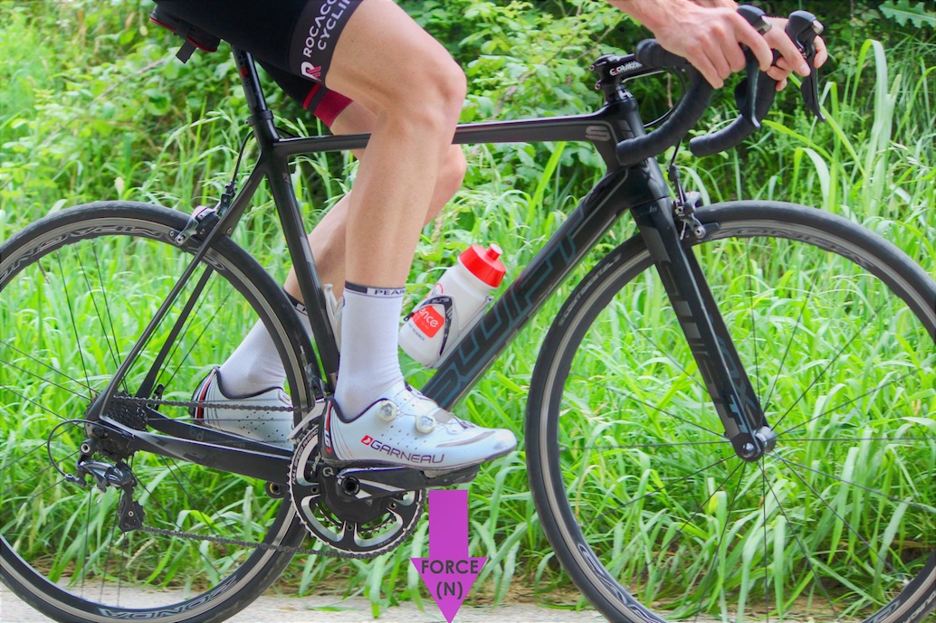

Figure 1: Torque (Nm) is the product of the force (N) applied to the pedal, multiplied by the distance of the lever arm (m), which in this case is the crank length.

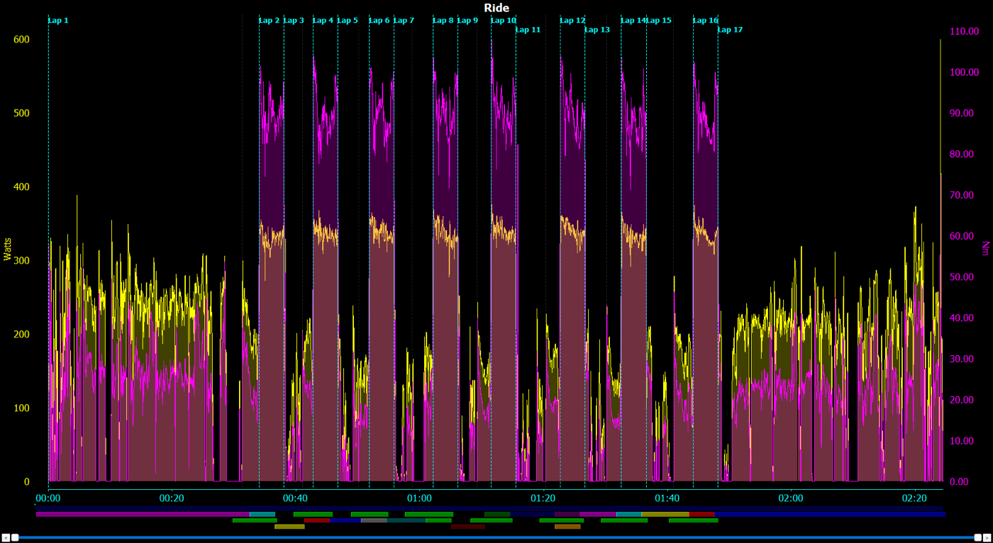

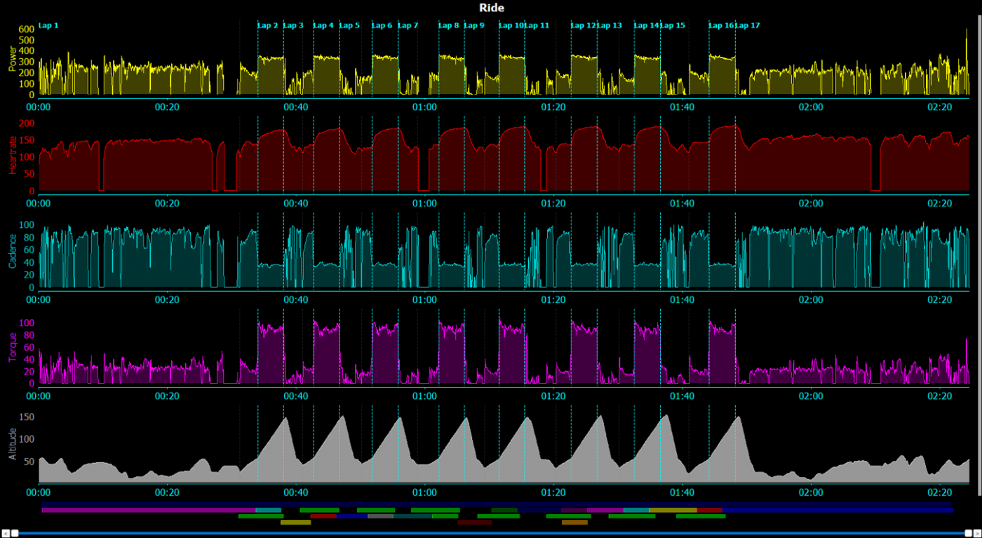

We recommend that you try and use the same hill/gradient for each interval, because this will provide you with consistent data to analyse. Figure 2 is an example of a torque session performed by one of our athletes. Each interval of the session was performed on the same climb which made the intervals a lot more consistent and analysing the session a lot easier.
Figure 2: An example of an 8 x 4 minute torque session
The outcome of this workout should be the amount of torque (Nm) produced in each interval, and not power output (W). Lowering the cadence (selecting a harder gear), increases the force that is applied to the pedals which will increase the torque (Nm) produced (Figure 3). The relationship between torque and power output will be different during these intervals compared to your usual high-cadence efforts. This is also illustrated in the warm up and cool down periods in Figure 3.
Figure 3: The relationship between torque and power output. During periods of high cadence (warm up and cool down), where easier gears are used, torque is low compared to the low cadence (hard gear) intervals.

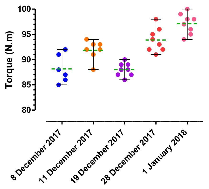

A great way to track your progression during the ‘General Preparation’ block is to analyse these sessions, and plot the torque values for each of the 4 minute intervals, add them all together and divide by the total number of intervals (6 or 8 depending on the session). This will provide you with the average for the set of intervals. The graph below shows how we plot an athlete’s progression during their block. The first two sessions went well, but the third session shows a decrease in the amount of torque produced. The drop in torque was most likely due to some acute fatigue, so we allowed for a slightly longer rest before the next session and they were able to produce their best numbers in the two subsequent sessions.

Figure 4: Torque progression of an athlete
