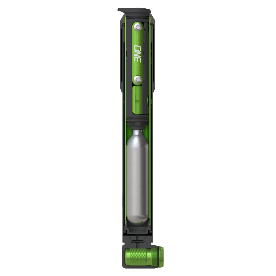

EDC stores your essential trail tools inside your steerer tube, right at your fingertips. Whether you’re going out for a quick lunch ride or setting off on a longer adventure, EDC has the tools you need to fix almost any trailside mechanical.
The EDC tool can also be stored inside one of our new high volume CNC Aluminum Pumps with water bottle mount. Grabbing your EDC tool from the pump is as easy as reaching for your bottle.

• Sealed Storage Capsule or 12,16, 20g CO2 Cartridge Storage

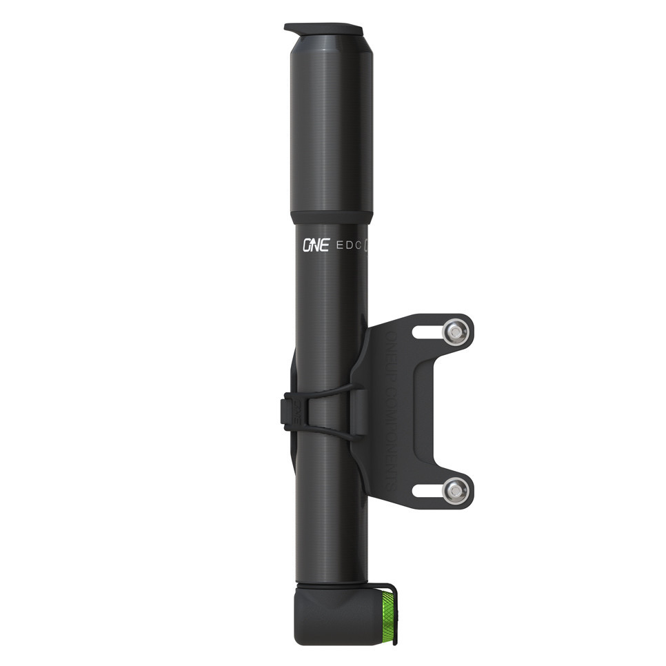

EDC Pump Spec
• 2 Sizes: High Volume 100cc – 246mm length & Compact 70cc – 195mm length (shorter than a 22oz water bottle)
• 100cc Pump holds EDC Tool & a 20g CO2 or EDC Tool & the Storage Capsule
• 70cc Pump holds EDC Tool or a 20g CO2
• Fast-On Head (Presta only) – No threads or locking levers
• Integrated CO2 Inflator head
• Fully Sealed, Weatherproofed Internals
• Bottle Cage Mount
