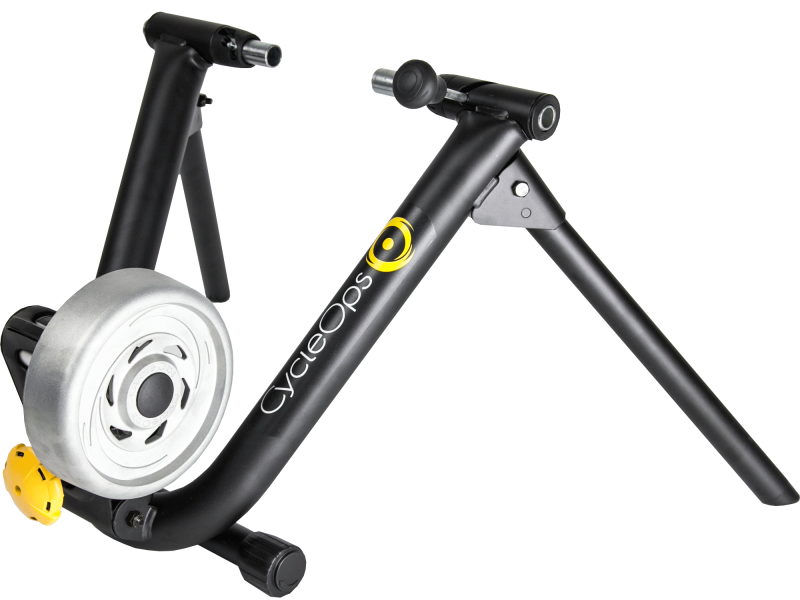

The CycleOps PowerSync is an indoor trainer with an onboard power meter to accurately measure your training efforts. The trainer is operated by your iOS or Android device via the VirtualTraining software. We’ll be buzzing away in the early mornings of winter to bring you a full review of the PowerSync trainer and VirtualTraining software in July.
Assembly
The instructions to assemble the PowerSync left me a bit puzzled but I managed to put it together without much fuss. I had the trainer up and running within 10 minutes of unboxing.
To attach your bike to the trainer, you need to use the supplied QR skewer. The PowerSync is designed for rear axle spacings of 120, 130, and 135mm. The PowerSync is compatible with 650b, 700c, 26″, and 27″ wheel sizes but not 29ers or 650c sizing. If all you have is a 29er, then you’ll have to go for another CycleOps trainer like the PowerBeam Pro which supports the larger wheel size.
Features
The PowerSync stand is a familiar A-frame structure. A built-in PowerTap power meter sensor promises accuracy within 5%. The main unit is designed to communicate with devices through ANT+ or Bluetooth Smart (not both), so pick wisely.

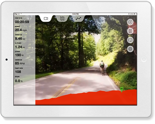

The neat thing about this electronic trainer is that the resistance can be controlled by software, allowing for the simulation of various route gradients or training programme intensities.
The CycleOps VirtualTraining comes with pre-existing and user generated training programmes and routes (some with video of the road ahead). You can even compete against your friends and strangers. A number of Hubbers have already been using the VirtualTraining software. Read about their experiences here.
The CycleOps PowerSync retails for R11,595.

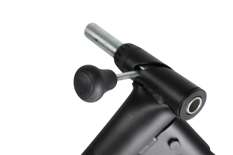

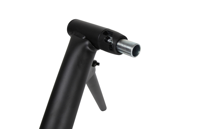

Hi all, just to be clear, the PowerSync (which makes use of the classic series trainer frame shared by the CycleOps Fluid 2) will accommodate 29" wheels, the concern is the size / volume of the wheel, wheels below a 2.1" will have clearance above that the tire will make contact with the ground, all that is needed is to raise the trainer, maybe some tiles inserted under the trainer feet will help....
here are images as to what i am referring to.
