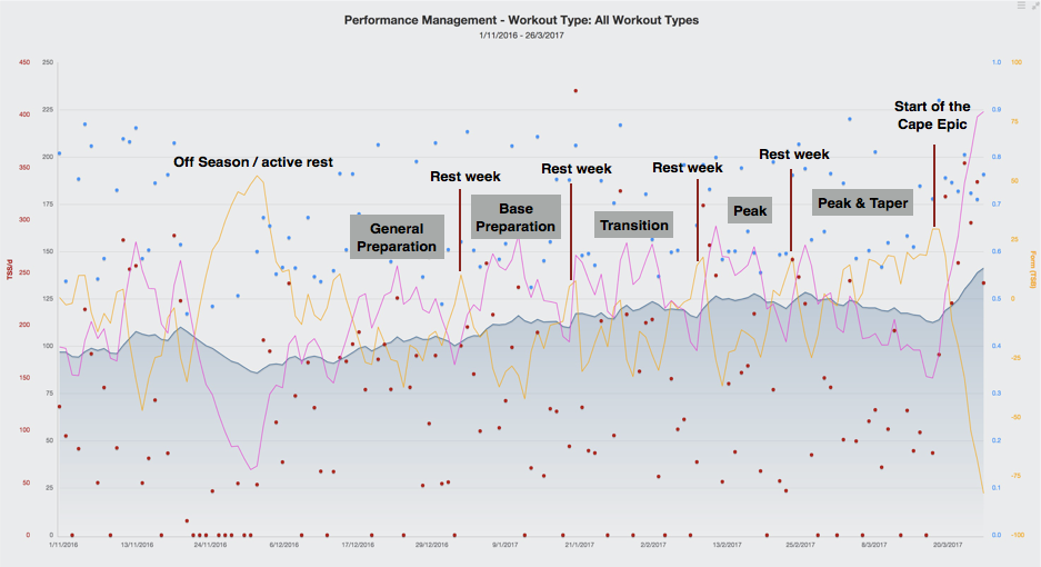

3. Interpretation of the performance management chart
A performance management chart is a longitudinal graph showing CTL, ATL and TSB over a selected period of time. As shown in the figure below, the blue line (CTL) may be visualised as your fitness. The pink line as you fatigue, and the yellow line (TSB) your freshness or readiness to perform.
Athletes and coaches often make the mistake of over-interpreting this model as direct measures of the simplified terms they are defined as; fitness, fatigue and freshness. In reality, performance is extremely complex and there is currently no model, which may account for all possible factors contributing to human variance.
There is no doubt that athletes with relatively low cardiovascular fitness levels will improve their performance as CTL is increased. The problem lies in that there is no direct means of determining the correct CTL for an athlete without prior training history and training data. Optimal CTL values may vary from 70 TSS/day, for some competitive age group athletes, to as high as 140 CTL for pro tour riders. The best way to establish your optimal load is simply by continued performance monitoring. As you increase your CTL, ensure that performance continues to increase. If your performance is stagnating, or even decreasing, this may be a sign that you have surpassed your optimal CTL range.
Similarly to you CTL, optimal TSB is also highly variable. A certain athlete may perform better with a TSB in the range of +10 to +20, whereas some simply feel better at a TSB of -5 to +5. Again, correlating previous excellent performances with TSB on that particular day is one of the most effective ways in which to ensure the correct TSB for peak performance.
4. Practical aspects of the performance management chart
It is critically important that you monitor adherence to your periodised training plan. Here is an example of an athlete preparing for the ABSA Cape Epic. Throughout the process, training load was very closely monitored to ensure that the intended training load was correctly applied, and importantly, that the objective of each rest week was achieved. When evaluating your periodisation plan, ensure that each block or phase of training results in adequate stress. This can be seen as the ATL being greater CTL. This can be seen as the periods where the pink line is above the blue line. Very importantly, between your blocks of training is when the athlete becomes “fresh”. Ensure that their training stress balance, or TSB, which is the yellow line spikes into positive values.
