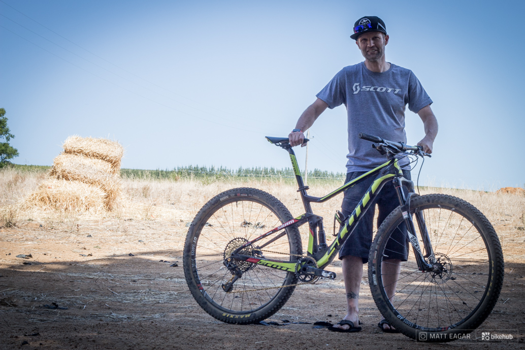

Rene Krattinger is the mountain bike product manager for Scott Sports, responsible for guiding the development of the new Scott Spark RC. Piloted by the legendary Nino Schurter and Jenny Rissveds, the new Spark has already been decorated with Olympic gold medals, World Cup gold medals, and even Absa Cape Epic gold since its announcement in time for the Rio Olympics in June 2016. We chatted to him about the design process, and what it takes to develop a bike of this calibre.

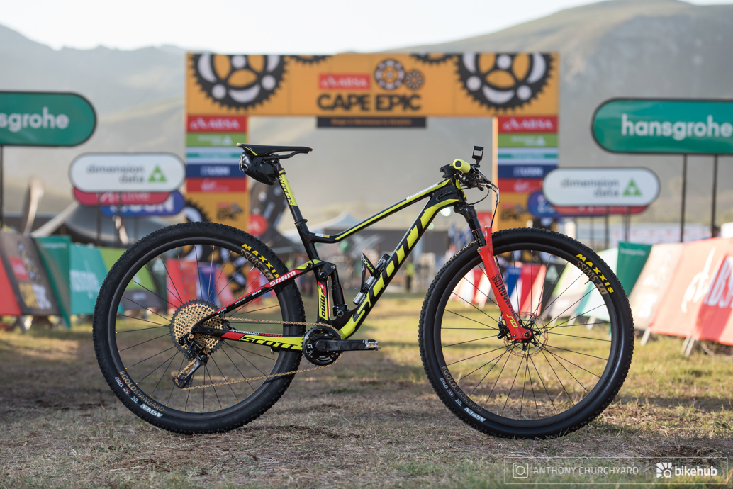

ccs-58780-0-94395100-1498488331.jpgThe Scott Spark RC that Nino Schurter rode to victory at the 2017 Absa Cape Epic. You can view the full bike check here. Photo credit: Anthony Churchyard

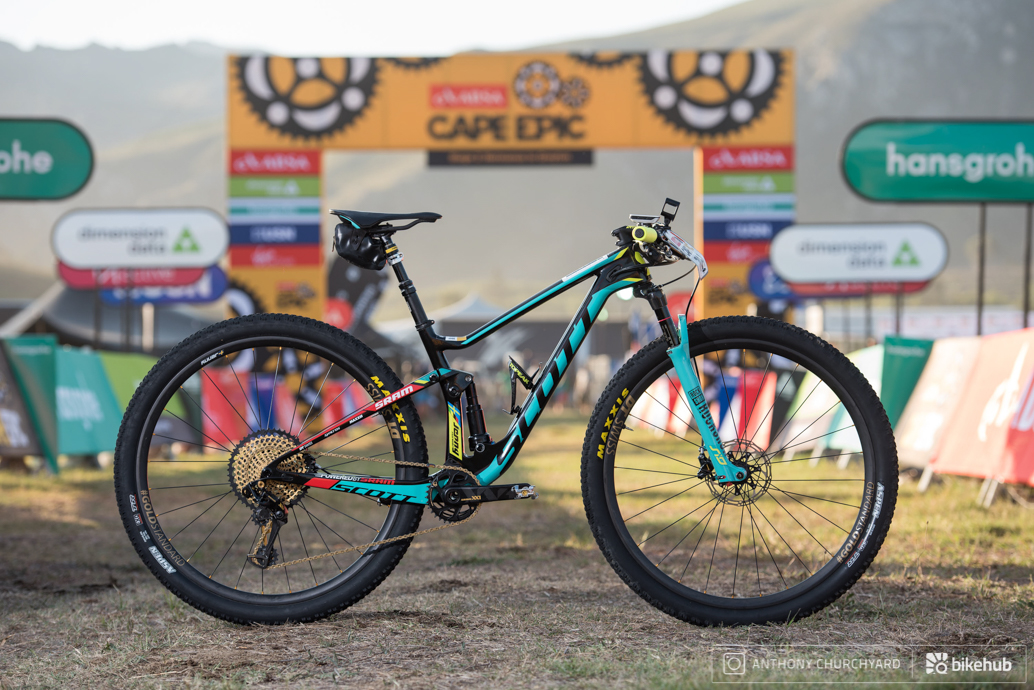

ccs-58780-0-30876200-1498488589.jpgThe Scott Spark RC that Jenny Rissveds rode to victory in the mixed category at the 2017 Absa Cape Epic. You can view the full bike check here. Photo credit: Anthony Churchyard
