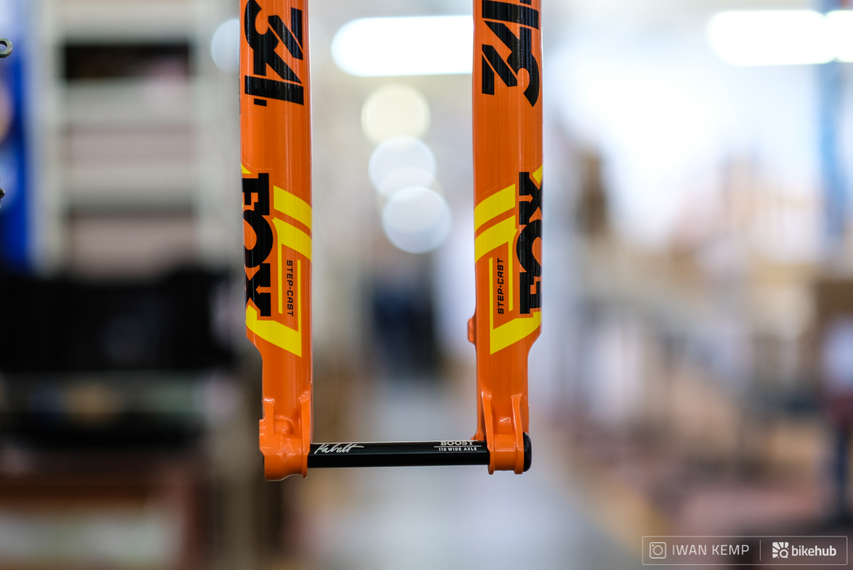

Okay, not that bad, but you get my point. Fox has since launched the 34 (with a 34 mm chassis) to bridge the gap between the XC focused 32 and Enduro monster 36, and it makes all the difference. With the 34 Step-Cast, they have spent all their time, effort and R&D to optimize the fork around 120mm and 120mm only. No, you can’t increase the travel, that will bring on the flex in the chassis. To stop the flex, they would have to add weight again. Fox had a focus with the 34 Step-Cast and they stuck to it.

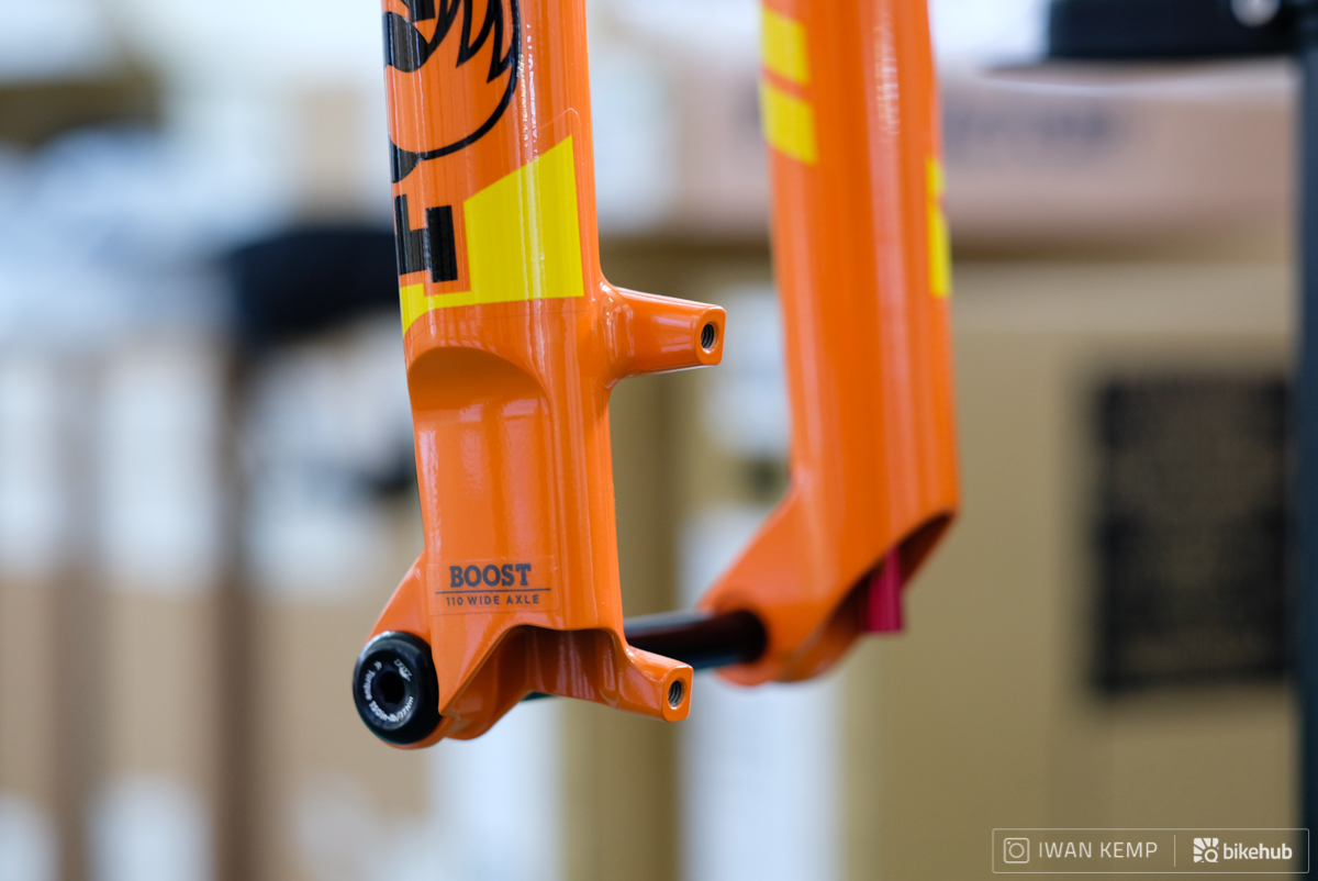

Although both the existing 34 and new 34 Step-Cast share the same crown, steerer tube, and adjusters, the 34 Step-Cast comes with a completely new chassis. Compared with the existing Fox 34 Float, the Step-Cast model sees lighter upper tubes, new internals and lowers with the “step” in the casting near the dropout. The floor or bottom of the Step-Cast design sits higher up in the lower leg, which not only saves weight in the lowers by allows for the step design. It also shortens the upper tubes, air spring, and FIT4 damper which further adds to the weight saving over the standard 34 Float.

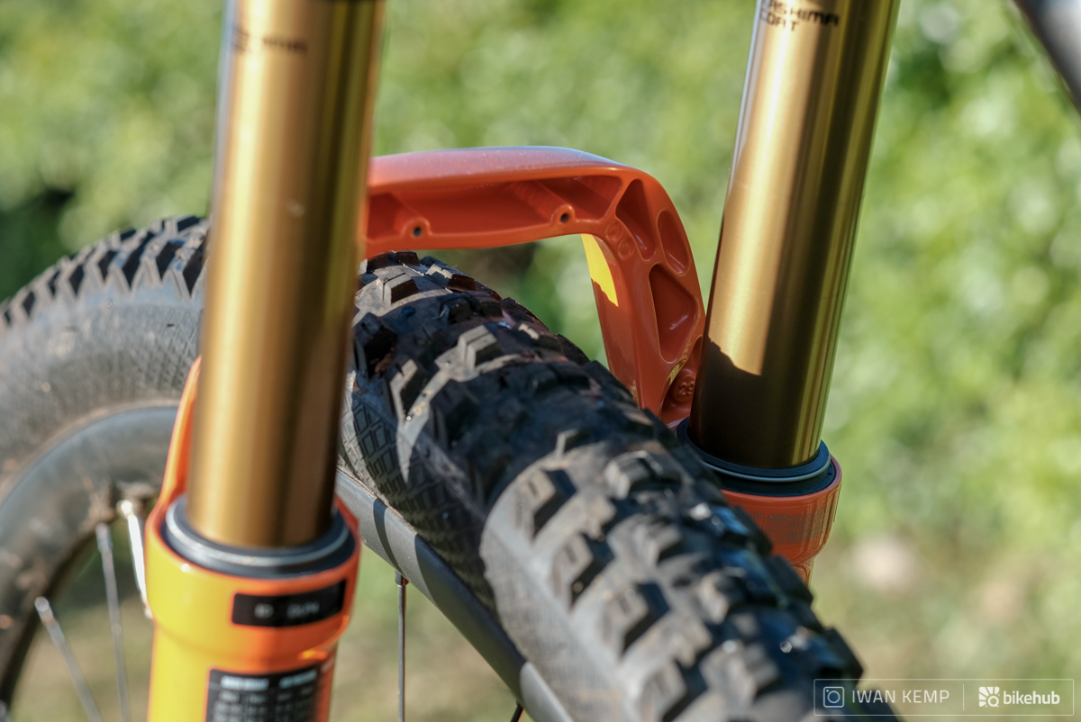

The fork comes in 27.5 and 29″ wheel sizes, both with 120 mm travel. The 27.5″ chassis fits up to 2.8-inch tyres, while the 29″ can take up to 2.6-inch tyres. will be available with both a crown-mounted three-position damper control and a handlebar-mounted remote lockout lever.

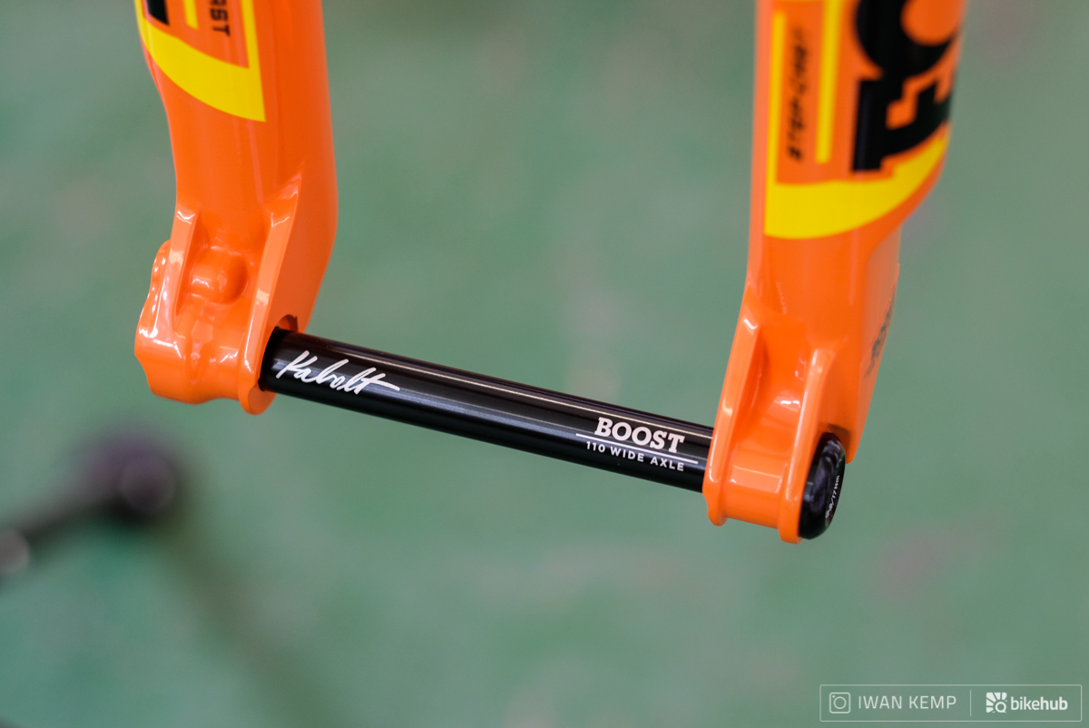

  • Dropouts: 110x15mm

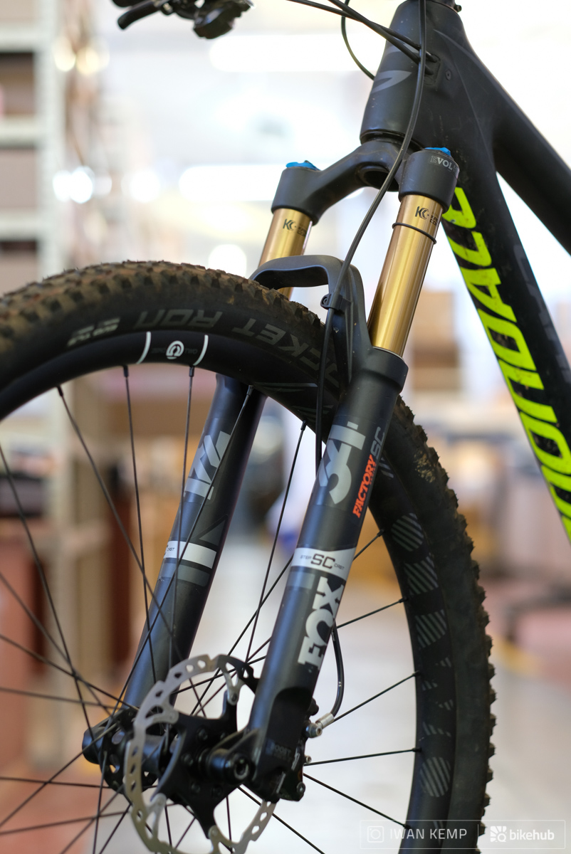

First it should be said that the fork we had on review belongs to Fox’s South African brand manager, Steve Bowman. Those (who are older than me) will know that he is no stranger to the ways of a bicycle and it showed with the set up of the fork and the bike that it came on. It brings me pure joy when we get a bike to review that doesn’t have to go through the initial set up phase that takes up valuable riding time. And even though I had to change the suspension settings a bit for my weight, it was easy to do as the fork was already bedded in and running silky smooth.
