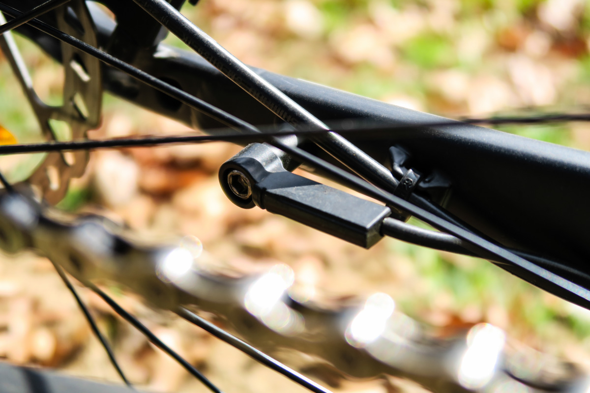

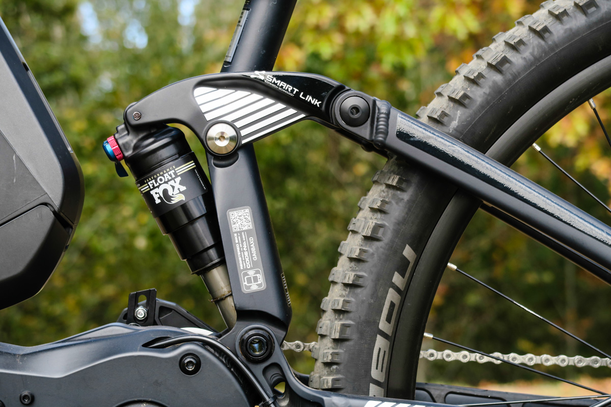

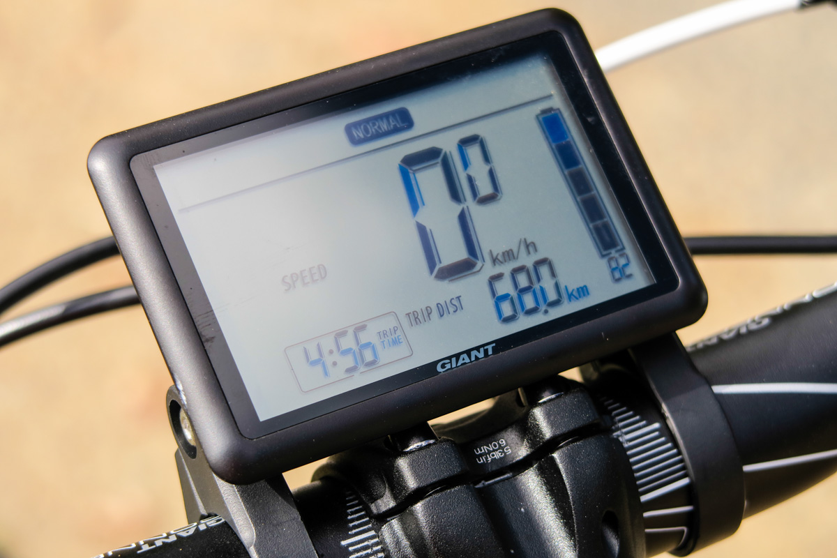

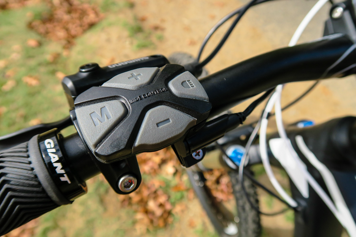

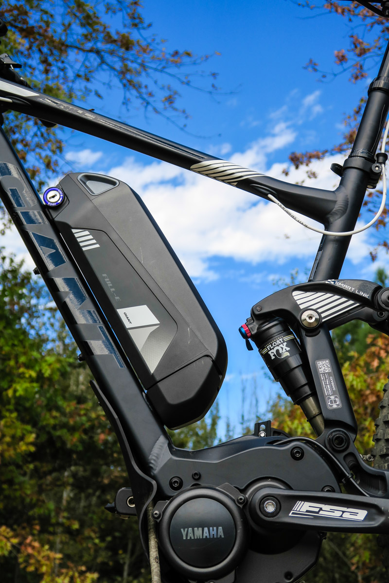

Angles on the bike closely match those of the Trance with the biggest difference being the chainstays growing from 440cm to 470cm and the heat tube from 120mm to 145mm on a size Large. To accommodate the motor around the bottom bracket, Giant opted for a single pivot suspension design called SmartLink instead of their well-known Maestro design. Internal cable routing has been executed well with little to no sign of the extra cables needed to send information from the sensors to the computer. Controlling the motor is done through a neat handlebar mounted remote with ride, mode and battery info displayed on a LCD screen that is centrally mounted.

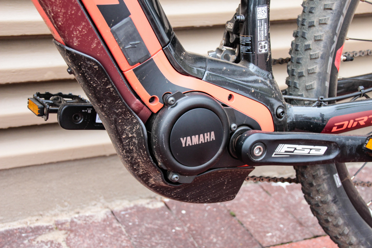

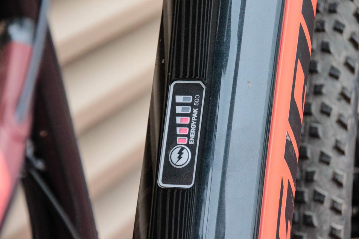

Yamaha’s Evolution line SyncDrive motor develops a hearty 80Nm and is powered by a 500Wh battery which will be good for 200km under ideal circumstances in Eco mode. This range is achieved by Giant’s EnergyPak battery technology, with a 25% higher energy density when compared to competitors’ batteries of the same size and weight. There is a battery level indicator on the battery with five LEDs to show you how much juice is left and the screen displays battery life left in percentage and a level indicator to make a quick glance possible.

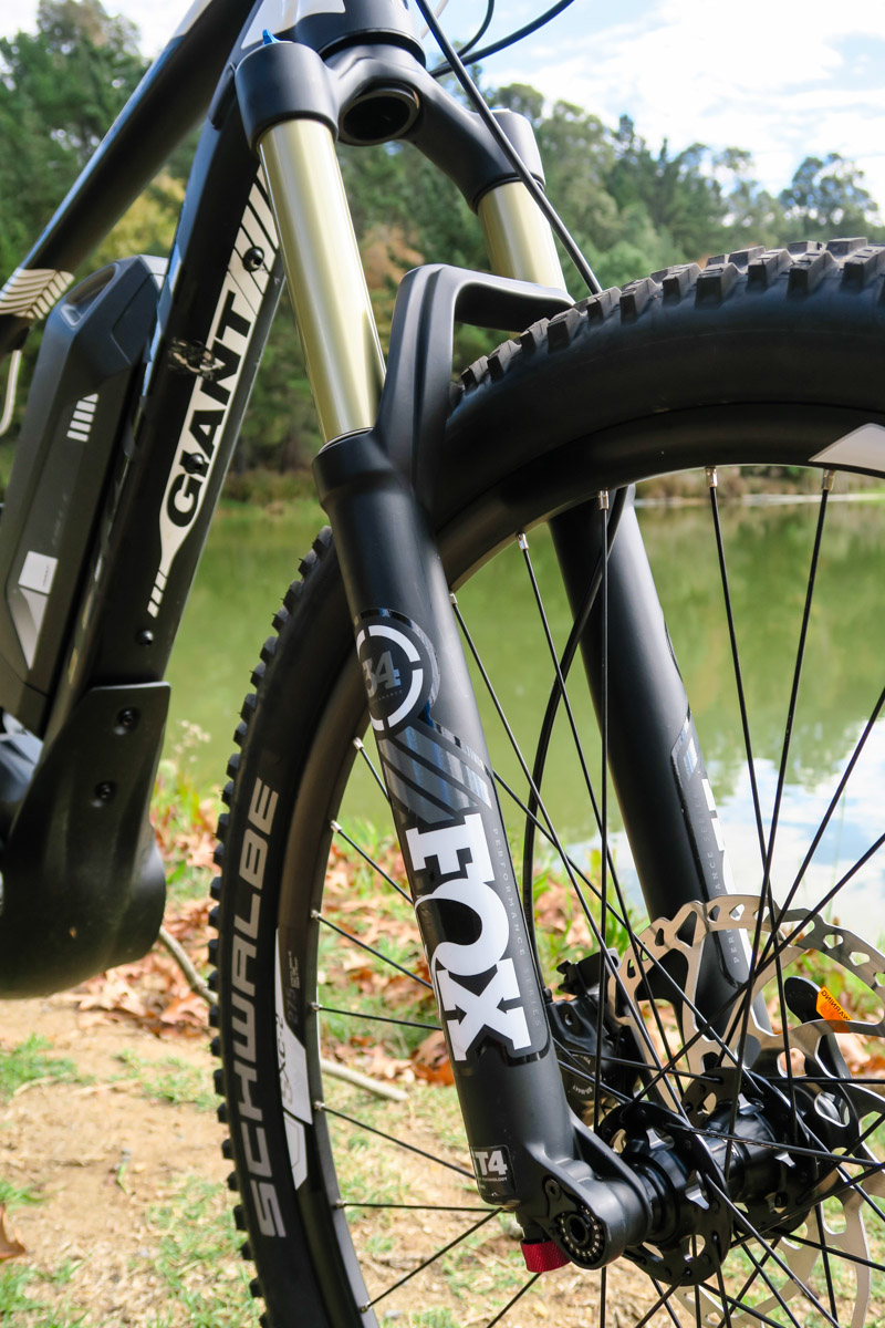

Big news here is the use of a Fox 34 Float Performance. Although not as smooth as the Factory model, it is a great pick for the Full-E with the beefed up lowers and the extra stiffness adding composure to the heavy bike.

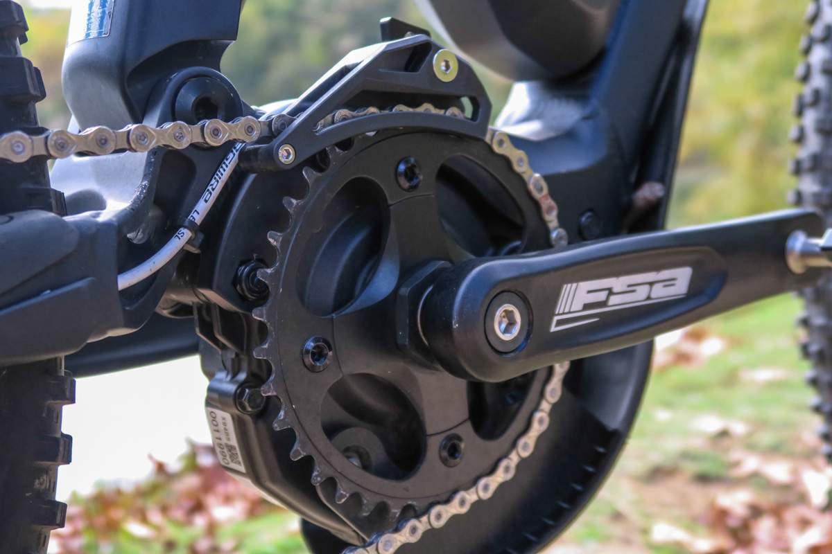

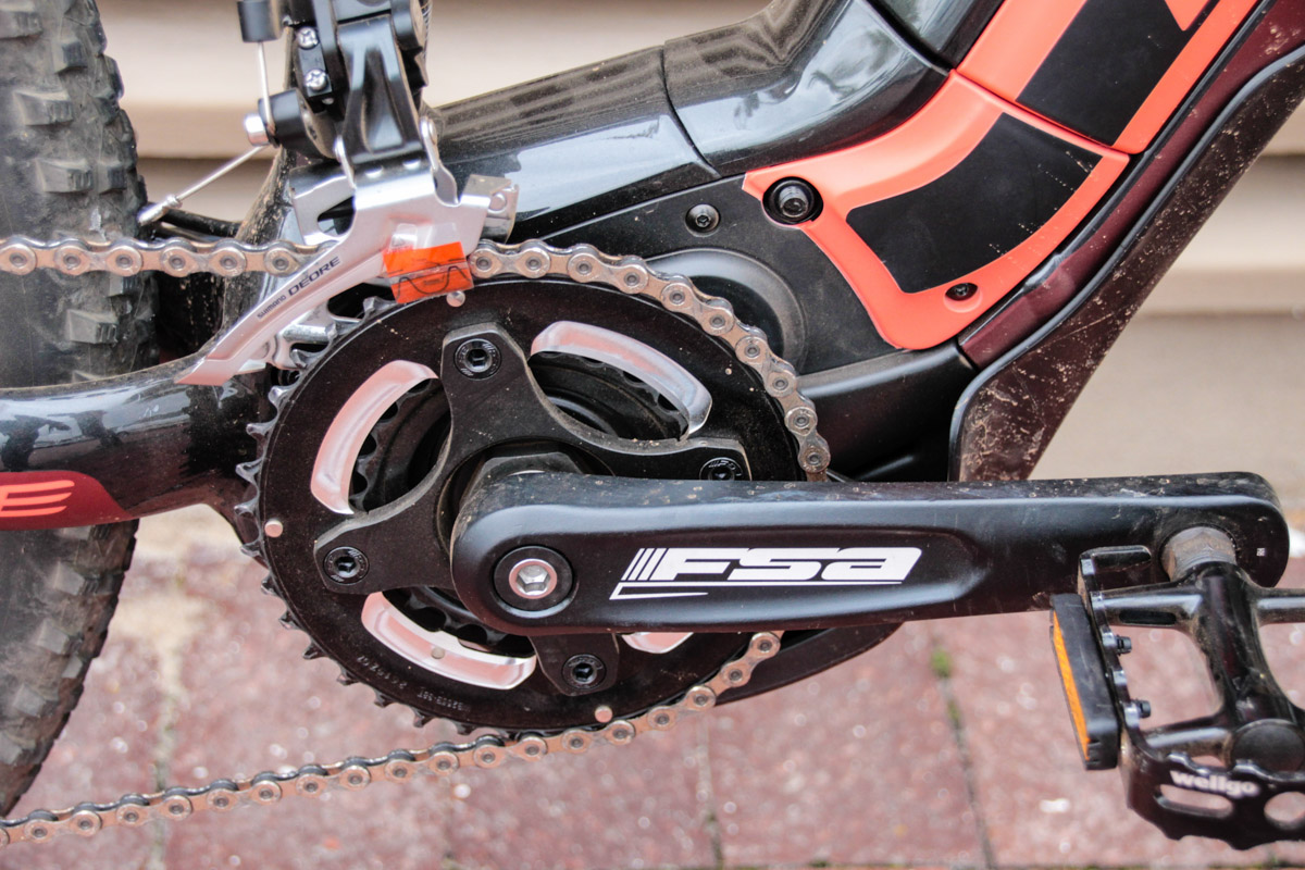

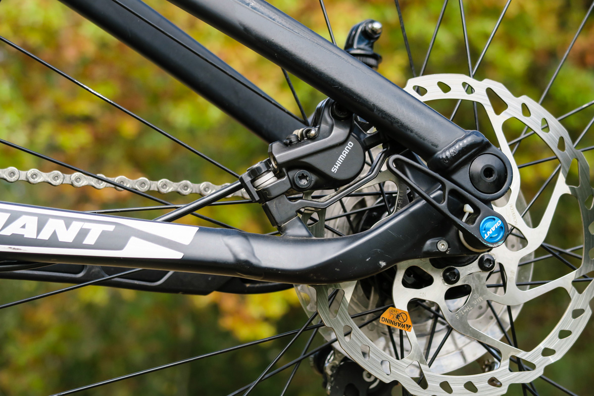

A Deore / XT drivetrain paired with a FSA crank and 36T chainring keep the wheels spinning. A set of Shimano M506 brakes running a 200 mm rotor up front and 180 mm rotor rear will slow you down when requested. Apart from the Schwalbe Nobby Nic, all the finishing parts come from Giant’s own stable. The Giant branded kit has improved considerably over the last couple of years to the point where it does not seem out of place on any of their bikes.

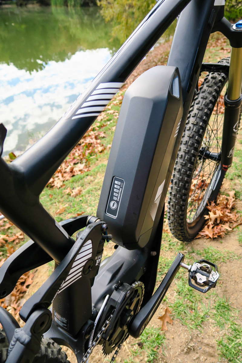

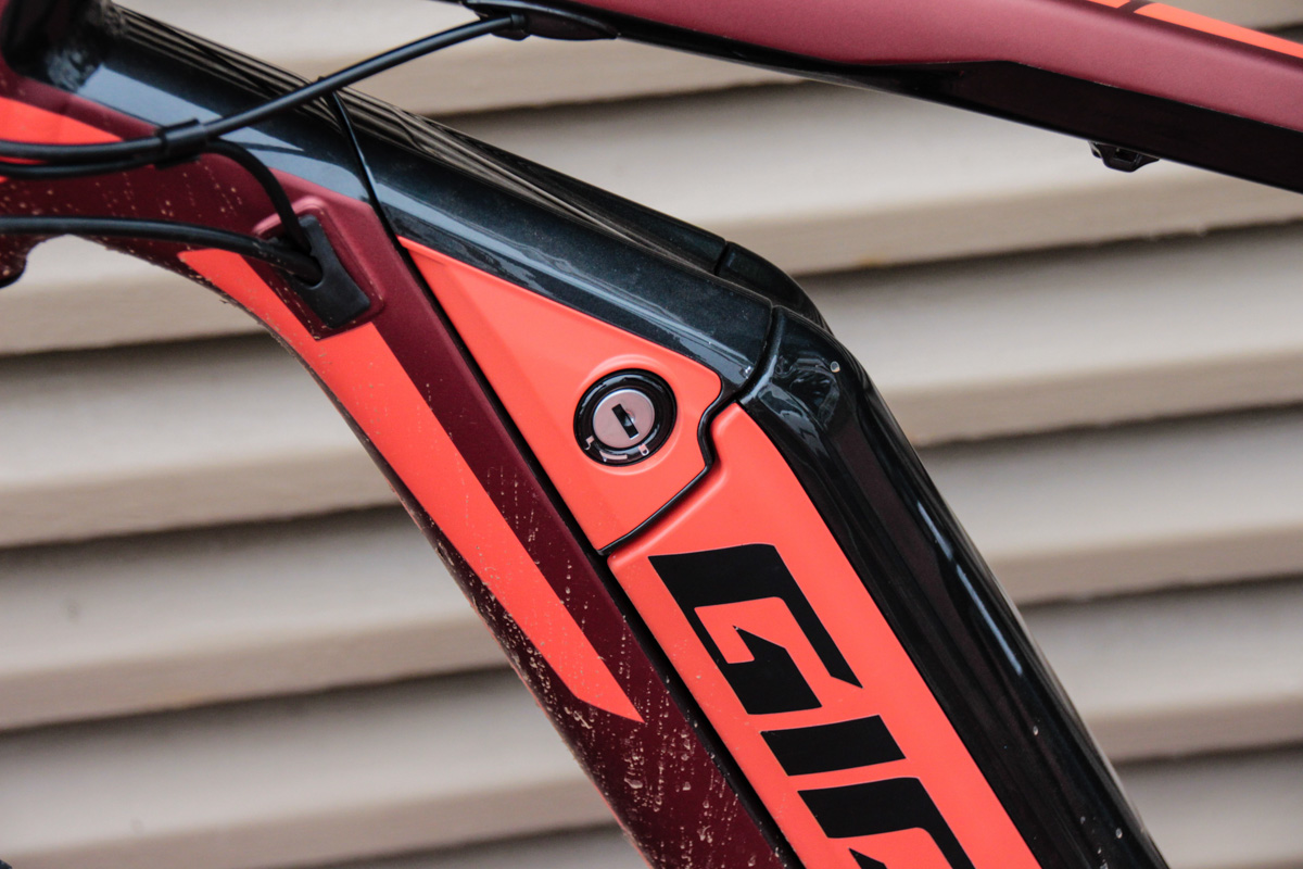

The Dirt-E is a 100mm travel hardtail. As the electronic components match those of the Full-E, the main difference between the two is in the bike design and component choice. In terms of design, unlike the Full-E, the Dirt-E integrates the battery pack into the downtube making for a far sleeker looking bike.

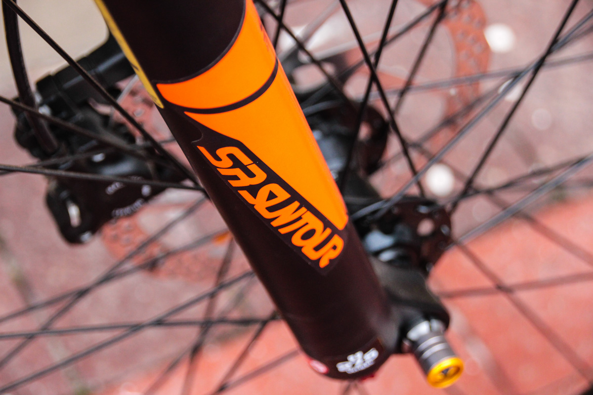

The bike features Shimano gearing with a FSA crankset and KMC chain. The 2×10 setup is mostly Deore level with an XT rear derailleur. The brakes are also from Shimano with 180mm rotors. A SR Suntour Raidon 100 mm air fork dampens the shocks on the front. The bike is finished off with Giant’s own wheelset and Connect cockpit components.

The only thing you need to remember on the Dirt-E (if you want power assistance) is to turn it on. Otherwise, it is as simple as can be. Changing between the power modes via the handlebar remote is intuitive and the information on the display is clear and relevant.
