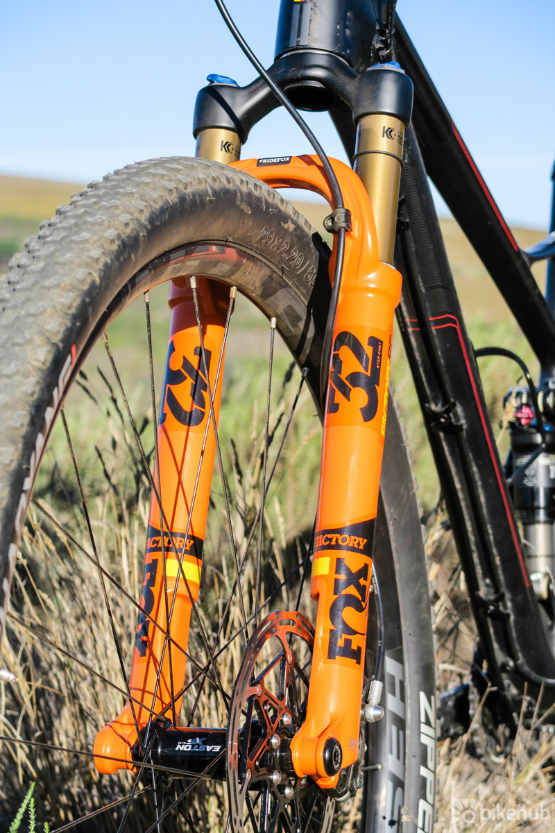

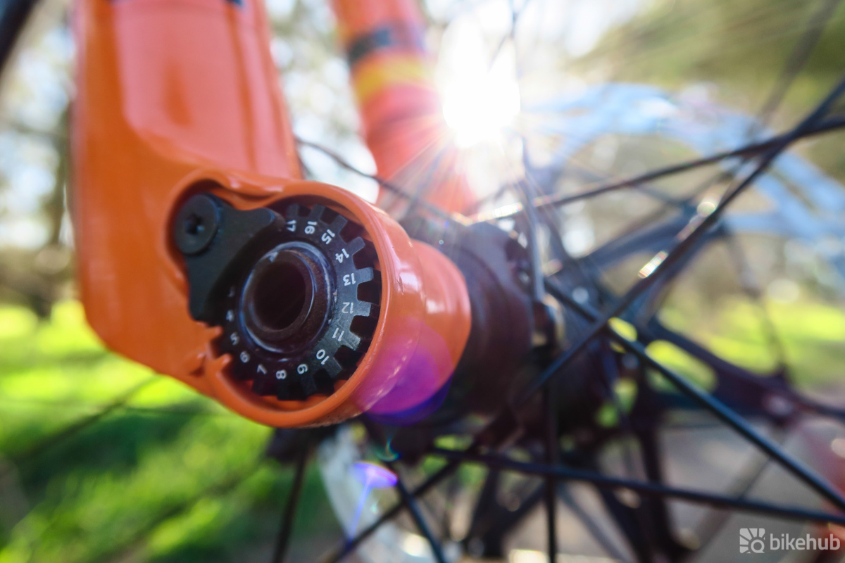

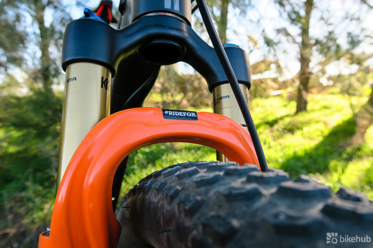

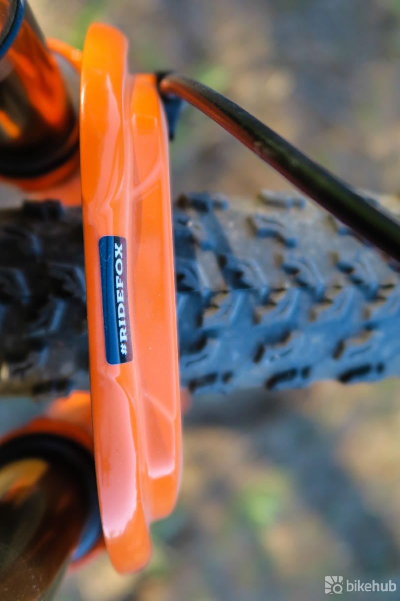

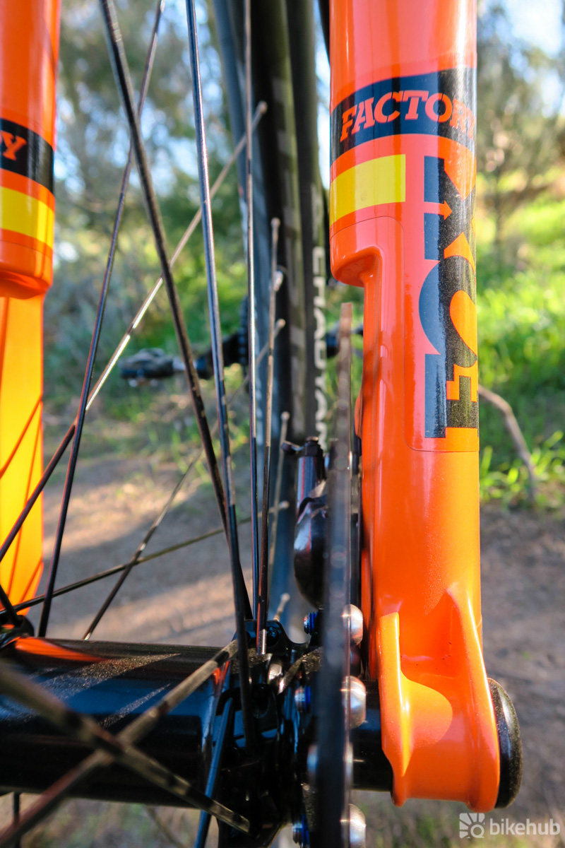

The chasis of the Step-Cast (SC) is noticeably different to the regular Fox 32 and most other forks available. To save weight, the width of the upper tubes on the 32 SC measure 120mm which is 10mm narrower than that of the standard, non-Boost Fox 32 fork. In order to have sufficient clearance for the spokes and disc brake rotor, Fox created a stepped design by flattening the inside edge of the hollowed out lower legs (where there are no moving parts), narrowing each leg’s profile by about 10 millimetres. Further weight saving has been achieved by eliminating excess width and material in the crown and bridge. Fox makes use of a new lighter and cleaner looking Kobalt Axle which alone saves about 40 g over the standard thru-axle.

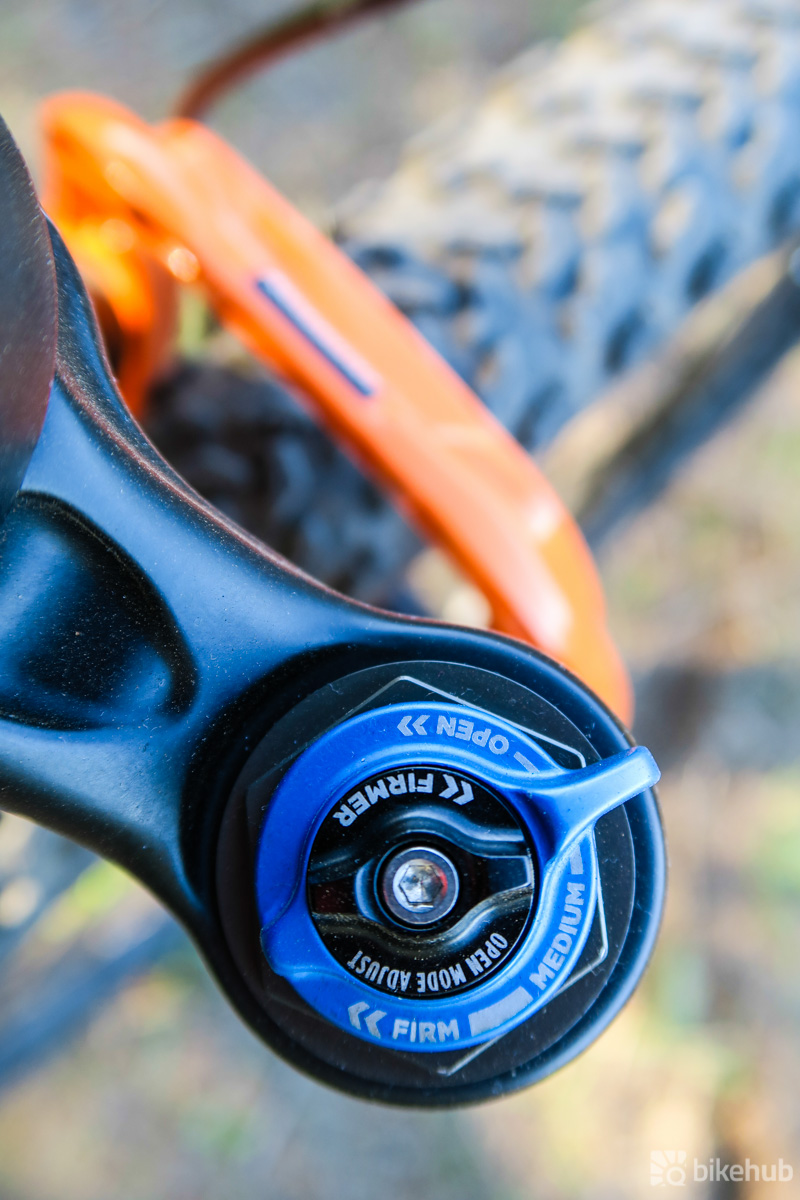

There is the familiar 3-position on-the-fly adjustment that lets you select Open, Medium, Firm modes. Fine tuning is possible in Open mode with a low-speed compression adjuster that offers 22 clicks. Forks with the optional remote will thankfully retain the ability to tune low speed compression in Open mode. Taking inspiration from their Moto designs, the new GRIP damper uses FIT sealed cartridge technology combined with a coil-sprung, independent floating piston. This allows excess oil to purge through ports at the top of the damper to maintain consistent damping and increase durability.

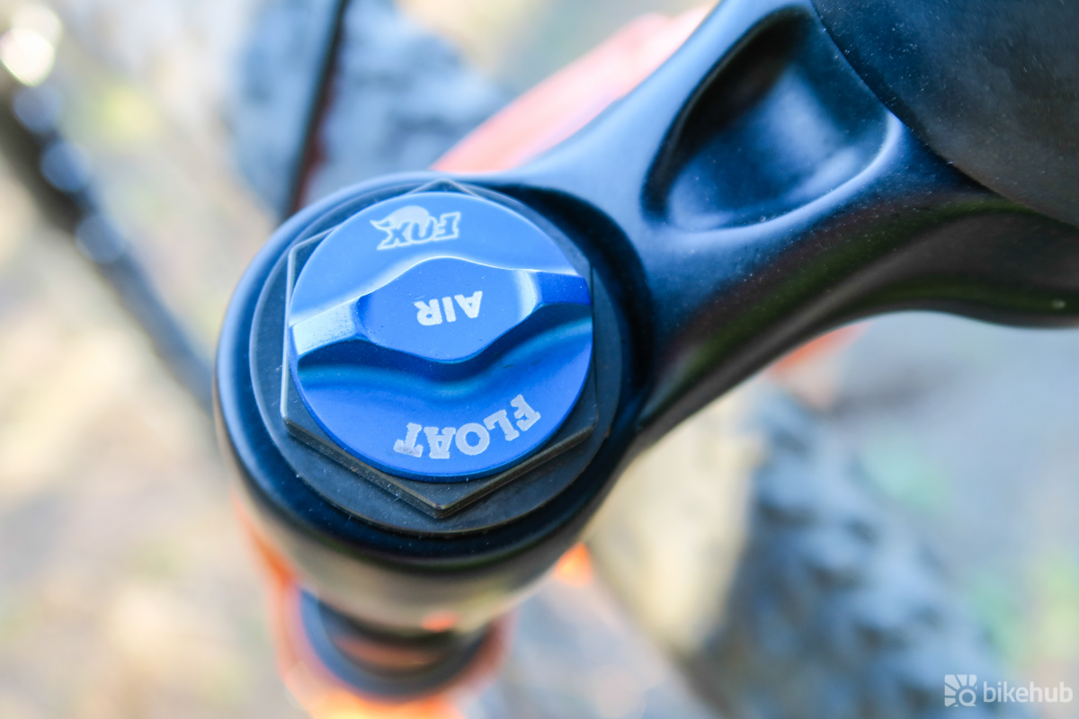

The Float Air Spring utilizes Fox’s self-equalizing positive/ negative air spring which is said to result in smoother performance with reduced friction and less vibration feedback through the handlebars. To further boost tunability, the feel and performance of the fork can be tweaked with air volume spacers that adjust the amount of mid stroke and bottom out resistance.

I’m not a fan of unnecessary wires, cables and hoses so was glad to see this one came without a remote and at no point did I wish I had a lever to flick between the three compression modes. Close to all my riding on the fork was done in the full open mode allowing the suspension to soak up small bumps and offer the extra traction that comes with it. Pure race snakes may prefer the optional remote, but that would be down to personal preference only.

  • Kobalt Axle is neat, light, secure and snatch-free

  • Kobalt Axle requires a tool to remove the front wheel
