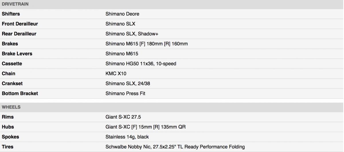

Ridden 2014 Trance 2 since July. I found the size a bit on the big side so bought one size down. Deore brakes were useless, changed to XT. Changed wheelset to Mavic to lighten up and dumped puncture happy Racing Ralphs..
Seat post is a good weight but the handlebars and short stem are heavy(60mm SL stem feels heavier then the 90mm non-SL item).
Bike handles far better then my previous 29'r Anthem. Experimented with increasing stem from 60mm to 90mm but this slowed handling too much and made manualing harder. Stiction on the Float CTD Evolution fork appears greater than on the Anthem, needing lubing after washing (stronger seals used maybe?).
Changed the 38 outer chainring to a 36, with much improved gearing.
