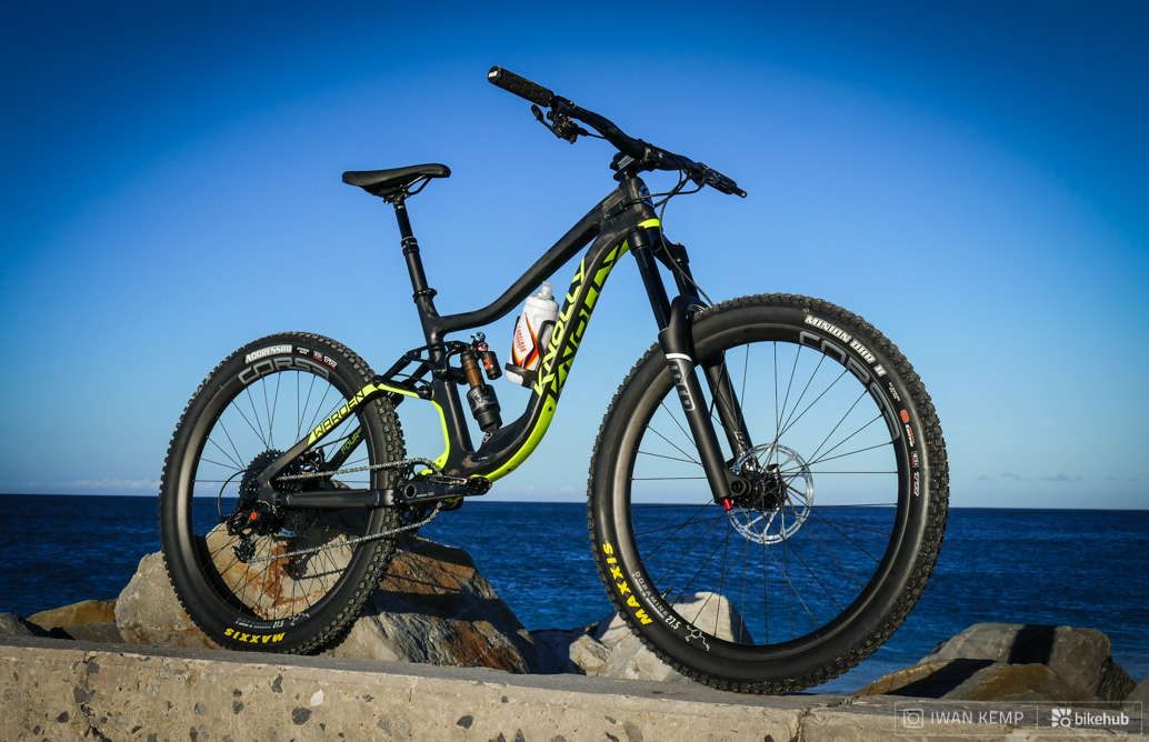

The Knolly Warden Carbon frame is the next addition to our long term test fleet. The Warden is a 155mm All Mountain/ Enduro Bike featuring Knolly’s Four by 4 suspension technology and adjustable geometry.
Iwan Kemp will be putting it through its paces on the trails around the Western Cape.

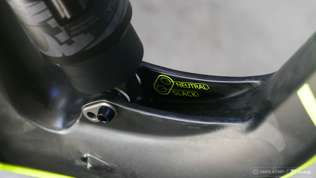

The Warden we have is the carbon version of the aluminium bike we reviewed last year. Travel has been bumped from 150mm to 155mm for the carbon version. As is the case with a number of modern bikes, the Warden has the option to adjust the geometry. The mounting position of the shock can be changed via twin bolt holes on the lower shock mount. In the low position the bike has a head angle of 65.5°, a 337mm bottom bracket height and a 75° effective seat angle compared to the high setting with 66.5° head angle, a 345.5mm bottom bracket height and a 74° effective seat angle.
The claimed weight for the frame is 2.8 kg with a DB-Inline shock and features replaceable ISCG 05 tabs, a threaded bottom bracket shell, a pinch bolt 12 x 142mm axle and full internal cable routing. Tyre clearance is massive with enough width out back to run beefy 2.4″ or 2.5″ rubber.

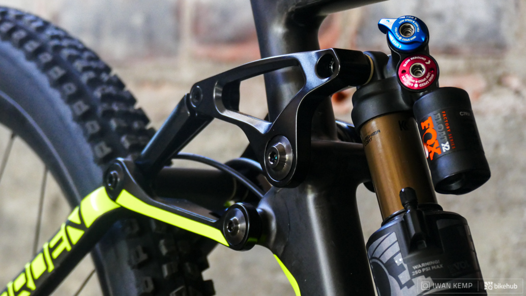

Knolly’s dual-linkage suspension design involves many pivots with lengthy maintenance intervals ensured by using angular-contact cartridge bearings on all the main pivots and Igus bushings in lower-stress locations.
Such is the confidence in their workmanship and durability of their frames that Knolly have announced a limited lifetime warranty (to the original owner) on their frames along with a crash replacement program

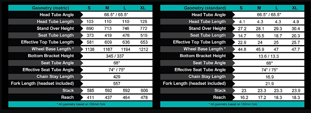

Geometry

Shock: Fox Float X2
FOX says this is their “highest performing air shock,” and have aimed it squarely at gravity-oriented riders. The Float X2 is high on tuning as it features low and high-speed rebound adjustment as well as externally adjustable low and high-speed compression damping. End stroke ramp-up can also be adjusted by sliding off the outer air sleeve and adding or removing volume spacers as needed.

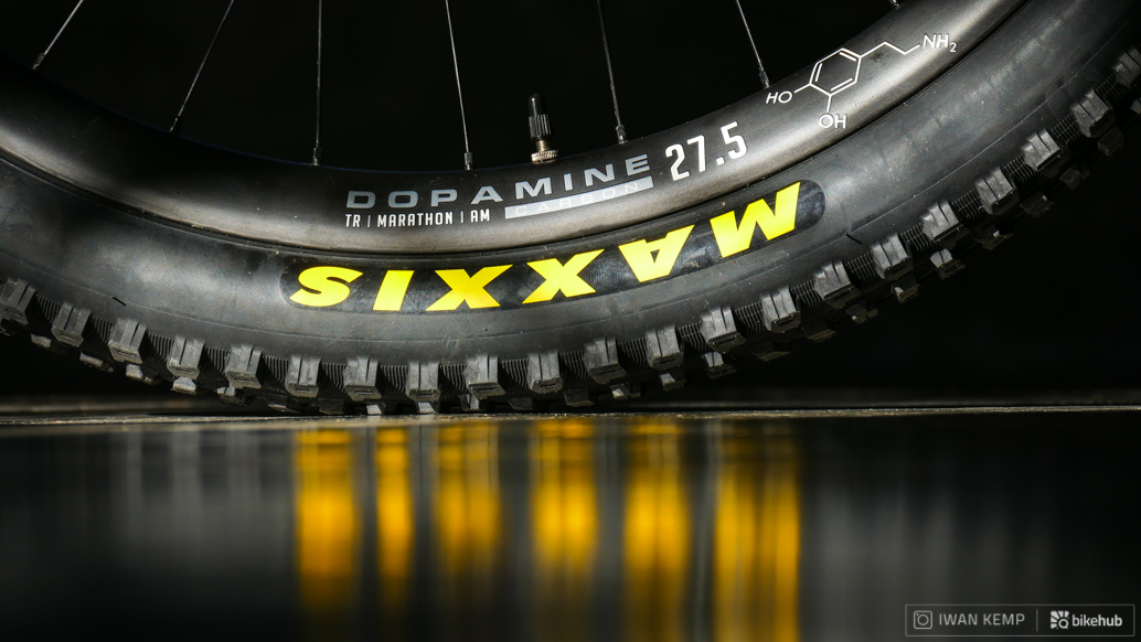

Wheelset: Corse Components Dopamine
Corse Components specialise in the design and manufacture of high-end carbon and alloy cycling components. The wheelset is built using their hubs that feature a four pawl, 36 point engagement system, with standard size Enduro bearings used throughout. Both hubs and rims are offered in 32 hole only as Corse Components claim this is due to the inherent strength achieved with a 32 hole, two or three cross lacing pattern: further catering to product reliability.
The Corse Dopamine carbon rims have an internal width of 34mm placing them just outside plus size. Corse Components say that these rims combine ideally with a 2.4″ tyre, with anything narrower risking a squared edge.

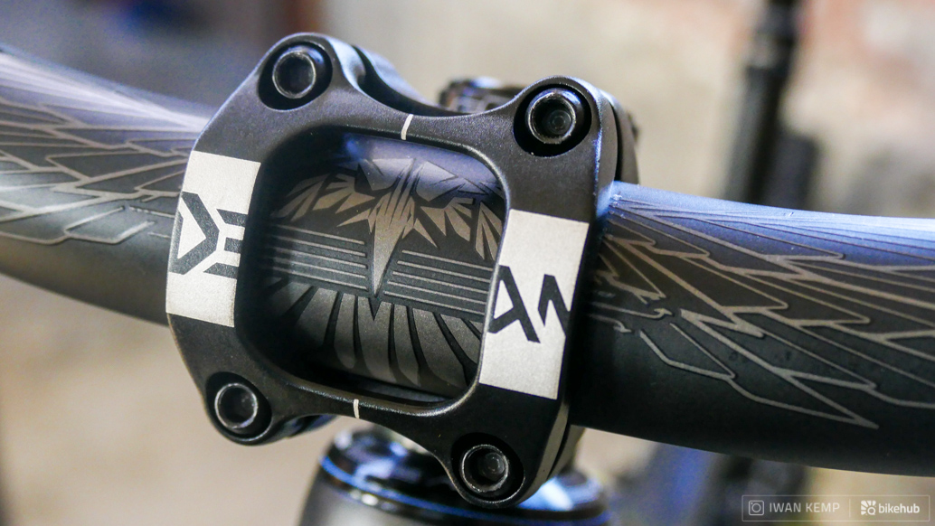

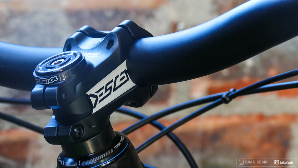

Handlebar & Stem: Descendant Kyle Strait CoLab Bar and Descendant stem
The Descendant bar and stem are old school 31.8mm Aluminium models. Weighing in at 349g the bars are a healthy 808mm wide (will most likely get chopped down to 780mm) and come with a Backsweep of 9º, Upsweep 5º and 25mm rise. The decals are exceptionally well designed and executed.
I’ve decided to keep it in the family and run a 50mm Descendant stem. It is 3D forged 7075 aluminium that has been CNC machined for weight reduction. It is a work of art with a chunky, aggressive look.

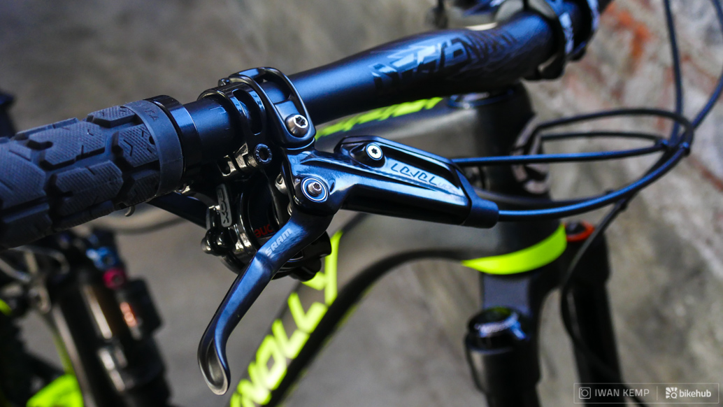

Brakes: SRAM Level Ultimate
Billed as a trail brakeset I will have to see how these fair on an AM beast paired with the 180mm rotors. They carry over several of the Guide brakes tech, but in a slimmed down version to reduce weight. The main thing to watch would be heat build up and how they fare in hot conditions.

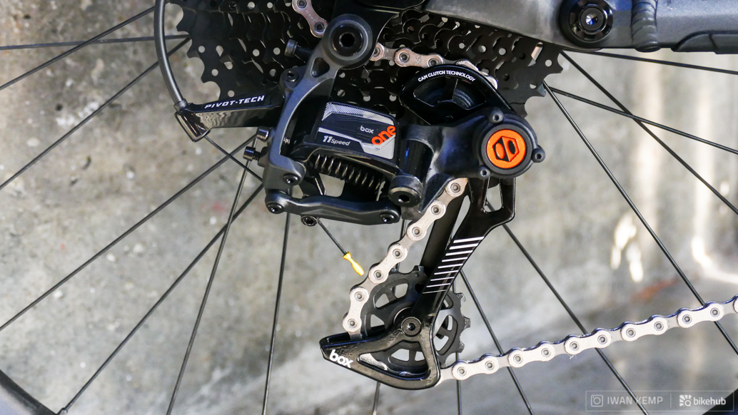

For most, Box’s new drivetrain components need little introduction. After several years in development their first MTB drivetrain components started shipping towards the end of last year. First out of the gate was their .one. shifter and derailleur and .two. 11-46T cassette. Their .one. range sits at the top of their line-up with the .two. sitting one level down.

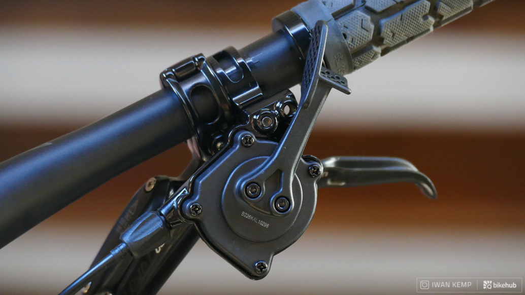

Sporting several unique features, what really sets it apart is the unique single-lever shifter which handles both upshifts and downshifts. Pressing forward on the lever like a normal thumbshifter downshifts the drivetrain to an easier gear, and then pressing in on the lever with the tip of your thumb upshifts into a more difficult gear.

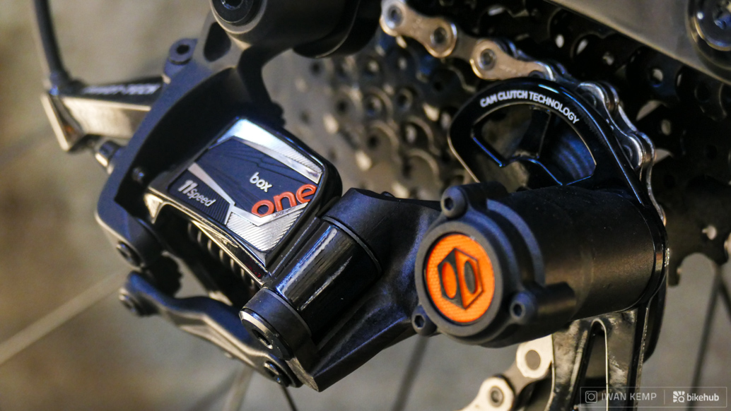

The rear derailleur (there is no front derailleur) comes with an ace or two up it’s sleeve. Pivot Tech allows the derailleur to swing backward when it experiences a hit, in an attempt to keep the derailleur or the hanger from breaking and also comes with the now-common “clutch” tech. Box calls theirs “Cam Clutch technology,” and it’s always on and always engaged.

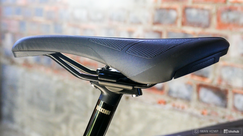

Saddle: Specialized Henge Comp
The Henge is the Trail and All Mountain saddle in Specialized’s line-up. Available in two widths (143mm and 155mm) and in this Comp version or the Expert that sits one level up. Low-friction coating on the nose and tail ensures you glide smoothly when shifting weight rearwards.
SWAT-compatible Allen key mounts in the base of the saddle integrate neatly with Specialized’s own storage solutions, and mean you can mount essential trail gear on the bike and potentially ride without a pack.
The comp features extra padding (compared to the Expert) and weighs in at 252g.
Tires: Maxxis DHR II front and Aggressor rear
We have had these around the office and on a bike or two, details can be found here, but this will be the first time I will try them on a proper big bike. I will keep the option open to run a DHR II on the rear as well, but will first see how things go with the combo as is.
They have been converted to tubeless using Stan’s sealant and I’m running a set of Huck Norris anti-pinch-flat insert for the first time.

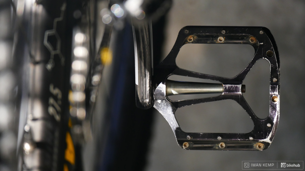

Pedals: Point1 Podium
The pedals that just won’t die! These have been moved around for a good couple of years now and, amazingly, are still holding out fine with all pins in place and the axle spinning up as intended.
