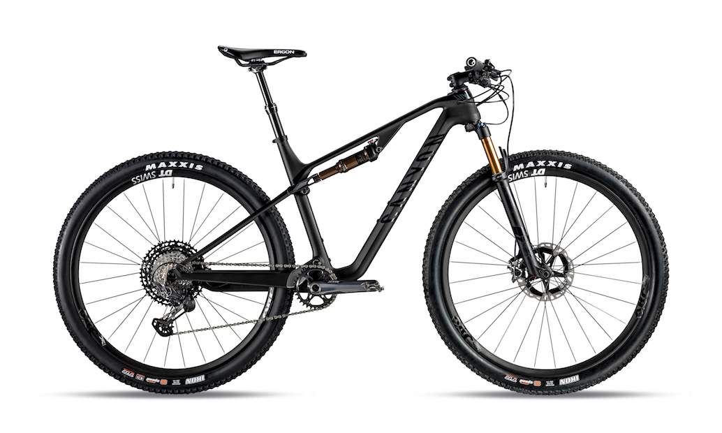

The new Lux
With the new Lux, we wanted to build on the success of its predecessor to make a bike that’s more than a match for the challenges of modern XC. Already proven at the Cape Epic and at home on the World Cup circuit, the new Lux gives riders the speed they need to fly.
Development Objectives
  • Be Lightweight: Coming in sub-2000 g for frame and shock was our priority to create one of the lightest full suspension platforms on the scene.
  • Be Compatible: An identical fit to our Exceed XC hardtail was essential to allow riders to switch easily between hardtail and full suspension setups.
  • Be Efficient: We had to nail the balance between anti-squat and active kinematics for suspension that boosts traction up loose climbs without wasting power.
  • Be Capable: From geometry to suspension, the Lux had to enhance control and inspire confidence so riders can open gaps where others back off the gas.

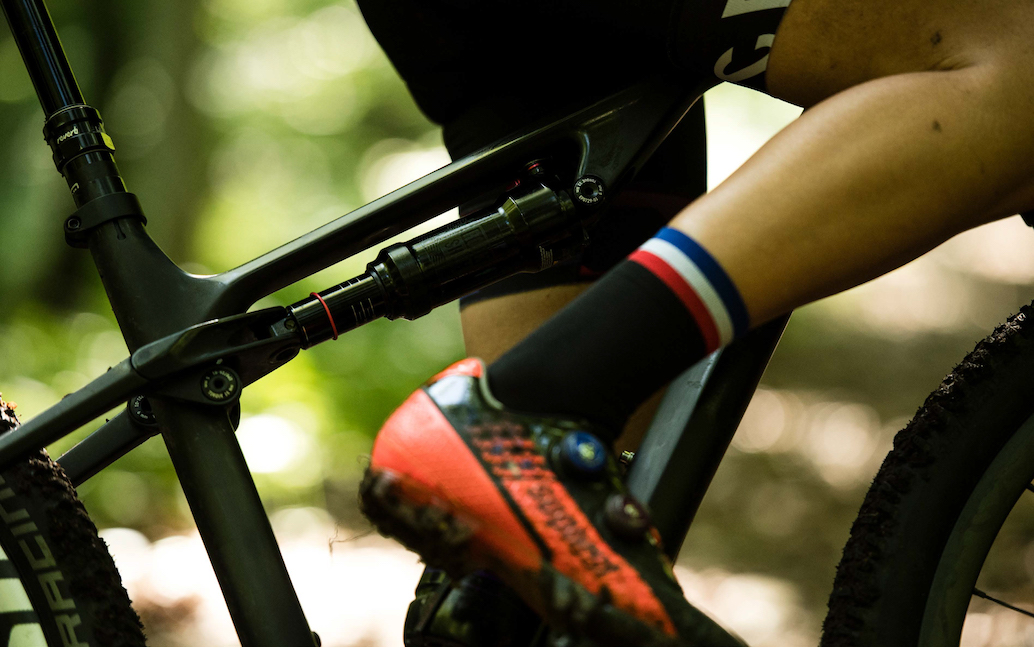

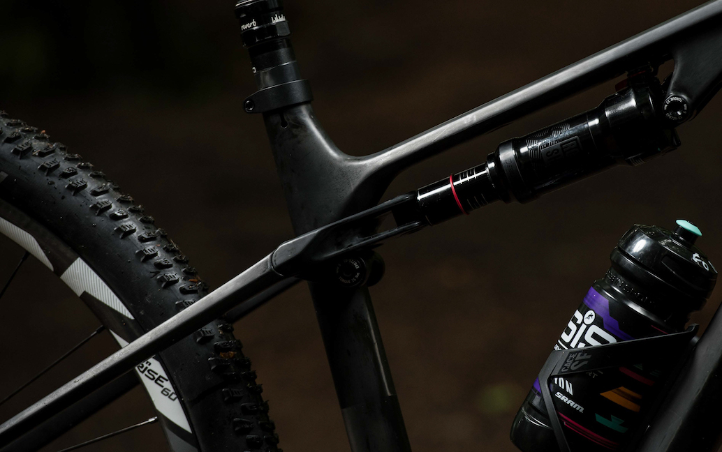

The most striking difference between the new Lux and its predecessor is the new flat shock suspension configuration. The four-bar linkage-driven system makes the most out of 100 mm of travel to enhance control, efficiency, and rider comfort.
  • Less Stress: Revised kinematics place less stress on the bearings and pivots, as well as requiring lower shock pressure to enhance reliability thanks to a low leverage curve.
  • Less Weight: The new linkage requires less hardware in part due to the reduction of loads and stress in the system, making it significantly lighter than the previous design.
  • Better Responsiveness: The positioning of the rear shock means there is less friction loss due to changes in force direction, while a low leverage curve enhances overall sensitivity when dealing with a short amount of travel.

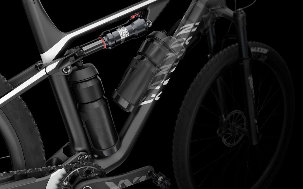

Two Bottle Cages
When it comes to marathon racing, the more self-suffi- cient you are the better. That means carrying as much hydration as possible on the bike. With a flat shock configuration, space is freed up on the down tube so two large 800 ml water bottles can now fit within the main triangle on every frame size.

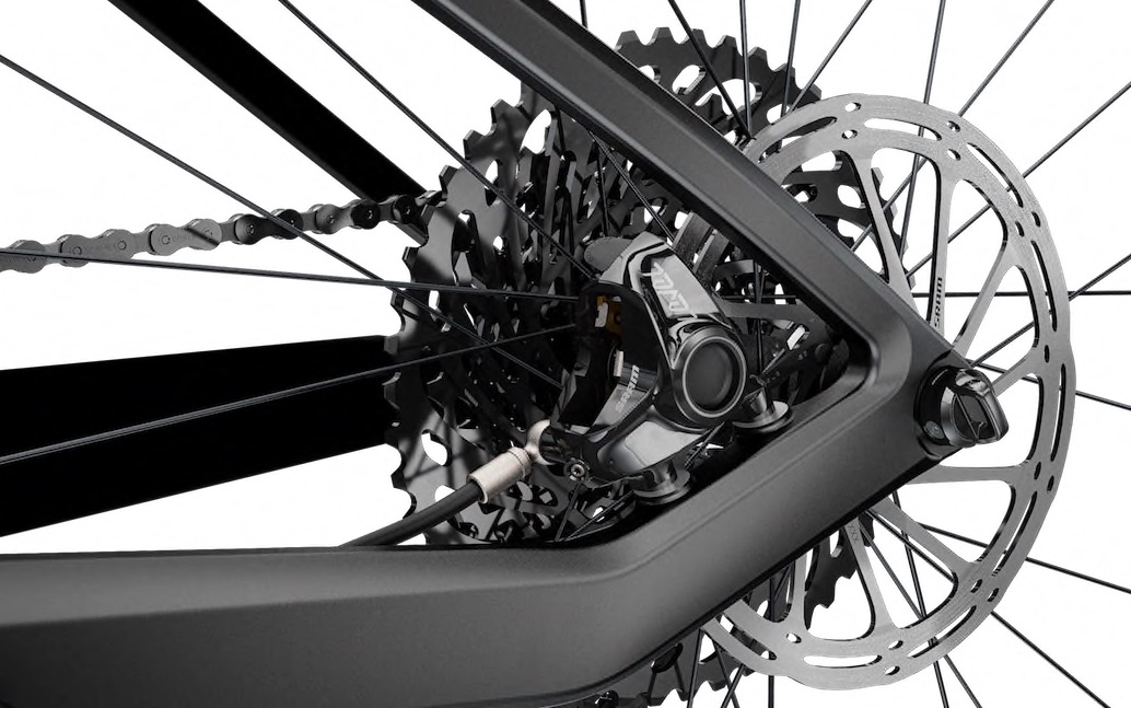

Flat mount brakes
The Flat Mount braking standard has made its way off the road and onto the trail. Mounting brake callipers onto the chainstay instead of the seatstay allows the Flex Pivot to better carry out its single function instead of having to provide a stable platform for braking forces while flexing simultaneously as the suspension is activated. Beyond better function, this new configuration requires less hardware, contributing to a 23 g saving over the previous design.

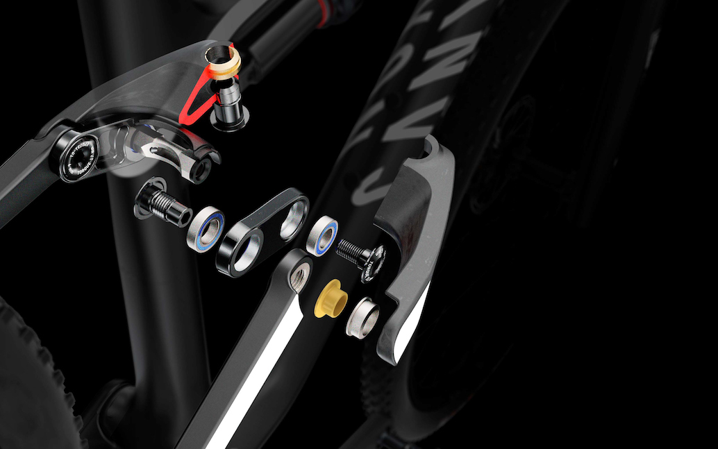

A Lighter Linkage
Consisting of a compact rocker hidden beneath the shock extension and a concentric pivot with slide bearings, the new linkage on the Lux requires far less hardware than its predecessor. The shock extension itself is manufactured using advanced and precise injection moulding production methods. This carbon-reinforced unit enables us to keep weight down and strength high.
We were able to go much lighter with the rocker on the new Lux because it is subject to less load than on the previous design. The unit is made up of aluminium sides connected by a steel bridge to provide maximum torsional stiffness in a limited space. Here, smaller and lighter ball bearings are housed inside the rocker and not in the frame to allow easier servicing with no risk of damaging the frame when swapping out used parts. To make sure this is a rare occurrence, the bearings are filled with a special high-viscosity, anti-corrosive grease for increased water resistance and performance over a longer lifetime.
Slide bearings can be employed for the concentric upper pivot to further save weight and improve reliability. This solution works better than heavier ball bearings with the suspension on the Lux due to the small pivot angles at play at this point.
Beyond the gains in reliability, serviceability and riding performance, the new linkage saves an impressive 144 g over the previous design, contributing greatly to the overall weight saving made on the new Lux.

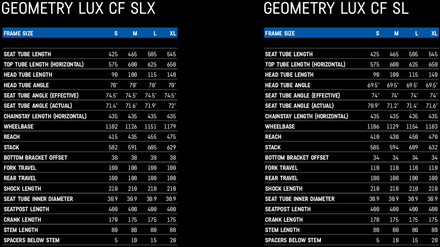

Geometry
Updating the Lux with a modern race geometry was a clear priority when we gathered feedback from our pro riders early on in the development process. They also requested that the new Lux should more closely mirror our Exceed hardtail to enable seamless switches between race setups, reducing time required to accustom to different riding positions.
On Track. On Trail.
The Exceed is a pioneer for more progressive XC race geometries, so we naturally took the same approach for the Lux. In a size medium, the new Lux has a 20 mm longer reach than its predecessor for extra stability at speed, while chainstay length has been reduced from 450 mm to 435 mm across all sizes for enhanced handling agility.
Reach has also been adapted across all sizes so that we could equip shorter 80 mm stems on every bike for handling consistency across the size spectrum, while stack is also lower than on the previous model to facilitate more aggressive riding positions.
One key difference between the Lux CF SLX and the Lux CF SL is a 10 mm jump in fork travel. Serious racers who strive for the most aggressive setup with steeper angles and faster handling can opt for 100 mm of travel on the Lux CF SLX. For more trail-oriented races, riders will appreciate having a little more in reserve up-front with 110 mm on the fork on the Lux CF SL, which also slackens the head angle by 0.5° for more stable handling at speed.

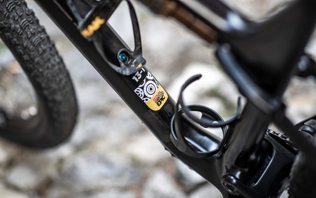

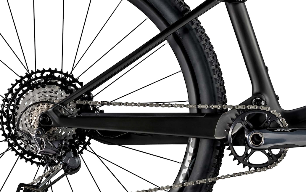

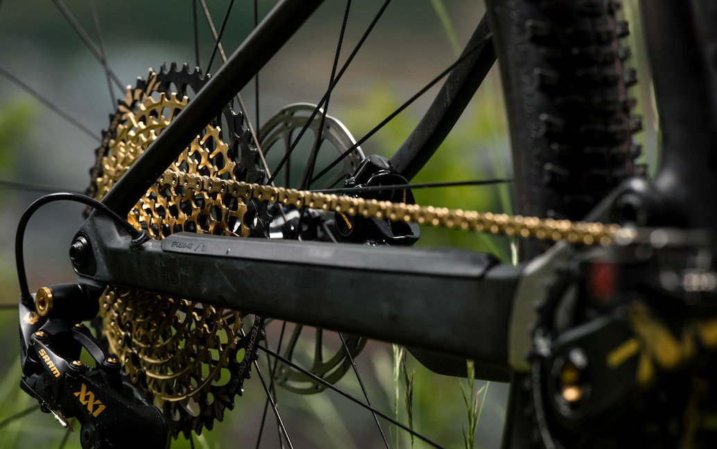

Superlight chainstay protector
Any good chainstay protector should keep the frame material out of harm’s way while also reducing the noise of chain slap. Our superlight chainstay protector exploits an air core to deliver both those properties. Using a strong adhesive to bond to the carbon surface further reduces the need for hardware to keep weight low. 8.2 grams.
ccs-62657-0-89313000-1529997902.jpgSuperlight chainstay protector.
ccs-62657-0-89559600-1529997912.jpgMinimalist chain guide.

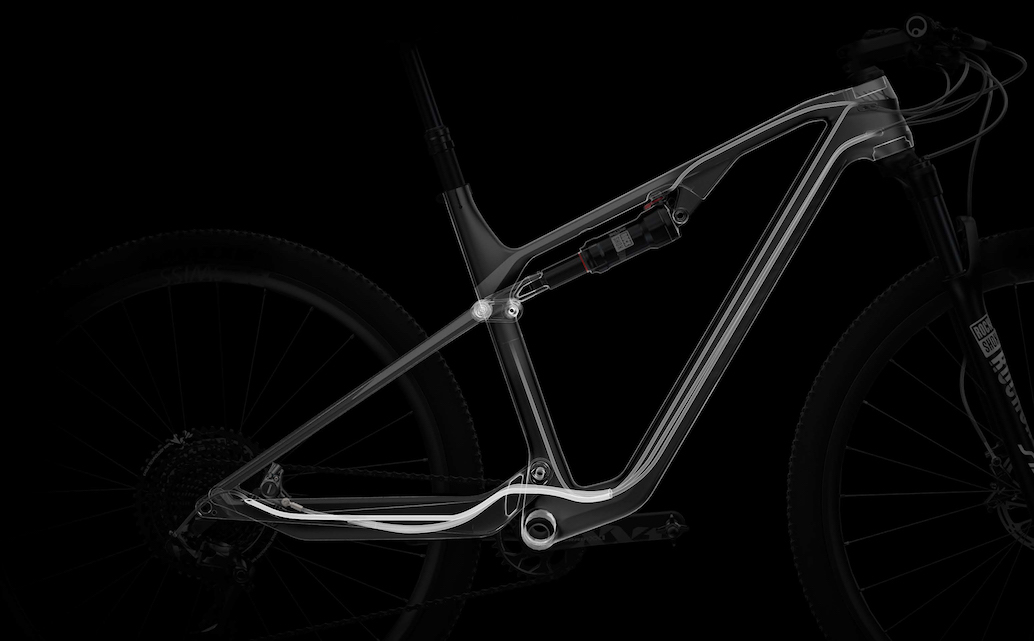

Cable tubing
Internal cable routing has come a long way in recent years. From entering the head tube, no cables or lines are exposed until they re-emerge at the component they serve, that includes for the rear shock remote lockout.
Inside the frame, we have made it even simpler to carry out maintenance thanks to internal tubes that act as guides to swallow all lines, housing and all, and deliver them to where they are needed. Throw a new cable and housing in one end and they will pop right out at the other end–no fishing about required. The tubes also provide a secure hold to drastically reduce cable rattle for an even stealthier ride on track thanks to extra foam protection in the main triangle.
Beyond clean aesthetics and a super composed and quiet ride, the extra protection provided by our tubing makes clean and crisp shifting last even longer, no matter how bad the conditions get.

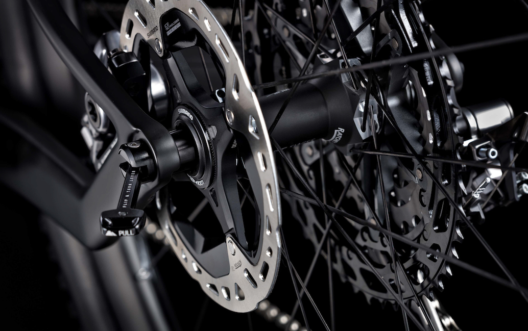

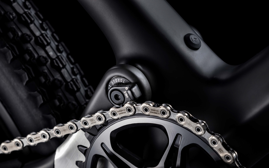

Quixle
Tool-free access to through axles is not a given on today’s mountain bikes. For quick adjustments or rear wheel removal, we developed the Quixle. The lever neatly integrates inside the axle so it’s out of harm’s way and out of sight when you ride, yet is easy to access whenever needed.
ccs-62657-0-34815300-1529997921.jpgQuixle axle.

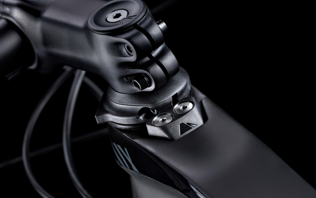

Impact Protection Unit
Our Impact Protection Unit features on all our models where handlebar strikes against the top tube are a risk. Integrating this feature neatly behind the headset provides an immediate visual indication of any damage sustained after a crash. Hollow screws are designed to break and absorb the force of the impact meaning after an incident, only the screws have to be replaced, not the frame.

Developing our own side-loading bottle cage was an essential requirement in order to house two 800 ml bottles inside the frame. The Canyon Sideloader makes it fast and easy to access and replace bottles when on-the-go, while offering a secure hold so your hydration stays where it belongs.

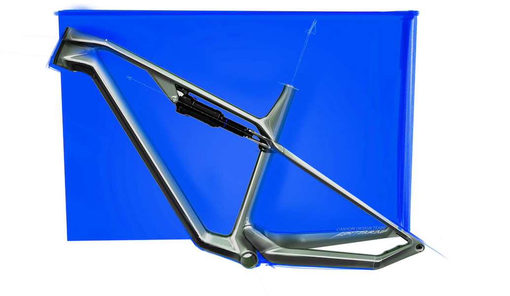

Design
From initial pencil strokes to final 3D renderings, we wanted to showcase our modern design language throughout the new Lux. Integration is a foundation of our industrial design philosophy, and the Lux takes this approach to a new level. Its characteristic flash line creates a connected look for the entire rear shock assembly, linking the seatstays, shock extension and top tube in the same logical flow.
Our fundamental design goal was to reflect this bike’s lightness and competitive edge through form alone. Geometric shapes and an abundance of straight lines leave no doubts in the mind regarding its purpose, while a low stack and forward bias contribute to its aggressive racing character. The new Lux is firmly embedded in the latest generation of Canyon mountain bike design.

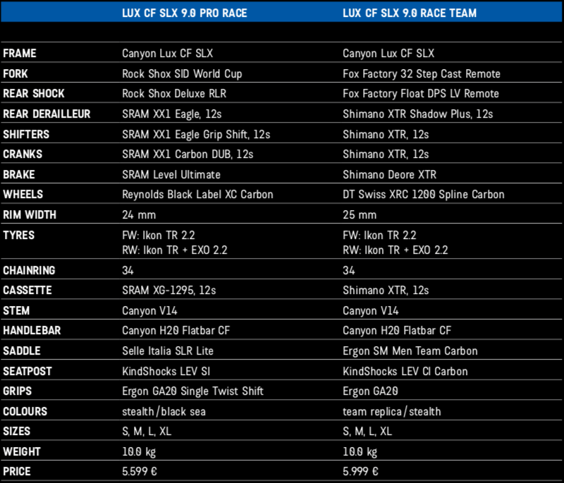

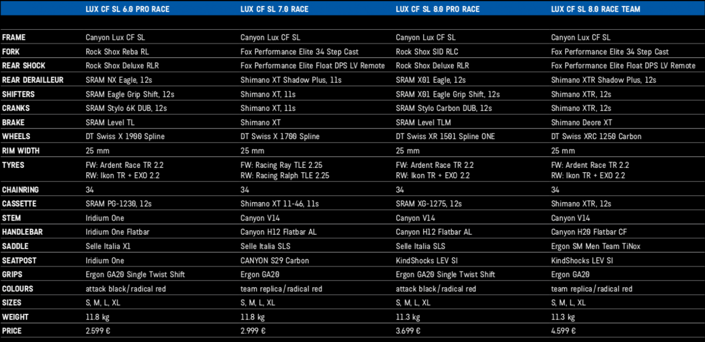

Model specifications

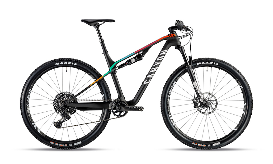

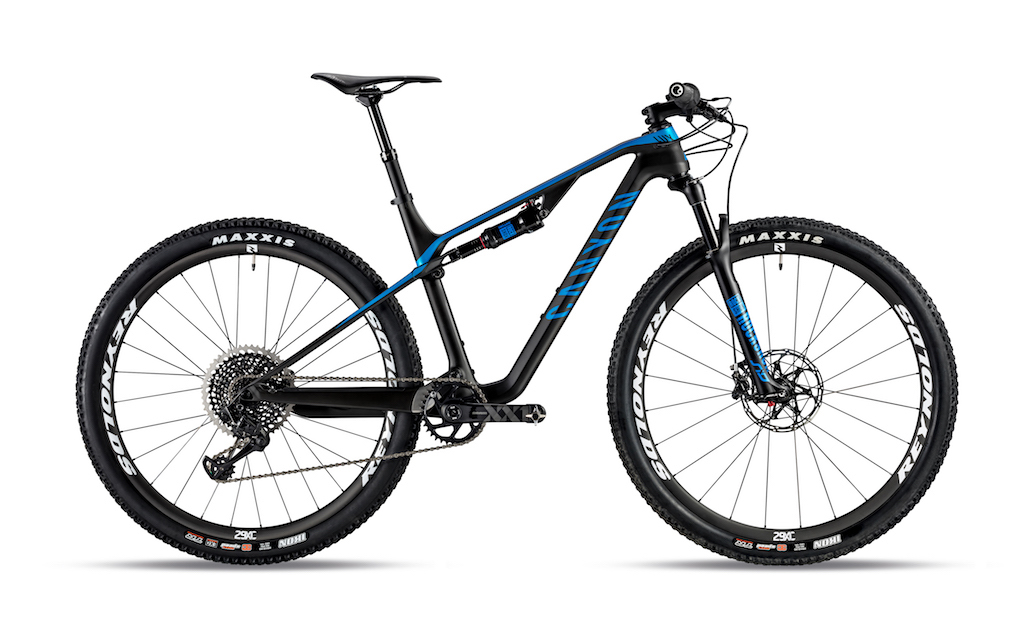

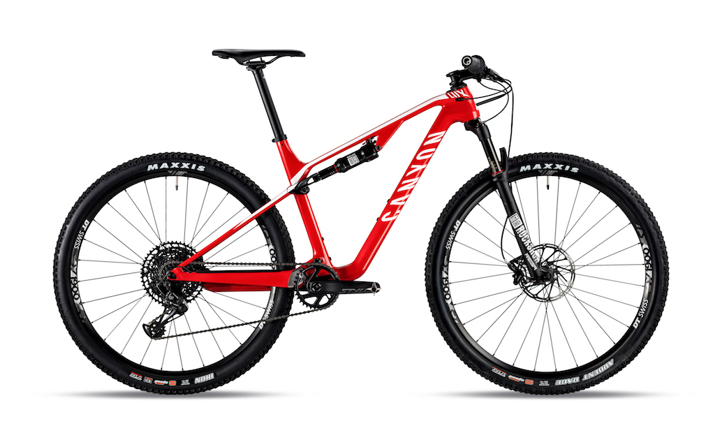

Canyon Lux CF SL
ccs-62657-0-38139700-1529569009.jpgRadical Red.
ccs-62657-0-31551600-1529569008.jpgTeam Replica.
ccs-62657-0-39261800-1529569007.jpgAttack Black.

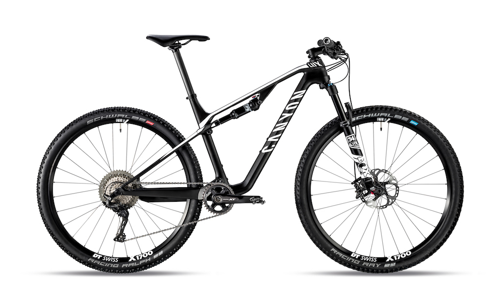

Canyon Lux CF SLX
ccs-62657-0-90674800-1529569014.jpgTeam Replica.
ccs-62657-0-07545200-1529569016.jpgTeam Stealth.
ccs-62657-0-29734000-1529569017.jpgBlack Sea.
