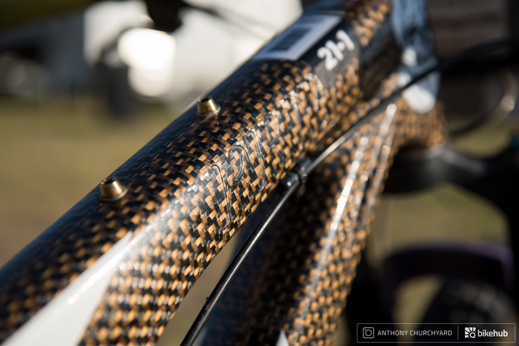

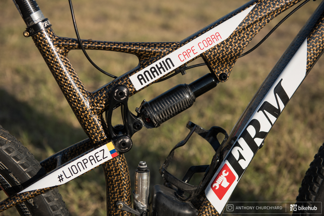

The golden weave is apparently not simply an intricate paint job, but a material called Zylon which has a greater breaking resistance than kevlar. It is also used to make the cables on Formula One cars to ensure that the wheels do not detach in crashes. The gold colour is similar in appearance to the skin of the Cape Cobra, explaining the bikes name.
Mirko is proud of the special touches FRM can add in the manufacturing of their the carbon components, including the embossed FRM logo on the side of the top tube which he claims no factory in the East can replicate.

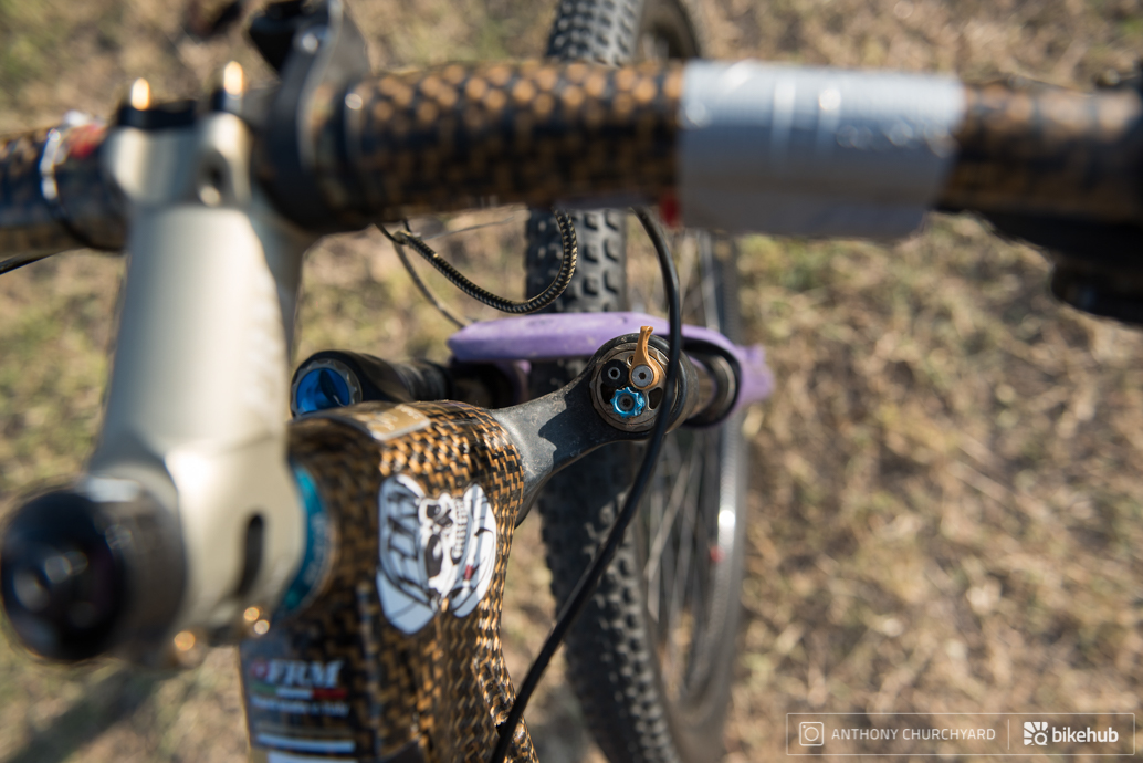

The Anakin features a lightweight DT Swiss X 313 shock with a carbon sleeve which DT Swiss claim weighs 165 grams. Mirko has tuned the bike and shock in a way that he can run the shock with no sag but it will still produce a supple initial travel: or so he claims. The fork is produced by fellow Italian brand Formula. Mirko’s Thirty3 (a reference to the stanchion diameter) is set to 120 mm travel.

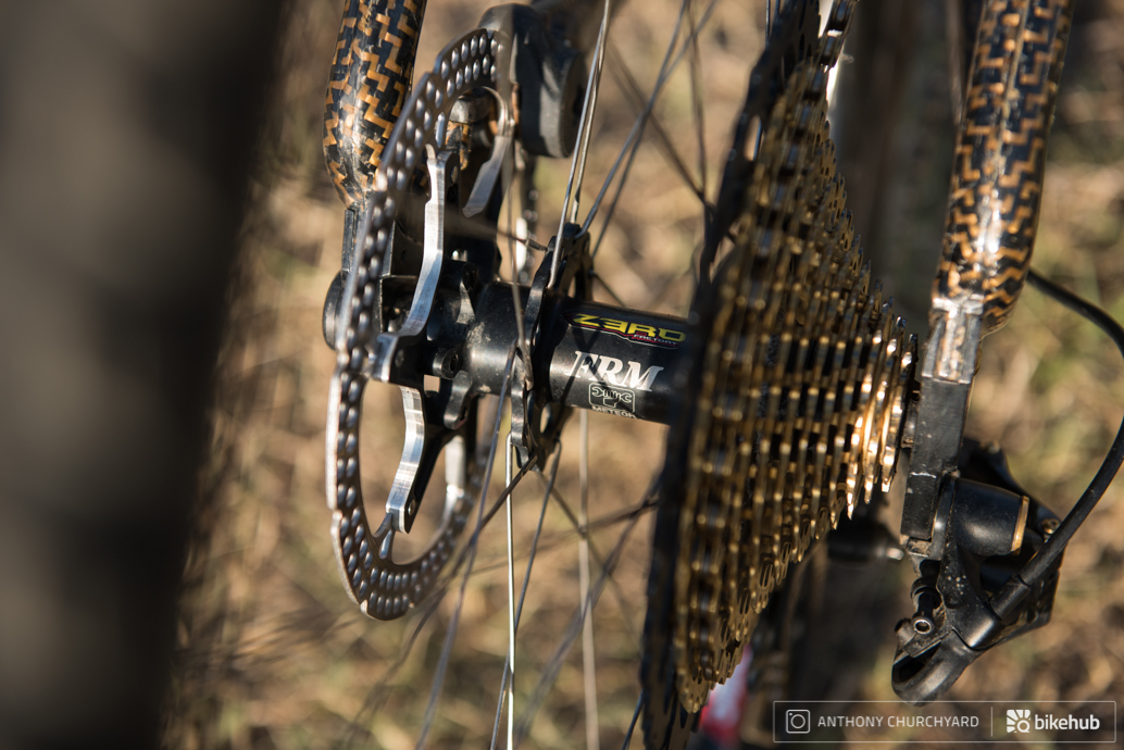

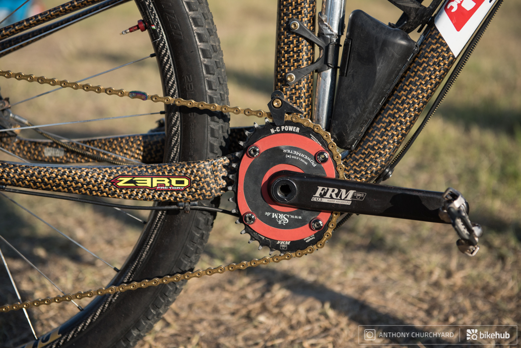

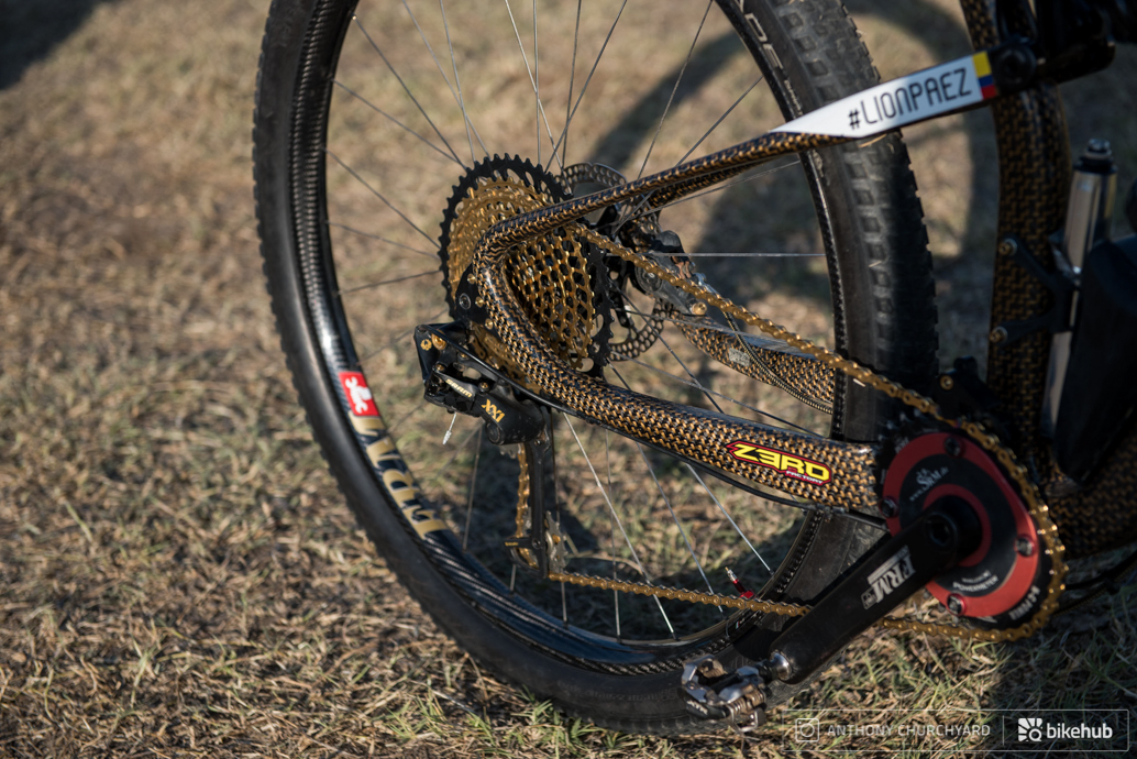

The derailleur, cassette, chain, and shifters are from SRAM’s XX1 Eagle groupset. The gold option a (rare) appropriate choice for the Anakin frame. The FRM cranks are made from scandium alloy and are fitted with an oval FRM chainring with a narrow-wide tooth profile. Mirko has also fitted a small prototype chainguide and a SRM power meter.

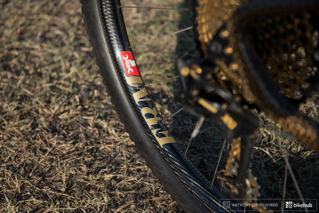

The wheels are also built up with FRM components. The Evo Carbon rims have a 30 mm internal diameter and weigh 375 grams. The hubs carry the Meteor name, and like the rims, are also made in Italy. The hub bearings, and those on the frame, have undergone treatment by Zero Factory which promises a 35 percent decrease in friction and improved wear resistance.

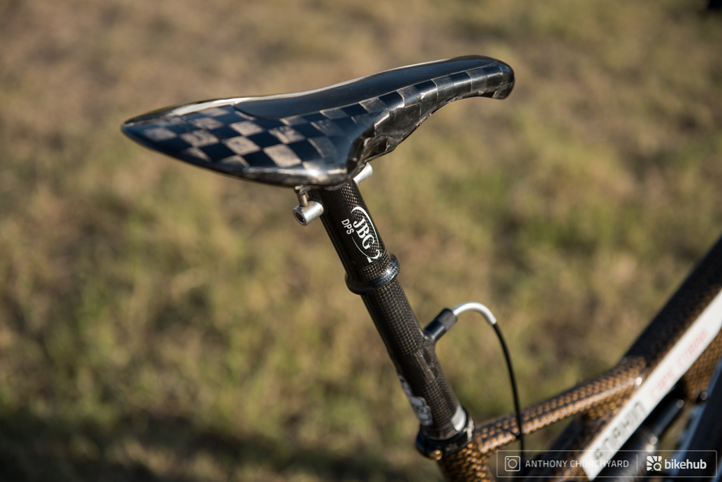

The FRM Vader saddle uses a carbon monocoque shell with a strip of rubber placed down its length for some cushioning. The saddle is said to weigh 80 grams. Then there is the seat post on which the Vader sits. It is a carbon adjustable seat post (simply labeled JBG 2) with 60 mm of vertical travel. Mirko explained that it weighs a mere 220 grams.
