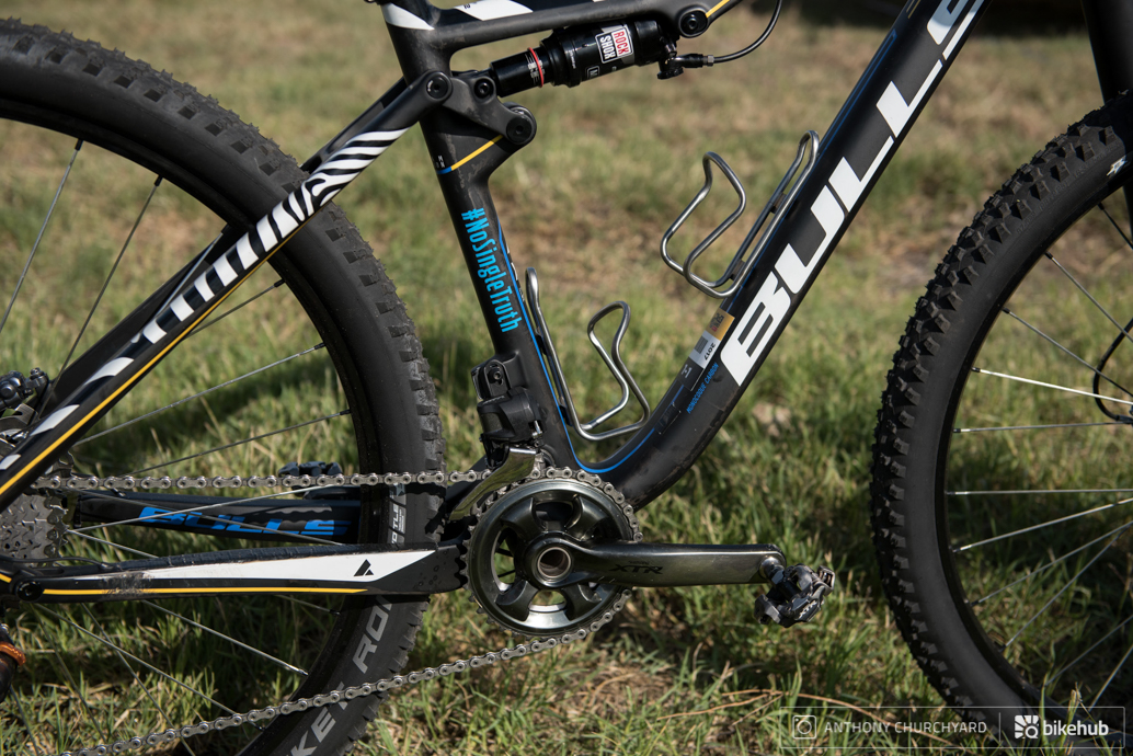

The team are riding the new 2017 edition of the Wild Edge 29 which sees slight changes to top tube and chainstay lengths and the addition of a second bottle cage mount within the front triangle. In the case of Karl, a pair of titanium bottle cages from King Cage fill this new found space. To add to the longevity of the frame, the new Wild Edge Team can accommodate modern metric shocks as well as imperial sized shocks using a flip chip in the top tube mount.
Despite the best efforts of their direct competition, Shimano (and Team Bulls) are firm believers that the front derailleur and double chainring drivetrain still have a place in mountain biking, as indicated by the #NoSingleTruth sticker on the downtube above. Karl has a full XTR Di2 drive system in place with 36-26 chainring sizes and 11-40 11-speed cassette. This is a slight change from last year where Karl favoured a mechanical front derailleur over the electronic version. Karl keeps track of his power by way of a Stages left crank arm power meter.

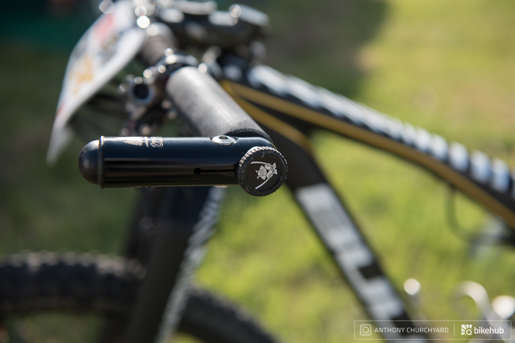

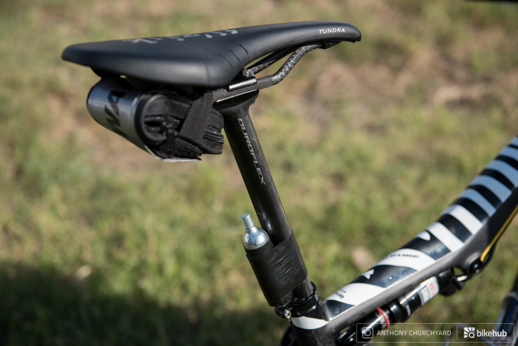

A new addition to Wild Edge Team is the Duroflex carbon seat post with its flattened shape which makes it more compliant and comfortable. A Fizik Tundra saddle sits atop the Duroflex seat post with the handlebar and stem combo from FSA’s SLK range. ESI Chunky grips, Tune bar ends, and FSA road bike tape placed inside the controls gives Karl multiple options to change his position on the bike. Karl uses a Sigma ROX 11.0 bike computer to display his vital stats.
The Sahmurai Sword plug system has become a must have piece of kit at Cape Epic and, of course, with former BULLS rider Stefan Sahm having designed the device, there is little wonder to see it fitted to Karl’s bike.

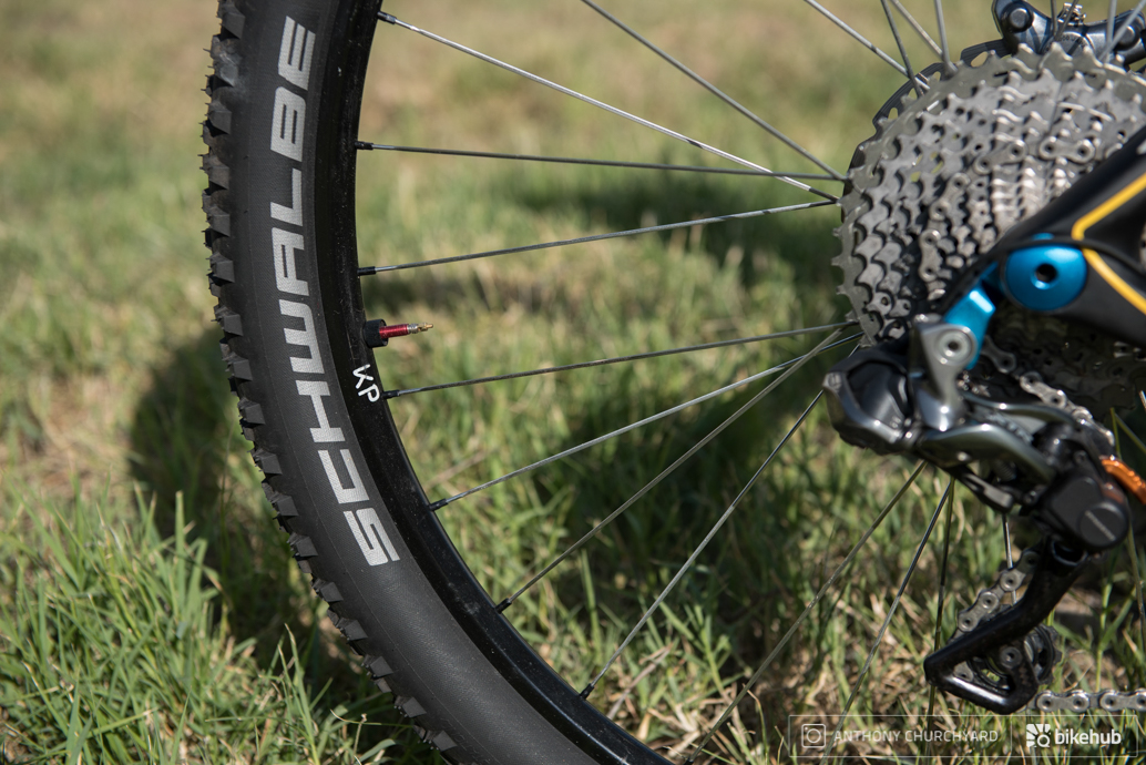

The wheels are a set of Stan’s NoTubes ZTR Crest rims laced to a front SRAM Predictive Steering hub (for compatibility with the RS-1 fork) and Shimano XTR rear hub. Karl’s tyres of choice are Schwalbe Rocket Rons.
