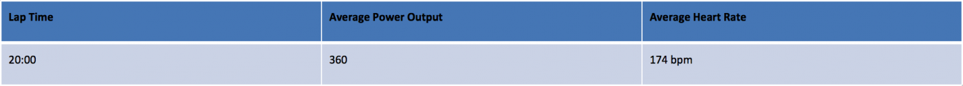

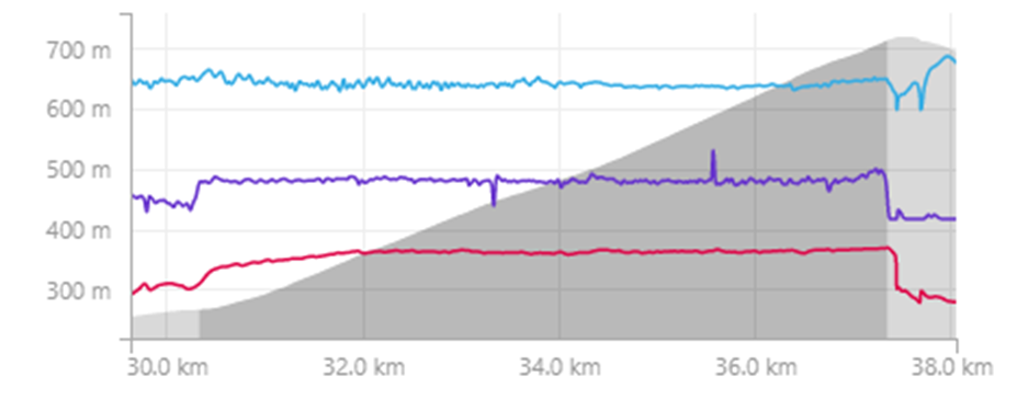

Field tests can take numerous forms, but the most commonly used field tests are hill climbs, time-trial (TT) efforts of varying duration or distance, and standardised training sessions. The 20 minute time trial is commonly used to determine a cyclist’s functional threshold power (FTP). There is a strong association between the average power output during a 20 minute TT and a cyclist’s threshold. If you are interested in reading more about this link, we recommend you read this article. Performing a TT effort requires a quiet stretch of road, or a track that will ensure that your effort is not interrupted. The effort in the figure below was performed on Franschhoek Pass by a young road cyclist. Following a sufficient warm up, the cyclist hit the lap button and held a relatively constant power output until the timer reached 20 minutes.
Figure 1: 20-minute time-trial effort up Franschhoek Pass Cadence (Blue), Power output (Purple), Heart rate (Red).

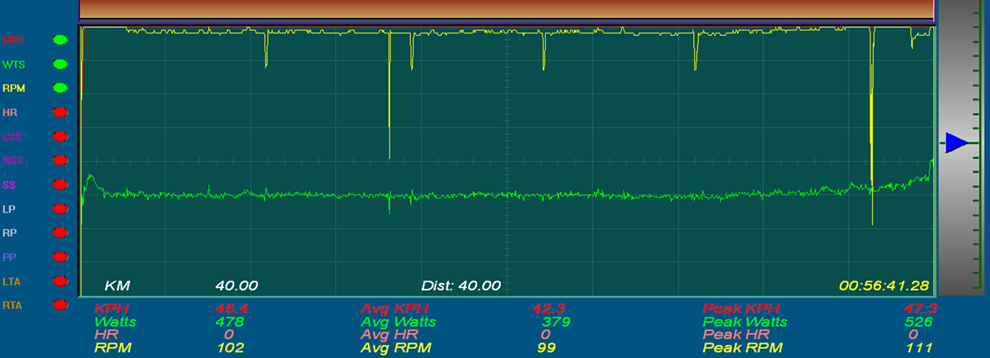

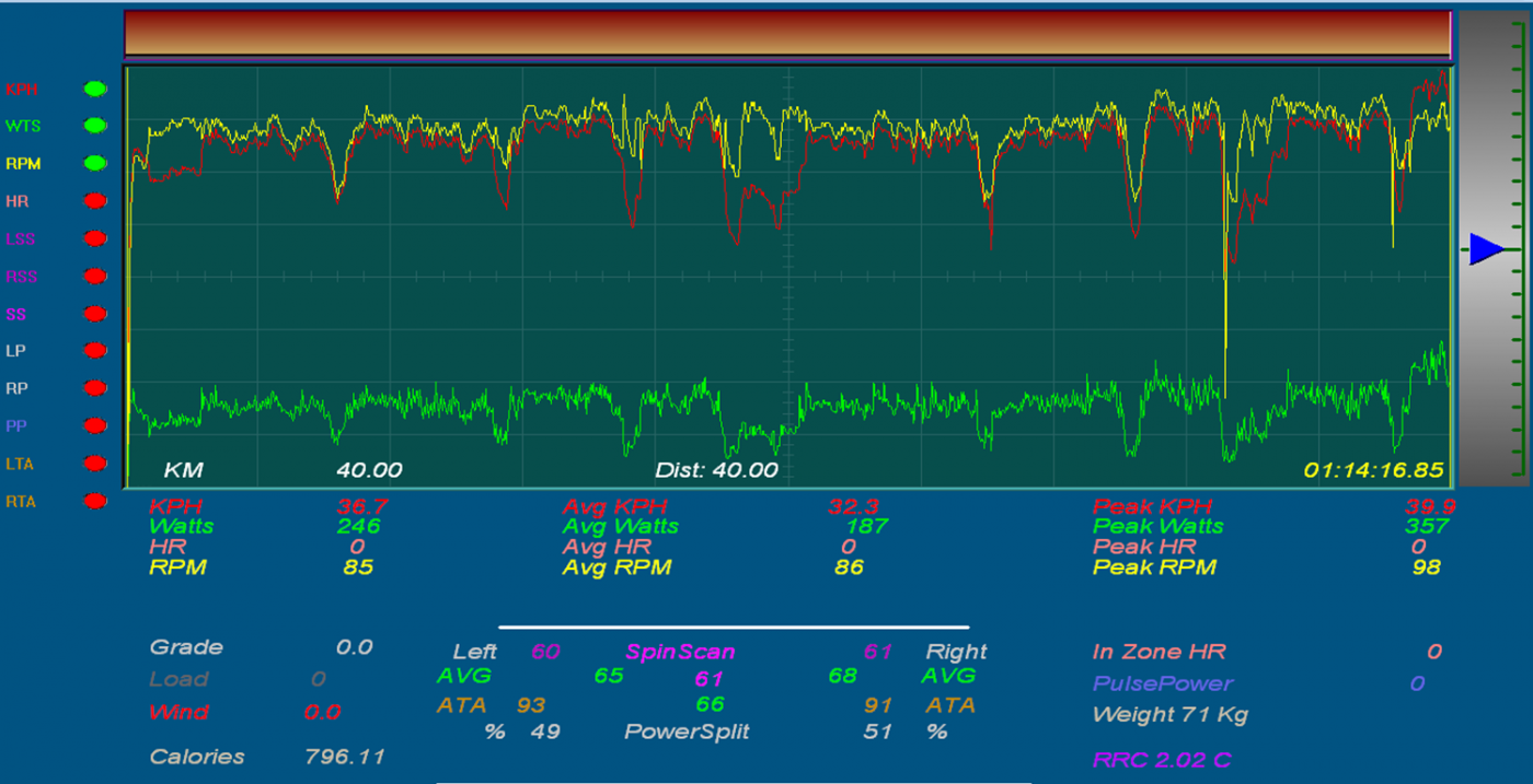

Pacing during these longer TT efforts is an important consideration and can have a large effect on the result of the test. The importance of pacing is probably best illustrated in the two figures below. Figure 2 shows a well-executed time-trial with a relatively constant power output (green line), compared to Figure 3 where the power output is highly variable. Cyclists should be familiarised with these type of efforts in order to assist them in improving their pacing strategy and ultimately performance.
Figure 2: A well-executed time-trial.
Figure 3: A poorly executed time-trial.

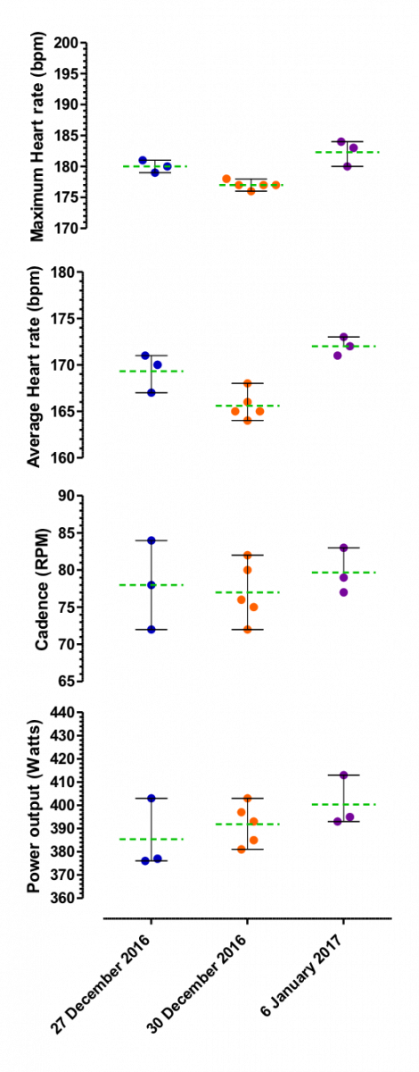

Field tests can also be disguised as standardised training sessions, such as a set of 3 x 10 minute intervals. An increase in average power during these intervals could be valid measures of improvements in cycling performance. These field tests can track changes in performance and supplement the laboratory data which is collected less often. The data in the set of graphs below was collected during a training block aimed at improving this cyclist’s sustainable power output, and each session involved a set of 10 minute intervals. Each date represents a single training session, each dot represents a single interval and the green dashed-line represents the average for that particular session. The cyclist was able to increase their 10 minute power output (session average) as they progressed through this training block. A simple training session that is repeated at regular intervals during a training block can serve the role of a field test and provide an indication of the cyclist’s training progression. Tracking the variables of cadence and heart rate provides further insight into how the session was executed and the fatigue levels of the cyclist.
Figure 4: Data from a standardised training session that can be used as a field test to track progression.
